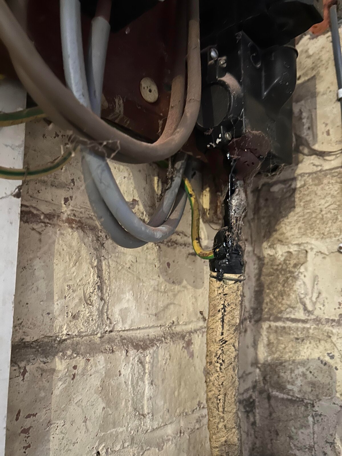

Earth soldered to incoming supply
Just wondering if that leaking tar/pitch would compromise the connection to earth.
Google AI tells me this is a wiped earth joint onto the lead sheath of the paper insulated lead covered cable, so maybe not as bad as i thought it potentially was.
That's what mine looks like. IHNI what the cable is, but the earth connection is definitely a lead wiped thing, not solder, and not a clamp.
