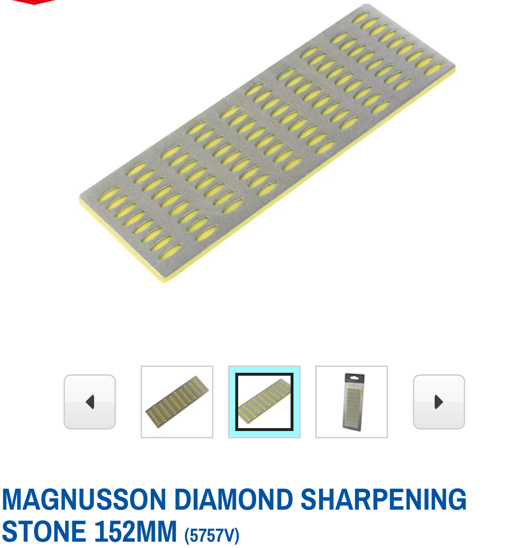

I use a knife sharpening stone to put a tiny chamfer on the cut edge, minimises the look of any chips, works really well
