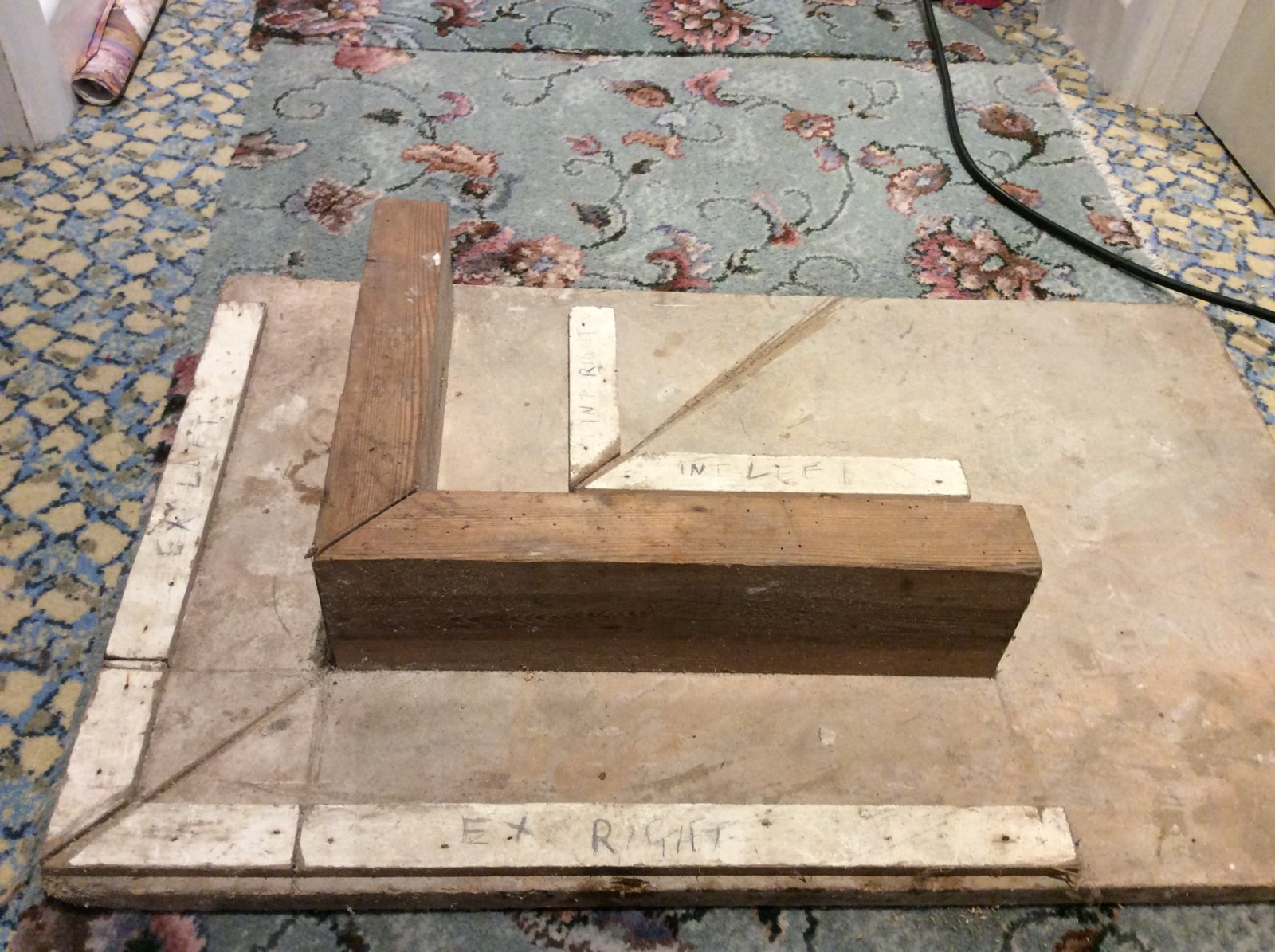

I often use my Nobex Champion mitre saw to cut coving. The saw allows the blade to be locked at any angle, usefull when corners are not a true 90 degrees. In the homes where I watched the guys fitting the massive plaster cornices, they use custom made mitre boxes.
Build your own mitre box to suit the size of coving, easy to do , plenty of YouTube videos on how to do it.

I made this one in the early 1980’s and still in use from time to time:)
