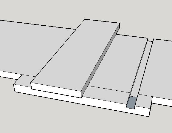

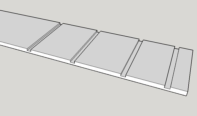

You don't need to buy a Felder! Simplest approach to make a housing (dado is an American term o_O) is probably a 1/2in router and a home-made T-square, especially if the timber matches the diameter of a particular cutter (cutters are available from 2mm to 22mm or more in 1mm increments):
Above: This is where you want to cut a housing

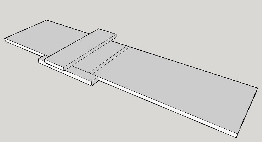

Below: A simple jig to guide the router can be made using a piece of 18mm plywood or MDF and a piece of 2 x 1in PAR softwood as the fence.

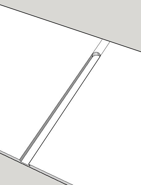

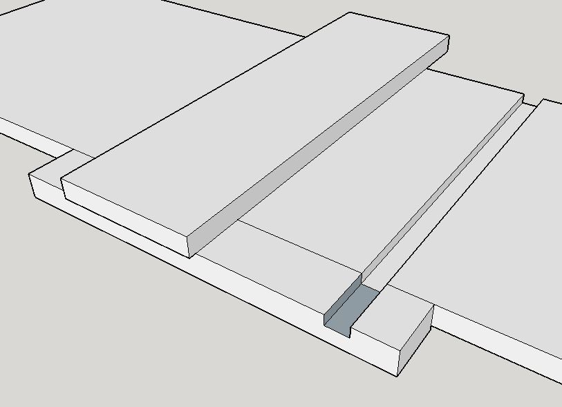

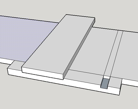

In this instance the material would be clamped onto the bench and overhang it slightly to accommodate the extra thickness of the fence (22mm softwood onto 18mm MDF). The material is clamped onto the bench and the jig is clamped or screwed onto the material (if it is MDF the holes can be filled and sanded later). The base of the router runs against the T-square "blade" and the housing is ideally worked in multiple passes increasing the depth each time. The fence will end up with a notch cut-out by the router cutter:
This notch can subsequently be used to align the fence to where the grooves are required:

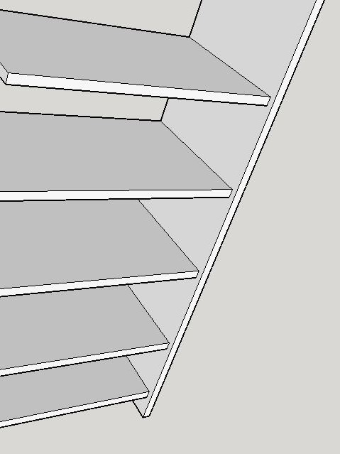

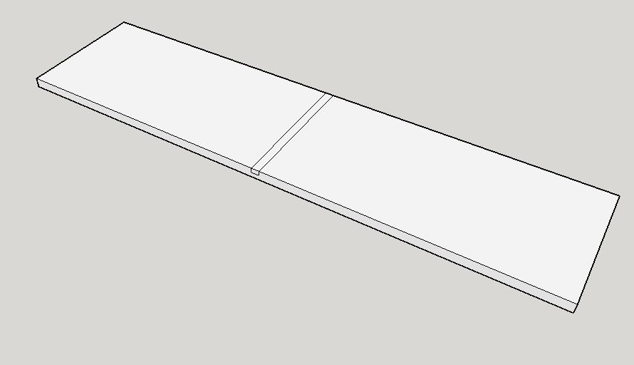

A plus of using a router and a jig is that with appropriate stops (or pencil mare and careful routing) stopped housings can be cut (all but impossible to achieve with a table saw)
This is one way you achieve that set-back shelf look which is seen in much professionally-made furniture and is far more stylish IMHO

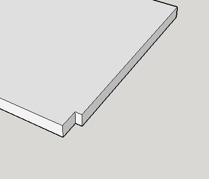

To fit that way the front corners of the shelves are notched (jigsaw and chisel) and the shelves are slid in from the rear.

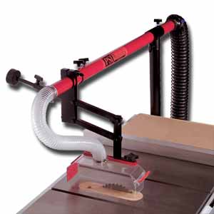

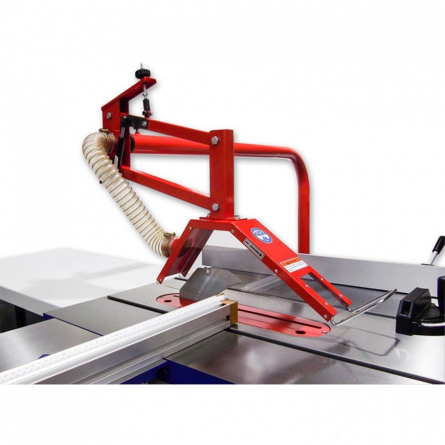

How can you use a dado set with your crown guard and riving knife if place?
You can't. The riving knife needs to be removed (in any case it won't do anything for trenching bcause you are not parting the timbers, only grooving them so the pinch "phenomenon" isn't applicable) and the guard (crown or otherwise) needs to be supported either directly off the rip fence or from an overhead arm, like this one (Google home-made crown guards):
or this commercially available one:
Even Axminster do an after market kit:
