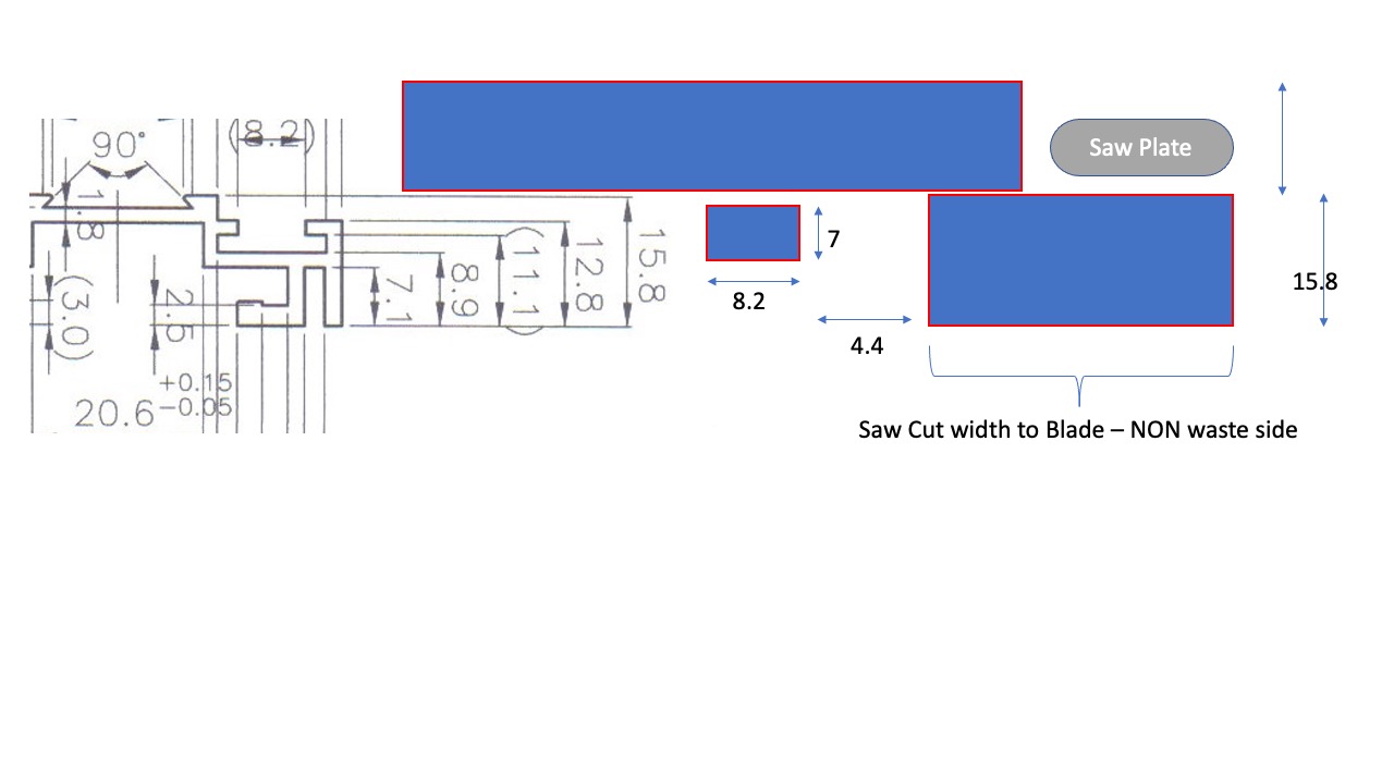

I expecting a trend straight edge (100")
https://www.trend-uk.com/vjs-g-100-varijig-system-straight-guide-2-54-metre
to arrive tomorrow (Friday 8th Oct) , and their Saw guide & Router Guide are £30 each , and it looks like something I could very easily quite a few youtube videos for Slid on Tracksaw guide rails (Peter Millard)
Anyway
I have some old threshold hardwood scrap and planned to use that using my son-in-laws table saw to cut to size
so a piece of timber will drop into the T slot on the Straightedge and run the length.
Would you use some sort of lubricant , soap ? or will the hardwood just run in the T-Slot OK
I had hoped T-slots were some sort of industrial standard size but seems everyone makes there own size!!! and hence can charge silly money for any acessories to use the T-Slot
I have the Tech Drawing from trend - and their solt is 7mm deep , 8.2mm wide and then the T is 2.2mm high, need to work out its width - but i guess around 10mm

But I do know there is a decent range of rectangular and square M4 flat nuts that may fit in the t-slot.
Is it possible to post the drawing and we could help confirm the sizes?

The dimensions are here , but they need to be calculated to get the T-Solt
I have a small jpg i made up for the wood jig

Thanks , I looked at those yesterday for some stops - did not think to use those as the Slide
I assume they should slide the length of the 2.5m OK, Its mainly to be used when cutting down 8x4 sheets - and i really cannot justify the cost of a track saw.
It could be worth a go for a couple of pounds, and like you said, they can probably be used for stops if it doesn't work.
Some chamfering of the edges may help them slide.
It still might be worth asking the suppliers if they have a full set of dimensions though :)
Thanks , i have the exact size now - based on the drawing, so i will wait till i get the straight edge in my hands and then i can use a venier to check
The slot is 13.1mm wide - so they show as 10mm so maybe a little bit sloppy in there
