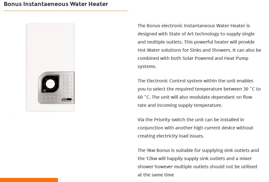

From one of the first hits I got when I Googled "electric instant water heater". There are countless similar ....

No? I think a goof few instant water heaters are more like combi boilers than you seem to think.
What do you mean by 'the max'? If you turned on just slightly a tap connected to an instant heater, would you expect the water to boil, or what?

It's not so much what I had in mind, as what you had in mind, or what the maker has in mind when he says "shower". He might mean a manual mixer and you might be assuming he must mean a thermostatic one.
What type of showers can be supplied? - Redring only recommend their shower mixer kit but some client's have had varied success with other manual mixer showers (thermostatic mixers are definitely out).

The unit MUST NOT be fitted to any type of THERMOSTATIC mixer valve or tap. .... If the Powerstream-Eco is connected to a mixer tap then only NON-Thermostatic types should be used (water mixes at the outlet pipe only).
Hyco used to say "Do not fit a thermostatic mixing valve with the inline. Unpredictable performance will result" but I can't find that now.​
Maybe other makers of instant heaters have done theirs differently and thermostatic mixers can be used.
Maybe, as oldbutnotdead says, things change, and what was not available a few years ago is now.
Maybe the maker of the instant heater someone chooses should be explicitly asked to specify what type(s) of shower mixer can be used.
And maybe the OP should wonder if all this bother is worth it to get a heater which is only 2% more powerful than an electric shower...
I can but presume that these statements must all relate to the types of instant water heater (like 'over-sink' ones) which have to have an 'open' outlet and therefore cannot safely be connected to a tap. If they are suitable for feeding a tap (which I think most/all other than 'over-sink' ones must be), then they surely must be equally usable with any type of shower mixer (including a thermostatic one) - since 'control' of hot flow by a thermostatic mixer valve is no different (from the point-of-view of the heater) from manually turning a hot tap.
Kind Regards, John
No they relate to ones which are not like that. You could try following the links instead of presuming.
And no - they are not necessarily suitable for use with any sort of mixer, for the reason I outlined earlier. If the mixer reduces the flow of hot water in order to lower the temperature of the output, the hot water temperature will increase, requiring the flow to be reduced some more. Which makes the temperature rise even more. Which requires the flow to be reduced even more.
It's not hard to see where that leads....
