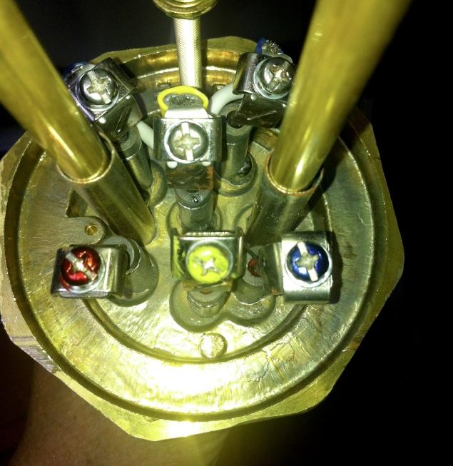

Hi,
I'm trying to source suitable contractors for a pair of fairly chunky immersion heaters (IH) for my thermal store (TS). Initially I wanted one 6kW and another 9kW IH - these were supplied with the TS. The 9kW IH has 3 separately wirable elements for a 3 phase/415V supply but (according to the manufacturer) can be wired with all 3 elements in parallel to work with 240VAC single phase.
I want to time these 2 IHs to come on only during Eco7 hours and as their thermostats are rated at 16A I intend to control the 2 IHs with a suitably rated contactor and timer all in a DIN rail box - the TS is about 4m away from the main consumer unit.
As it turns out I cannot find a suitable source of the 2m of 10mm 180 deg heat tolerant flex I need to connect to the 9kW element (I am in a bit of a rush) so I am going to use just the 2 elements in parallel to end up with 2 x 6kW IHs. I am going to use 2 runs of 10mm cable from consumer unit to the TS DIN rail box each with its own MCB (one at 45A, the other at 30A) and use similarly rated contactors so that eventually (if indeed required) I can use the 9kW IH at its full capacity. I can obtain 6mm 180 deg heat tolerant flex suitable for the 2 x 6kW IH connections from contactor to element head.
The thermostat/timer/contactor coil signalling cable will also be 180 deg (silicone) flex at 1.5mm.
So, questions:- 1/ Can anyone see any issue with this setup and 2/ can someone please explain the rating info on contactors so I can try to source suitable contactors more cheaply than my electrician can?
My main issue is that the more common (and therefore cheaper) ones are multi-pole - usually 3 pole. If they are rated say at 11kW, is this per pole or for the 3 phases all working together? If the latter then I guess each pole will have a much lower power limit than 11kW? I gather my 6kW IH needs 6k / 240 = 25A (say 30A) rated contacts and the 9kW, 38A (say 45A) ones. Can I connect the poles together in parallel to get an 11kW 3pole/phase contactor to work with 11kW 1 phase load?
Thanks in advance, MW.

Adam_151, Thanks for taking the time to reply.
This is a pic of the head of the IH...
As you can see, all the L's & N's are separate (although the N's are all linked together currently).
I have an 80A main fuse and although I am getting a bit high in my amps with both IH's running, they are designed for a worst case scenario and only on between 0000 and 0700.

OK, couldn't wait for a reply so asked Chint (lots of their stuff on eBay)...
The power (or currant) rating specified is per pole so for example the CHINT NC-0901 (9A 4kW on ebay for under £10) can take 9A on each of its 3 poles. Further, Chint say that if you parallel three poles up for use with a single phase supply you can double the rating (but not triple). So on a single phase the example contactor could take 18A or 8kW across the 3 poles. MW
You need to be carefull about the effect of breaking the current when the contactor opens.
The 3 contacts do not all open at exactly the same milli-second which means the last to open will be breaking the whole 18 amps which is twice its rated current.
The life time of a contactor wired with two 9 amp contact in parallel can be considerably shorter than one with a single contact rated at 18 amps and therefor also capable of breaking 18 amps.
Also, although the items may be rated sufficent, it definitly doesnt pay to buy cheap brands like chint for loads like this. Go for something like schneider electric, may cost more, but will almost certainly last longer and less likely for heat build up, and fire..
:idea: instead of trying to combine the cable into 1, keep the three supplies separate from the contactor onwards then it doesn't matter if the contacts don't break simultaneously.

My thoughts reading this would be to split the elements, use the three poles of the contactor (one per element), and feed them with three separate breakers rather than one large one.
That way :
If an element fails you can switch off it's supply and leave the others working
The overcurrent protection is more closely sized to the individual loads.
I'm thinking that if you paralleled up the elements, then potentially you could be pulling about 38A between them - so would need at least a 45A breaker. If one element fails short-circuit to earth at it's (say) mid point, then it would take twice it's normal current and you'd be up to about 50A total with 25A going into the faulty element. A 45A MCB will go a considerable time without tripping at 50A, and a fuse will go indefinitely without blowing. So you could have certain types of fault which wouldn't trip your protection but which would cause a hazardous situation.
Using three separate breakers, you'd probably use 16A MCBs and the individual breaker would trip when loaded to 25A - leaving the other two elements working.
That does leave the potential for a breaker to trip and you not notice a 33% reduction in heating capacity.
One last thought, if you use contactors for both IHs, and you want to avoid the possibility of running both at once (60 to 65A is getting rather close to your main fuse rating) then you can easily wire the coil for one contactor (probably the day one) through the NC contact on the other (night) one. So when the night IH switches on, the day one will switch off (if it was on).
There are also mechanical interlocks, but that's probably overkill for your application.
