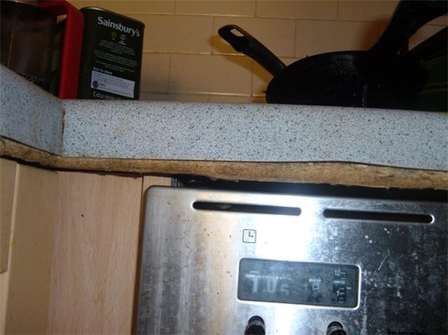

How long would it take a the compressed chipboard in a standard (say B&Q) laminate worktop to swell up when water is poured on it if the laminate was damaged? I've added a photo af the affected worktop [/img]
I know its fooked but how long did it take water to make it that fooked? Note it's above an oven so probably the laminate has been separated from the chipboard
ok enlighten us into your inner thinking
the answer you will get can only be an educated guess as thats an unusual pattern off dammage
we need to see the proximity of other sources of heat and damp like sinks tumble dryers and dish washers the dishwasher being the machine most likley to give that sort off dammage without burn marks

A friend of mine was asked to pay for a new kitchen because of the damage you see. The tenant below his flat says there was water dripping onto the worktop for around an hour. I don't see it swelling that much in an hour but thought I'd ask you guys for your opinion.

Looks worse than I would've thought for just an hour of dripping. Likely the worktop has seen better days anyway, looks pretty old. The bloke might be trying it on, but if there definitely was a leak then your pal hasn't a leg to stand on.
I would dismiss his claim, the oven is not fitted correctly , the underside should be sealed over an oven to prevent the steam from such opening up the laminate as has happened.A hours dripping would cause very localised minor damage , that looks like years of neglect/abuse.

the return seems to have expanded nearly as much as the worktop with the oven,that seems to be an awful amount of damage for an hours leak.
