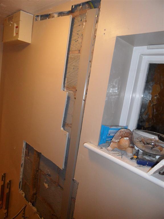

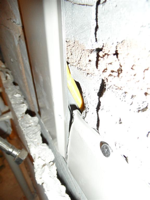

Looks like my parade is well and truly p***ed on, they are coming back tomorrow to put another piece of capping over the area where you can still see and touch the earth wire at the angle of the 'L' shaped run.
So in summary I have to say that it doesn't comply with current 17 regs because of routing, no earthing on capping and no rcd? Which way should it be routed accoridng to 17th edition and is there anything else to add?

Let's have a closer look at the top, horizontal bit. Can you send a photo? I'm not trying to worry you, honest.
That does look like it's plastic. Whether it's metal or plastic, it offers no protection to those cables, and it's all too easy to sink a drill that far down if you're expecting a concrete block behind the board.

So when they come to cap that bare area on the angle of the 'L' in the morning, should I not allow them to do any more capping or say what's been said here? I really don't want legal battles as I just want my toilet back in action again!
I think you should certainly allow them to finish their work, yet question what could happen if someone determined enough drilled through this unearthed metal capping. Though I cannot say if the capping must be earthed, I would certainly think it would be an improvement, and very easy to do at this stage. Each piece would need to be earthed.
But the question is, is this still going to be safe enough? It's certainly an improvement on before, and the damaged cable has been replaced. You know where the cables are, you have pictures, but no one else knows, and nobody has any way of tracing where they run.

I take it where the three horizontal bits of capping at the bottom are cover diagonal cables?
I can see the little bit of earth cable towards the bottom which they evidently couldn't fit in that big capping.
Are they putting capping over the cables at the top of the wall as well?
No not at the top as they said that it was within so many mm of the ceiling which is allowed under 17th ed regs. The height from where the capping starts to the ceiling is 85mm at present.
I'm not sure what's going on with those 3 horizontal cappings as I didn't see that bit going on. One thing I've just noticed is that there is now a force 10 gale blowing through the wall presumably from the back of the meter box which originally had filler foam in it.
They will be referring to the 150 mm 'safe zone' allowed from the ceiling to run horizontal cables. I would have thought it would be good practice to cap this bit as well, while they are at it.
Safe zones are all very well, but you ask a tradesman who is not an electrician where he thinks a safe place to drill is, more often than not he won't have a clue.
