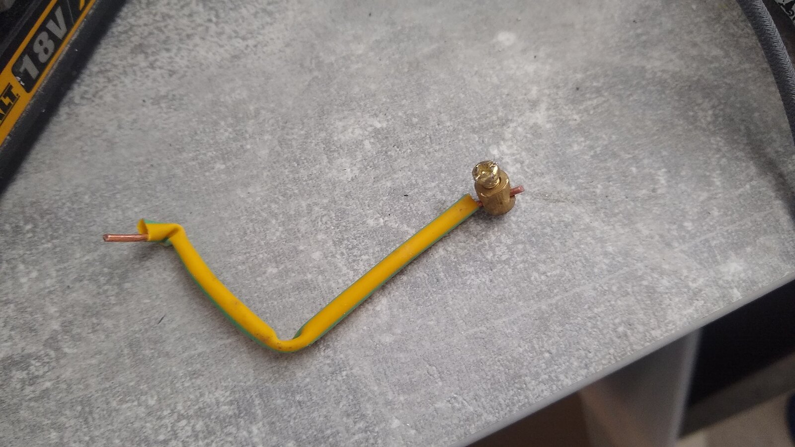

During the wiring of some new sockets, i damaged the earth in my backbox.
The earth connection has completely come apart from the backbox (see pic)
As i have metal sockets, is it imperative for me to earth the socket to the backbox? And if so, what remedial work do i need to do to fix the broken earth connection?
Please note that removing/replacing the entire backbox is not an option

Take the earth conductor directly to the earth terminal of the socket, then a short piece of G/Y wire to link that to the box. Drill a suitable hole in the box and find a self tapper screw and washer to fix the wire via the hole.
Does the metal front plate of the socket have an Earth Terminal that is separate to the Earth terminal for the socket Earth, ?
If it does then these need to be linked together to ensure the metal front plate is securely Earthed in the absence of a secure Earth to the back box.
Also do as Harry has suggested but a self tapping screw should not be relied upon to prove a secure Earth connection.
If your back box has at least one fixed lug (that’s where the front plate is screwed on to the box) Then there is no need to Earth the back box, provided the earth wires from the mains feed are connected to the socket’s earth terminal.
so, if the above is true you can put the wire in the picture in the bin, replace the socket and carry on.
Unfortunately this is what back boxes are like - cheapest sheite possible to make them, the earth lug often breaks off.

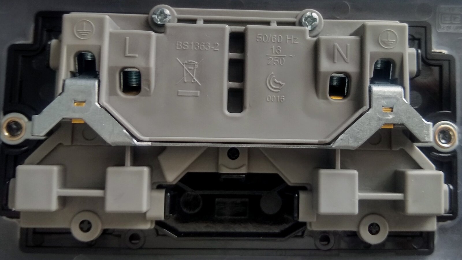

There are two earth terminals on the back of the socket. One on either side of the socket (image attached)
I have a total three earth cables (ring main + spur) coming into the terminals
I have placed two earth cables in one terminal and the remaining cable in the other terminal
Many thanks..
Better to try to squeeze all the cables into one terminal, rather than rely on the socket's linking of one earth terminal to the other.

No one was ever fired for adding the link between socket and box earth terminal.
If due to damage to the cables, the live makes contact with the backing box, I would want to be certain that box has a proper earthing arrangement in place.
