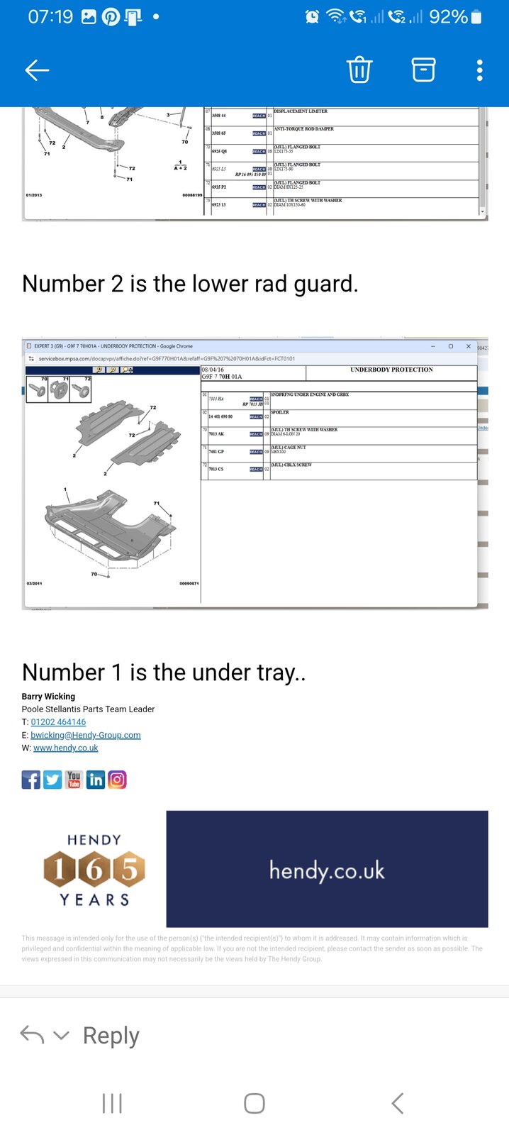

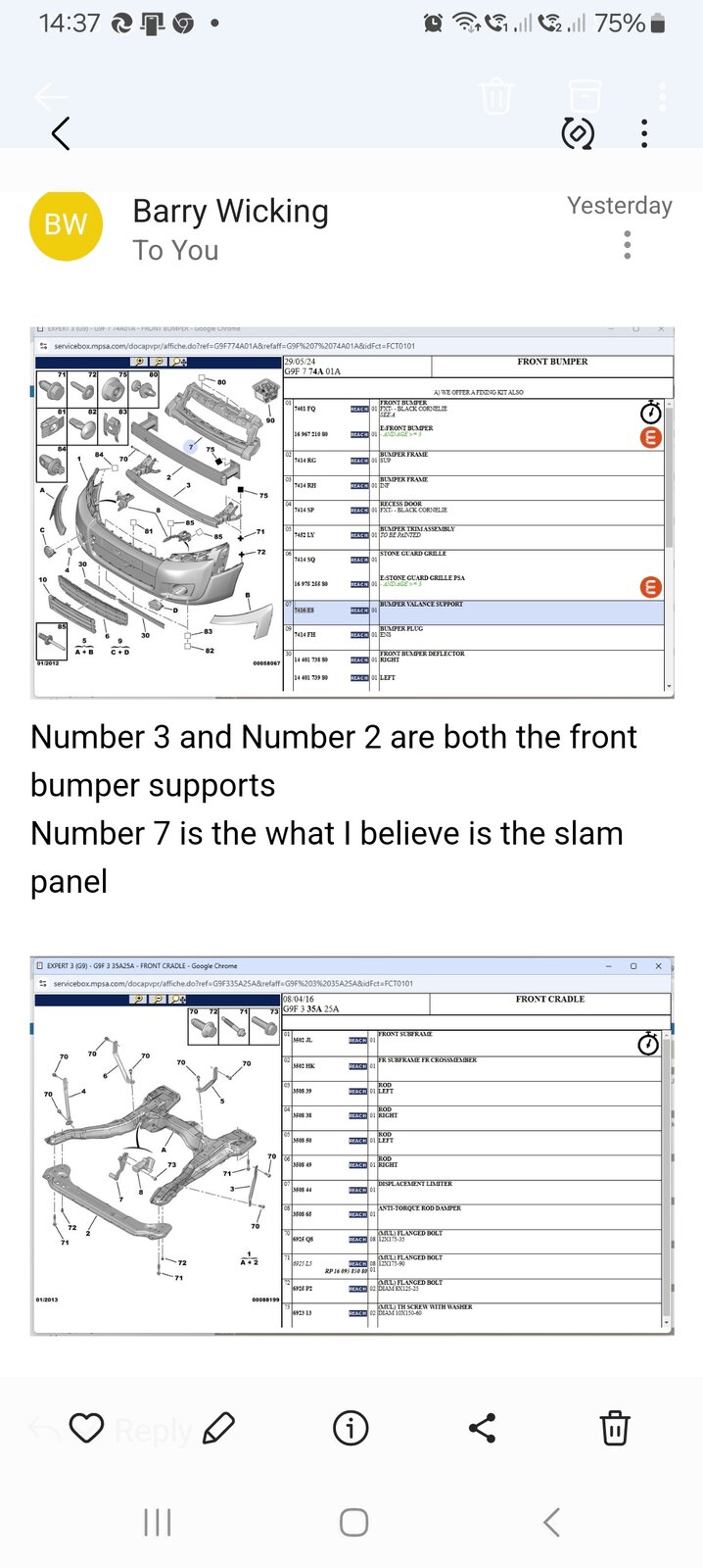

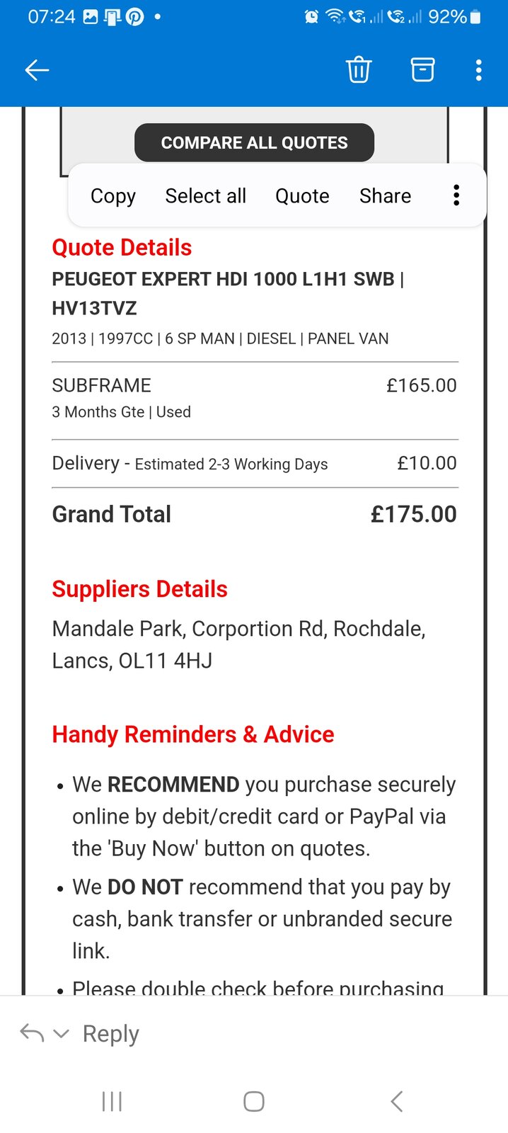

if it is driving around OK and it can get through its MOT - then I would leave as isPeugeot dealer showed me these parts
can I just leave all of it except Slam thing? I mean it's driving around ok (I've purchased that already) or just get the subrframe too.

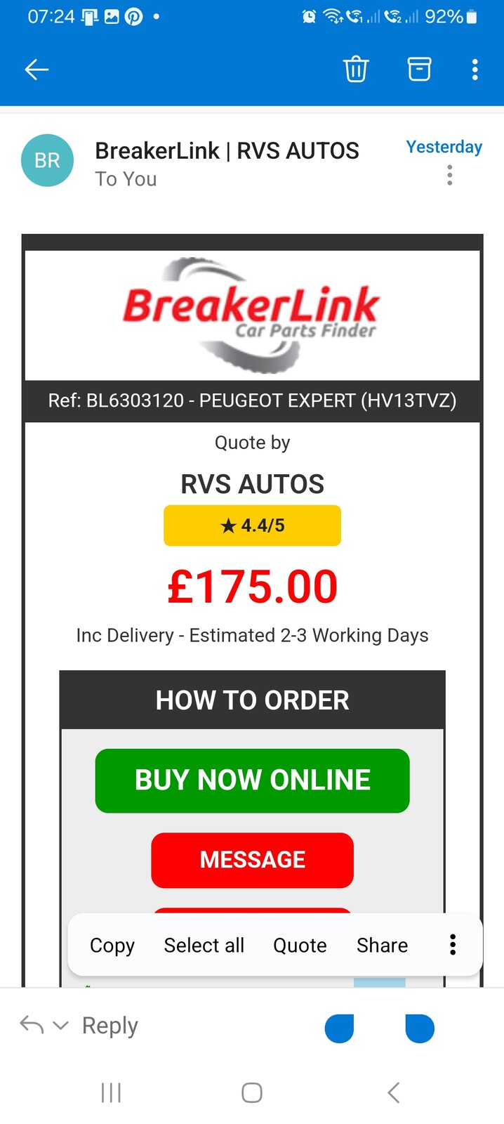

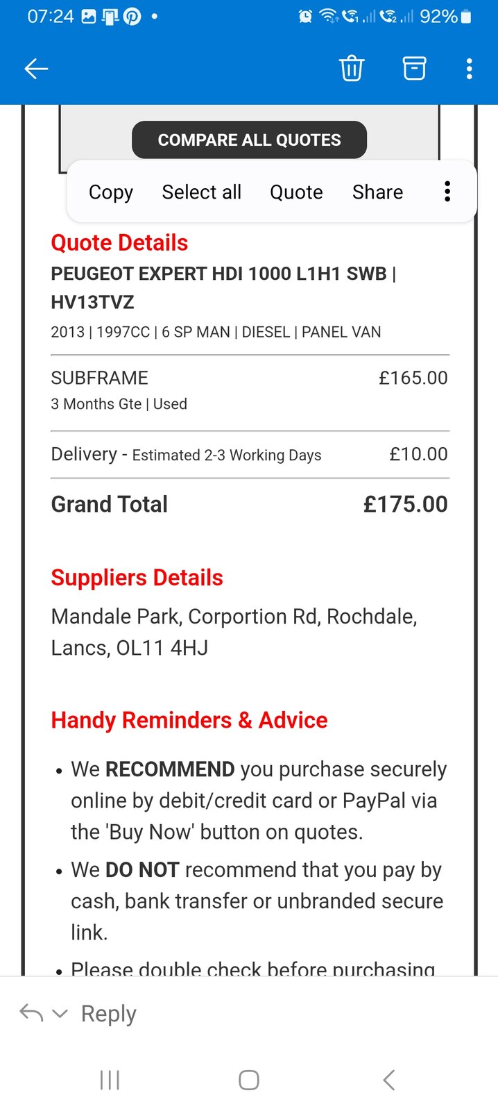

We don't know if the crash bar needs replacing though, do we? I Found this subframe-
View attachment 361333View attachment 361334

Yeah my mechanic said radiator bar or something. I'm really not sure. Maybe pop back and see him with pictures of what I'm thinking of buying to confirm it's right?Is there a picture with that subframe? There are several parts that could be called subframes. Could be the main subframe that parts of the suspension and steering are all bolted to under the engine and box - not what you need.
My much older Scudo in link below has a main subframe and what is termed a 'crossrail' that sits under the rad. Guessing it may be the crossrail you need, or something similar - not main subframe.

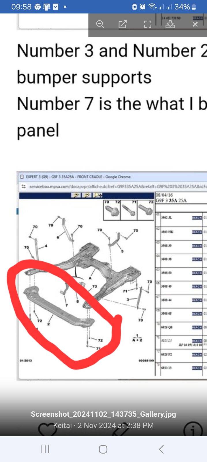

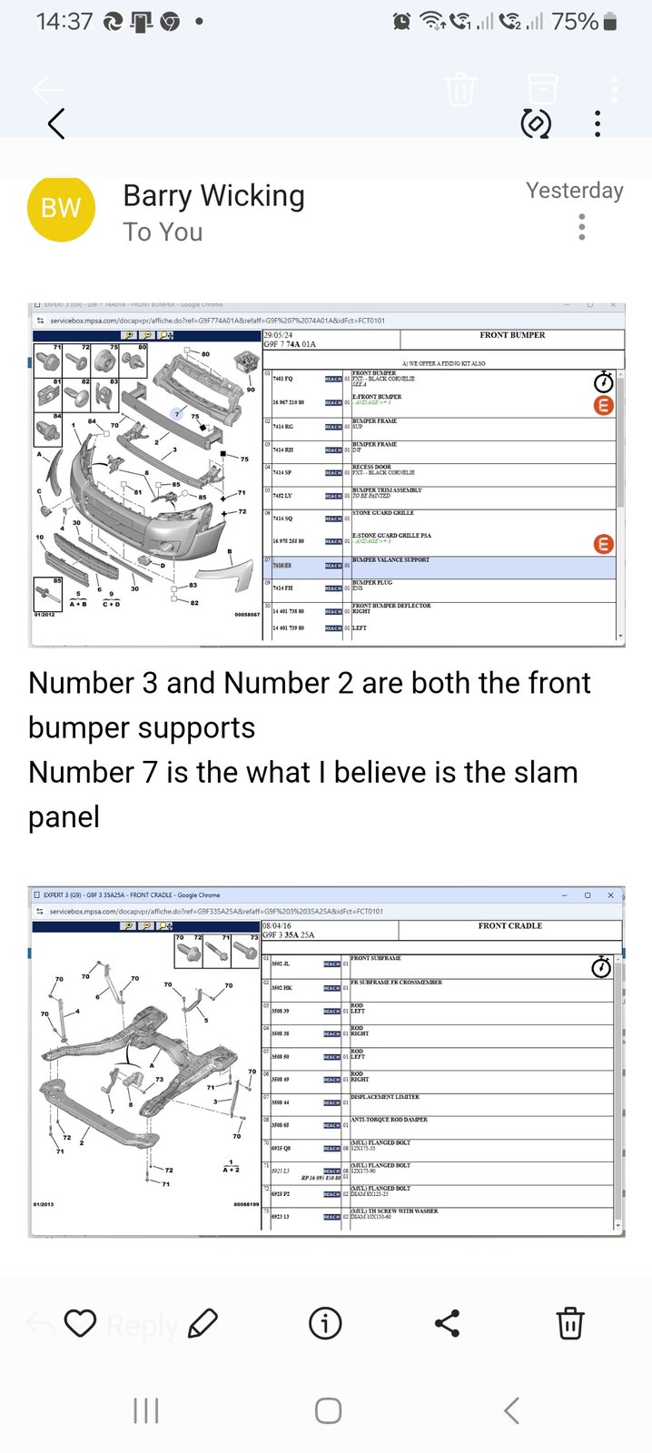

Found this from Peugeot Dealer-Is there a picture with that subframe? There are several parts that could be called subframes. Could be the main subframe that parts of the suspension and steering are all bolted to under the engine and box - not what you need.

Found this from Peugeot Dealer- View attachment 361423
So should be much cheaper to just get part no.2 than whole subframe? If I get it from Peugeot I guess less hassle to return it if wrong. I can go to my mechanic and check with him. This circled-?ìLooks like you need part no. 2 (FR subframe FR crossmember) on the second parts diagram for the part under your rad with the nasty dent in it. Can't make out the others for certain.
