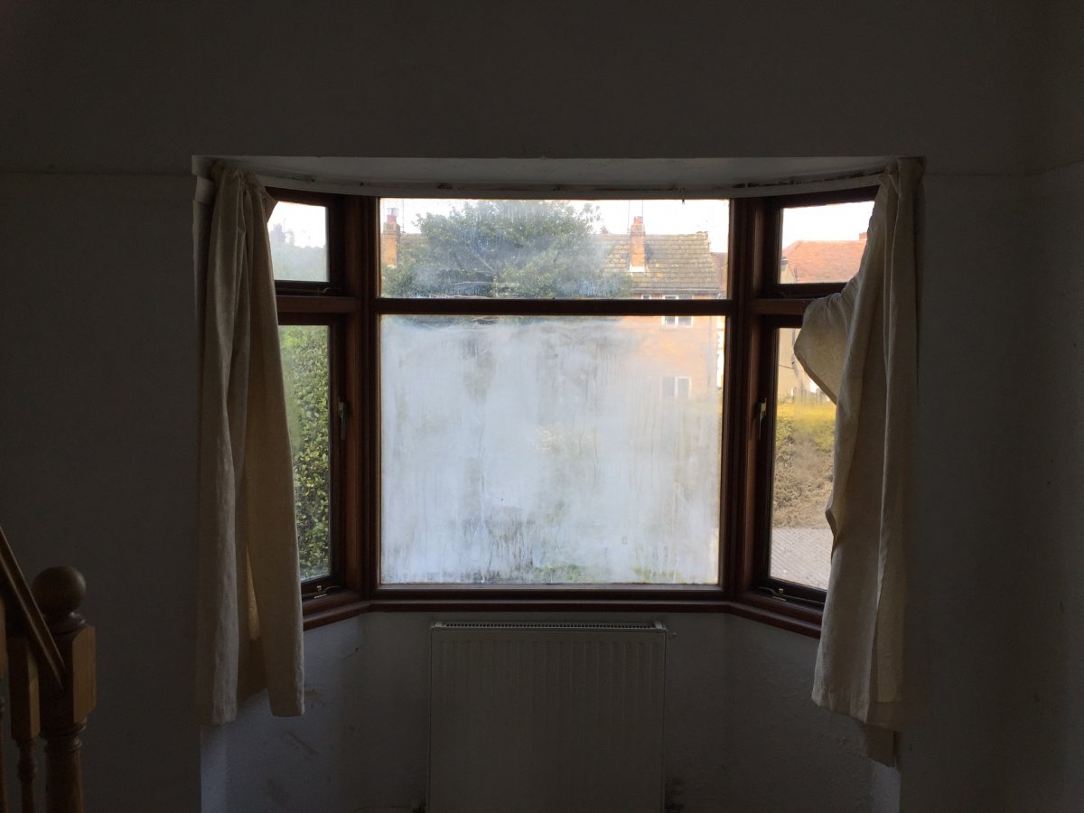

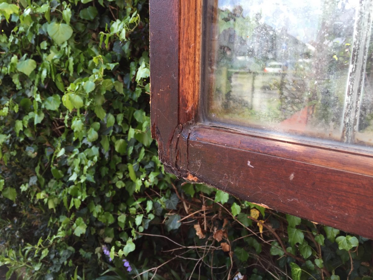

We have just bought a 1930 semi, it has hardwood casement windows fitted with double glazed units. Some of the units are shot I.e fogged up and a couple of the opening windows are rotten from lack of maintenance. Can I just get new units and replacement window parts? And treating the wood to a coat of wood seal. Or am I better looking at double glazed windows?

Here are a couple of pics
