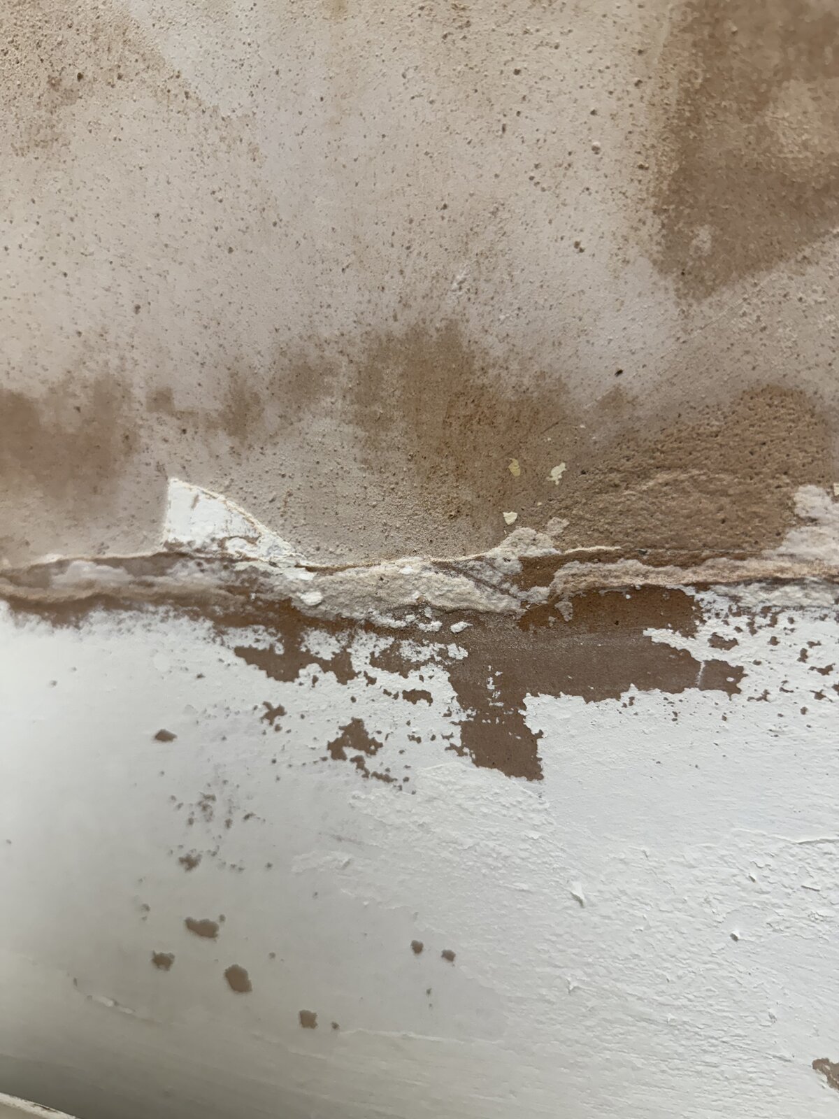

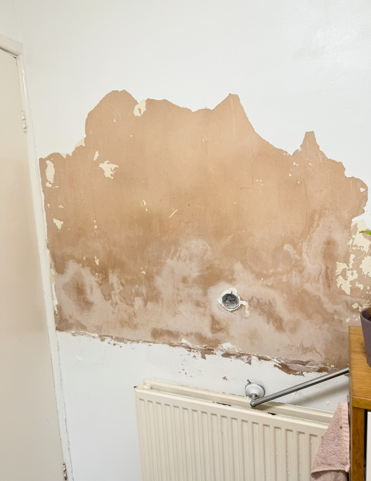

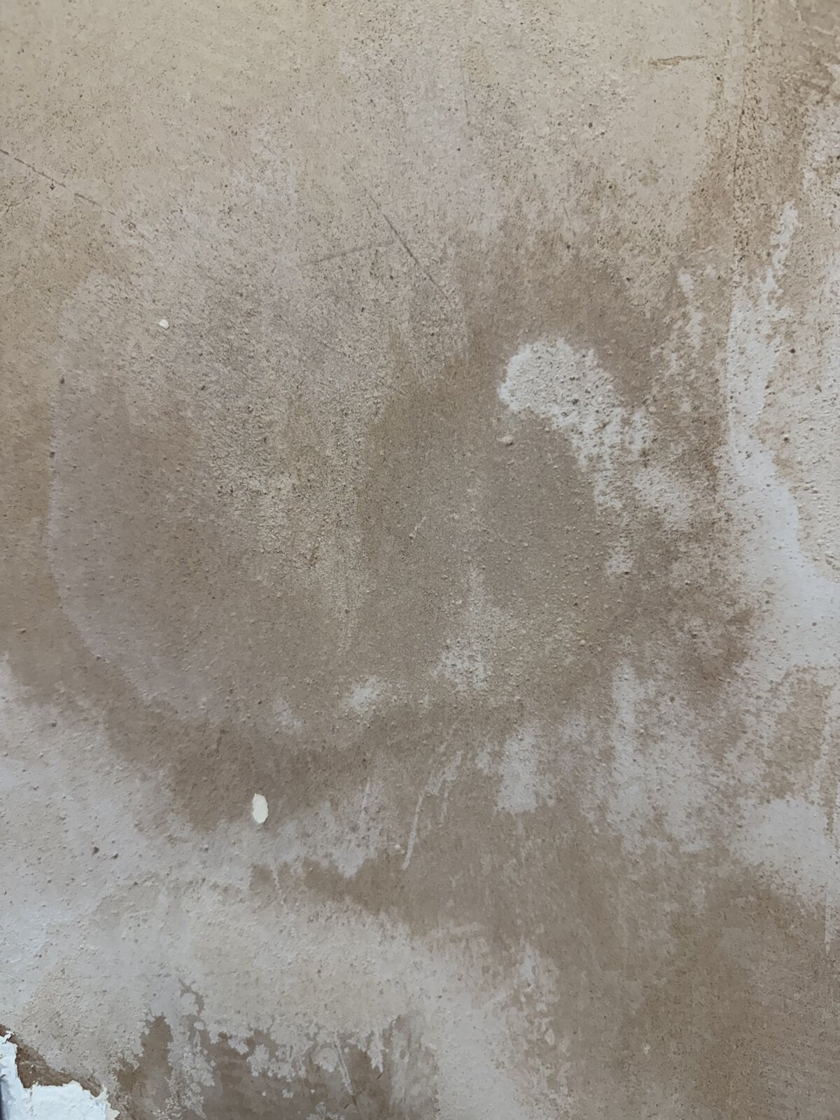

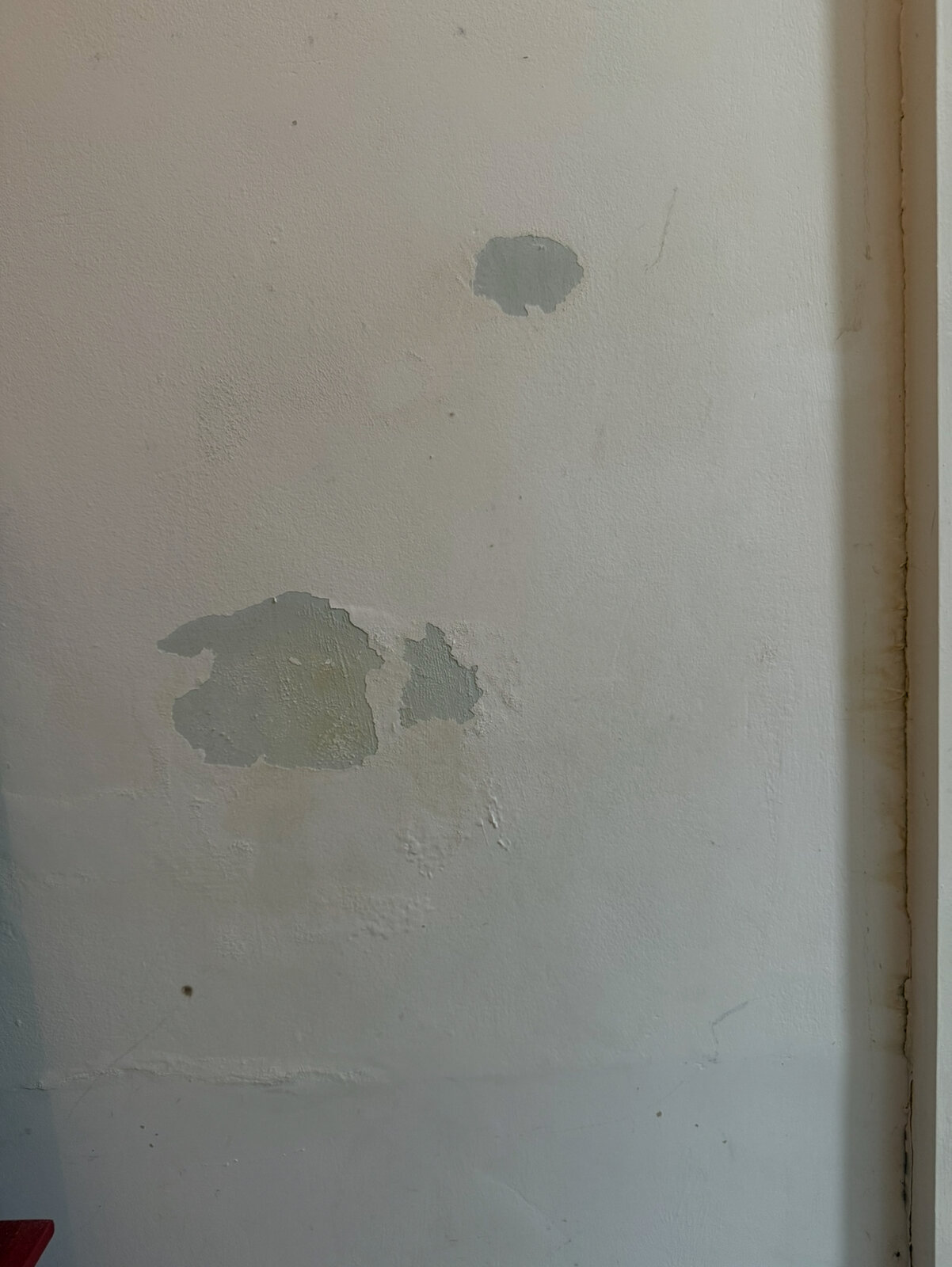

Hi there. I bought my first house solo about 1.5yrs ago, and have no real DIY experience - looking for some guidance on this issue as I’m not even sure what kind of professional to call out. Though, of course I’ve been researching.
House is a Victorian terrace, with a ground floor extension that is much newer - but I am not sure of age. The ground floor extension has a small passage way, with a door to the yard, and a bathroom.
The internal wall of the passageway and bathroom is suffering with efflorescence. This wall backs onto my neighbours property, though they are not like for like extensions so I imagine they were not built at the same time.

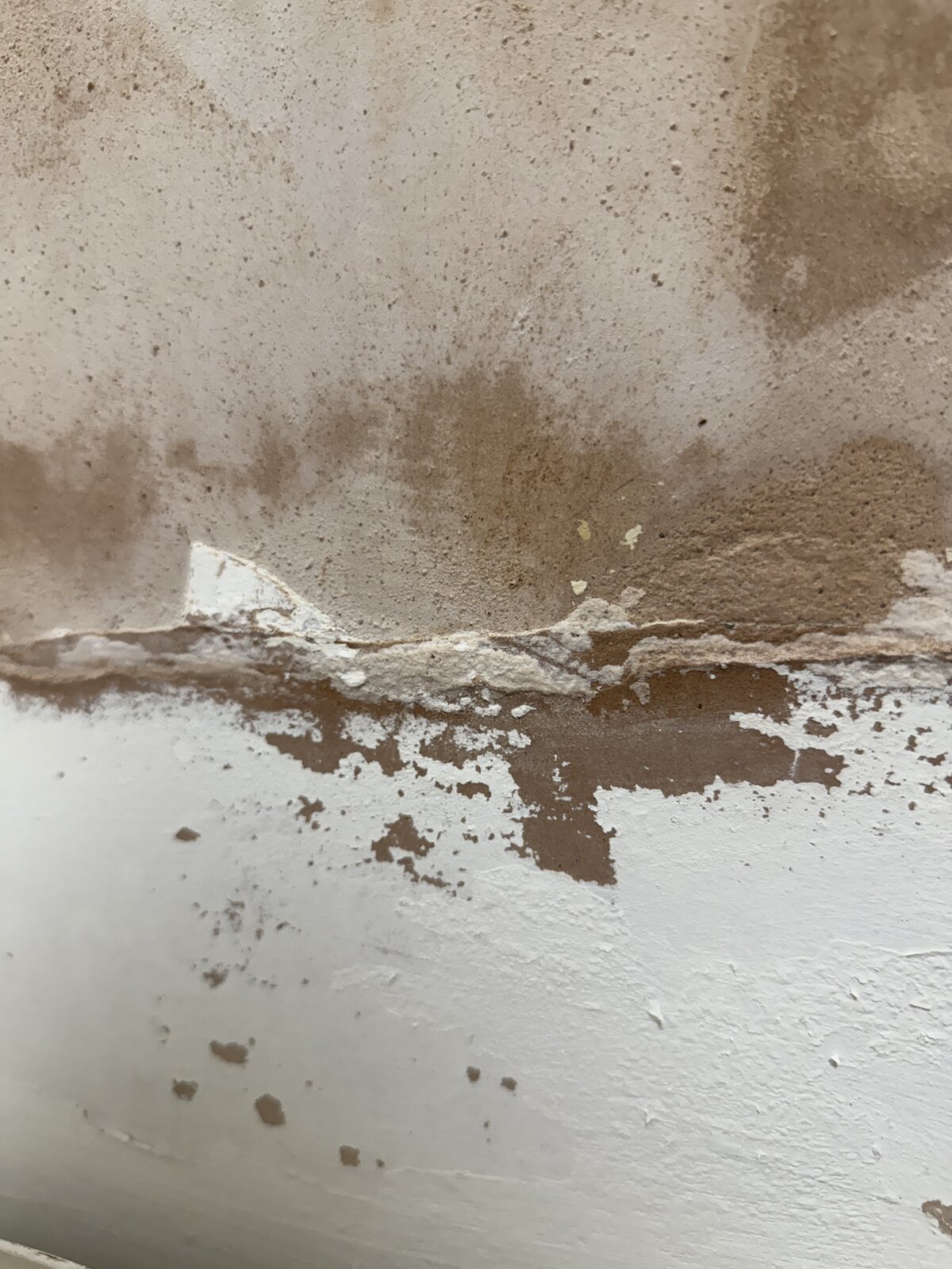

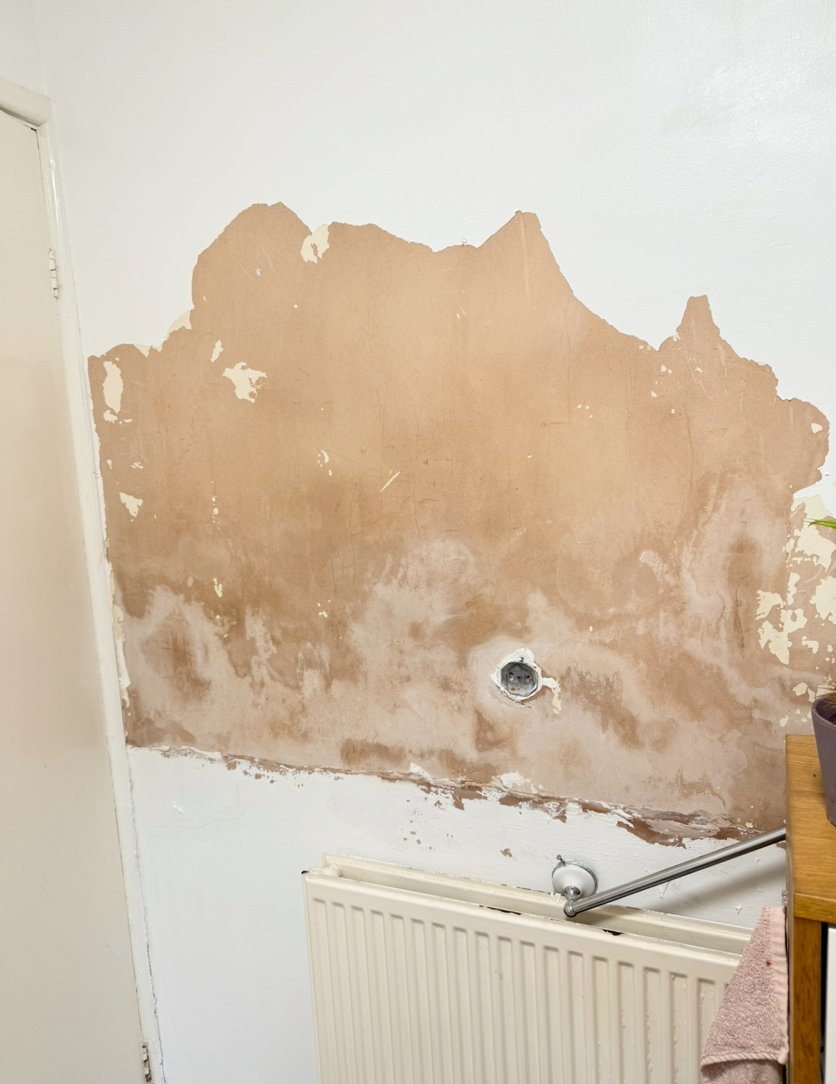

There is a hip height horizontal mark across entire length of the affected section, and where paint has come away I can see there is a slight change in plaster. From googling, I suspect that this is from an old damp proofing course, and what I am seeing is the line where the new patch of plaster was applied.

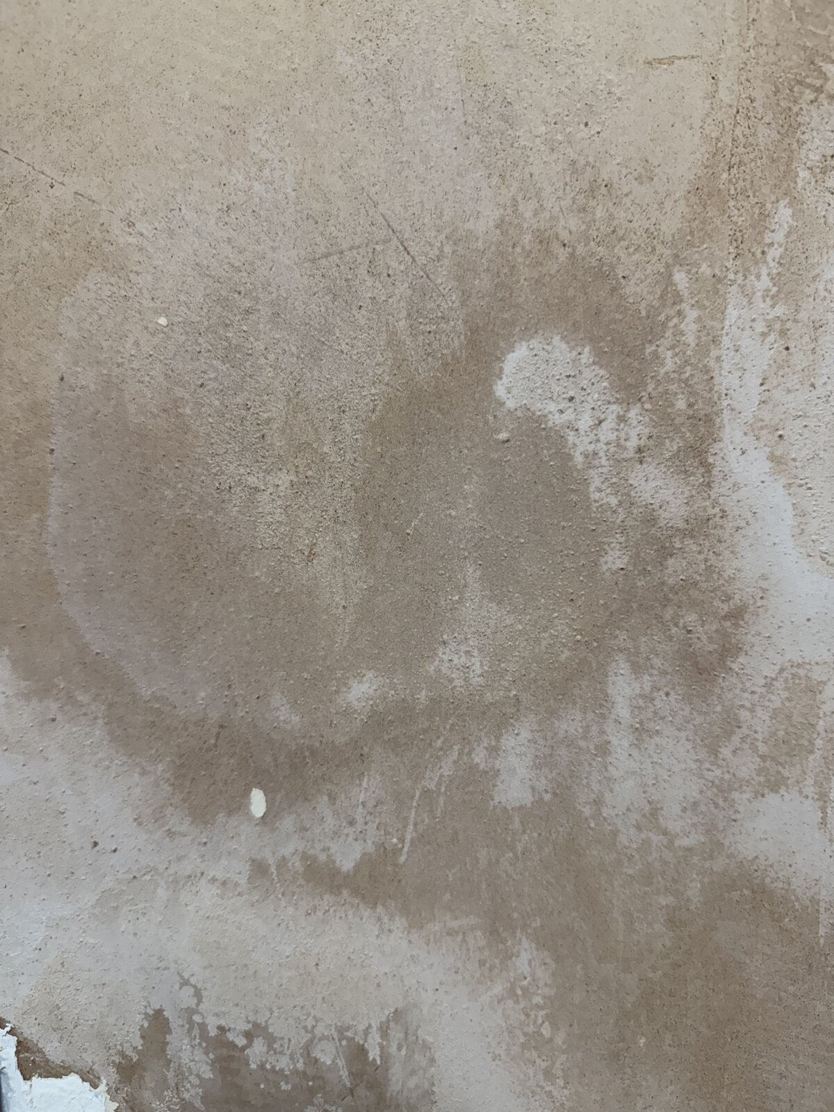

Above the line, paint started to bubble with efflorescence and so I chipped away much of it in the bathroom (until it stopped coming away easily), which revealed bare plaster which was damp to touch. Since being paintless however, the plaster has visibly dried somewhat, but more efflorescence has come to the surface.

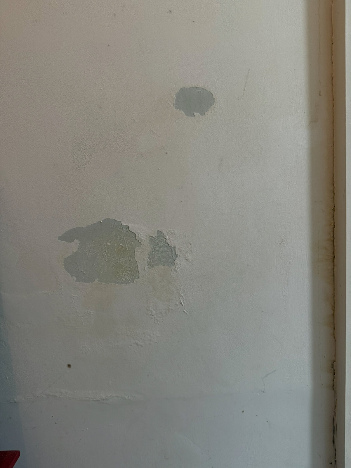

I haven’t done the same in the passageway but there is similar bubbling starting to happen.
My guess is this has been an issue prior, and they’ve shoved in damp proofing which I have learned from my research is often nonsense lol. So now there is continued issues, just further up the wall??

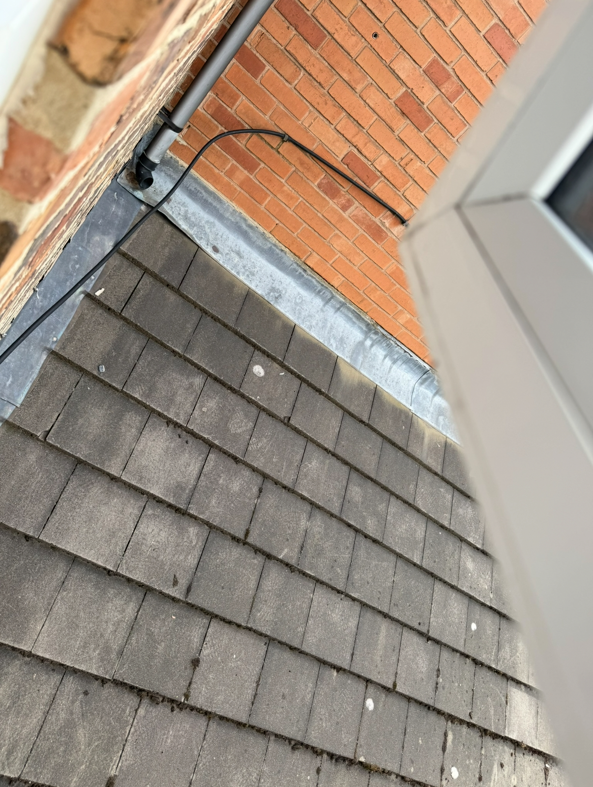

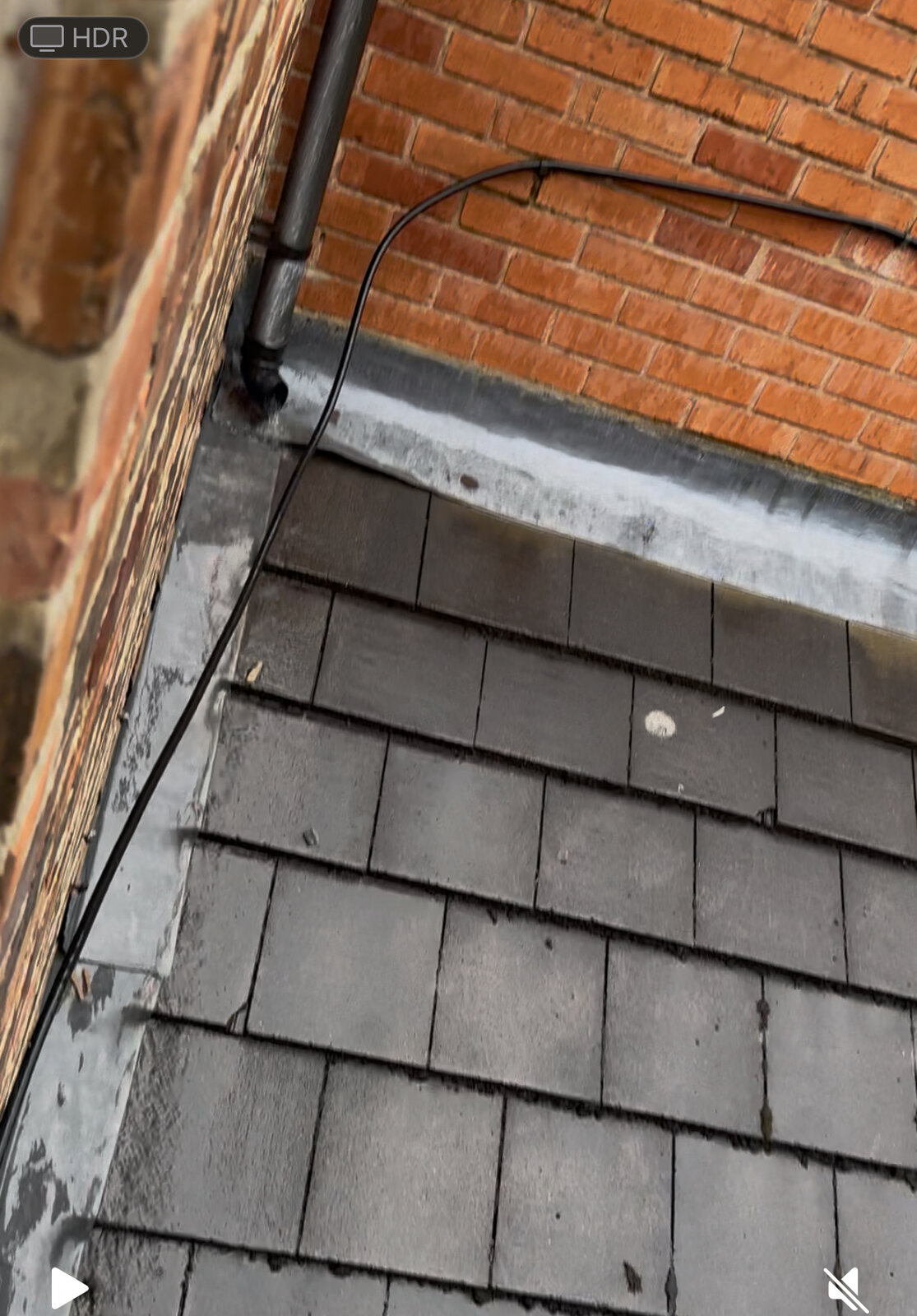

1. There is a down pipe discharging onto the roof above, with the lip of the roof flashings bent, which could be allowing in water. I would suspect I would see damp marks on the ceiling if this is the case, but water doesn’t always travel straightforwardly

The true problem is the water in the wall, not efflorescence.
Is there a concrete floor, and is it damp?
What souces of water are nearby? Pipes, drains, gutters, downpipes?
If the wall is wetter at the bottom (disregarding any "damp proof" render intended to hide it) then I would be thinking about a leaking buried pipe, especially the cold water supply.
Stand back and take wider pics of the entire suspect wall, and the walls around it, and of the floor, ceiling, roof, nearby pipes, drains and manholes.
Where is the nearest bathroom and kitchen sink?
Maybe a previous owner noticed efflorescence and/or dampness in the lower parr of the wall, and had the affected areas replastered. They may or may not have injected some damp proofing cream lower down while doing that. Because they didn’t fix the root cause, you’re now seeing the same dampness higher up, in the part of the wall they didn’t replaster.
Photos of the roof and rainwater gutters / pipes could be useful, e.g. from the first floor window.
That is indicative of structural dampness - ie water within the wall coming out.
That horizontal line above the radiator, is that hard render or different plaster below it? It looks like some past rising damp treatment has been done and the bottom 900mm of wall rendered/plastered.

I believe it’s a different plaster below it. The line definitely overlaps with the plaster above and so appears newer.

Pics of roof above wall ? Does it have a parapet ?
This is the roof above the affected wall. The affected wall is the long edge where the downpipe and horizontal flashings are. Inside, the efflorescence gets more severe from left to right (directly under where this pipe is is where it is least affected as far as I can see).

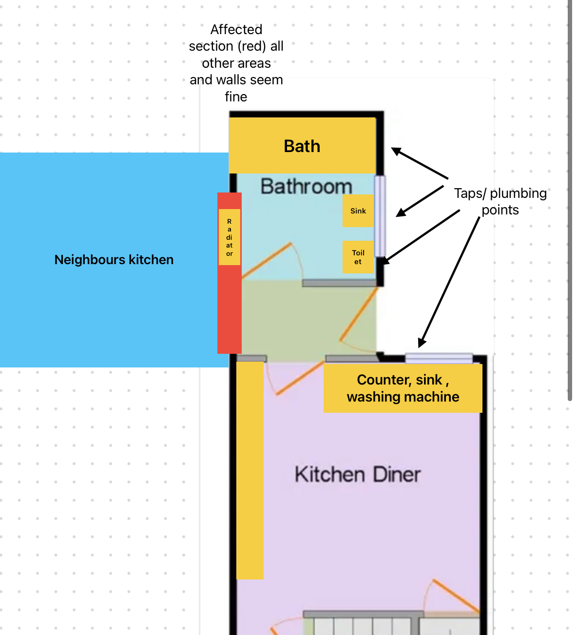

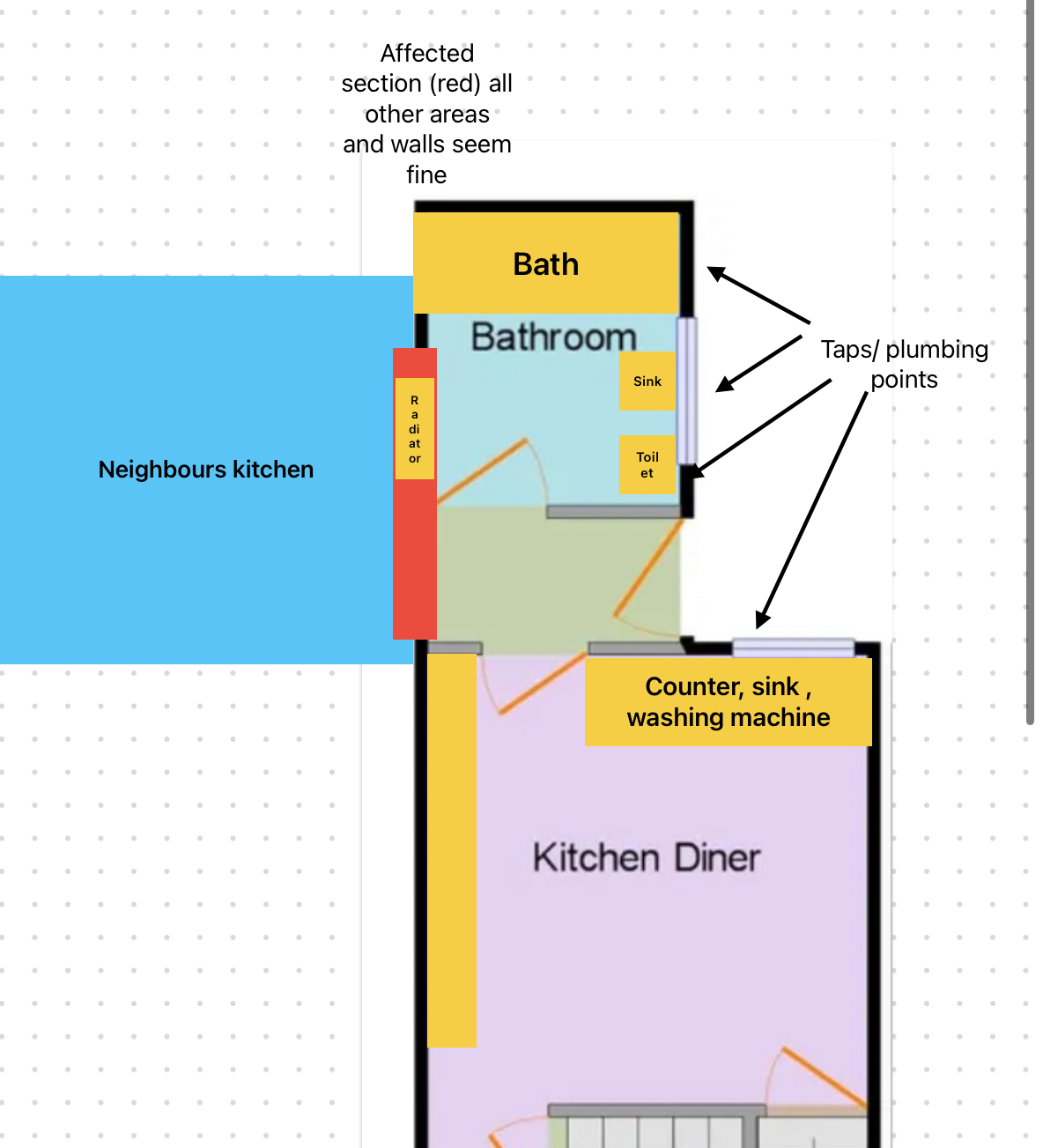

Rough diagram for you attached. The green area (passageway) has no plumbing, but is affected on the same wall - though less severely

I have a feeling the wet patches will be visible to the naked eye. Start beside the wet wall.
Exposing the whole floor may show where it is wettest, which may give a clue to the source.
Water supply pipes usually run to where the kitchen sink used to be when the house was built, and are prone to leak when 50 to 100 years old.
Kitchens and bathrooms are full of pipes and drains, looking at your diagram, the fault may well be next door.
If the two extensions were built at different times, there is a possibility of a roof or gutter leak between them. I don't know about the roof.
The lead work on the roof is lifted, will deflect any heavy rain back to wall soaking it every time you get heavy rain . Lead work against wall looks short which won’t help .
Extend down pipe by around a 1/2metre to discharge into middle of roof .
Rain soaked walls will take many months to dry at lower levels.
Looks like cable may also help rain track back to wall above the lead.
