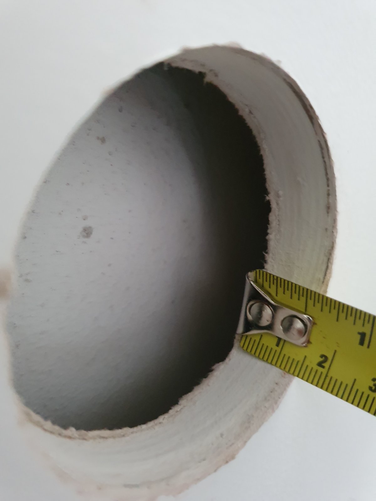

A) All floors are solid screed flooring.
B) Walls seem to be dry lined hollow (there's a hollow knock on them like they are studwalls but it's all blockwork) but i guess dot n dabbed onto walls not sure. Going to cut out hole out shortly see what's behind but they feel cold like the airgap between wall and plasterboard is cold?
Interesting though about adding celotex backed plasterboard to walls, could be a plan here. cheers.

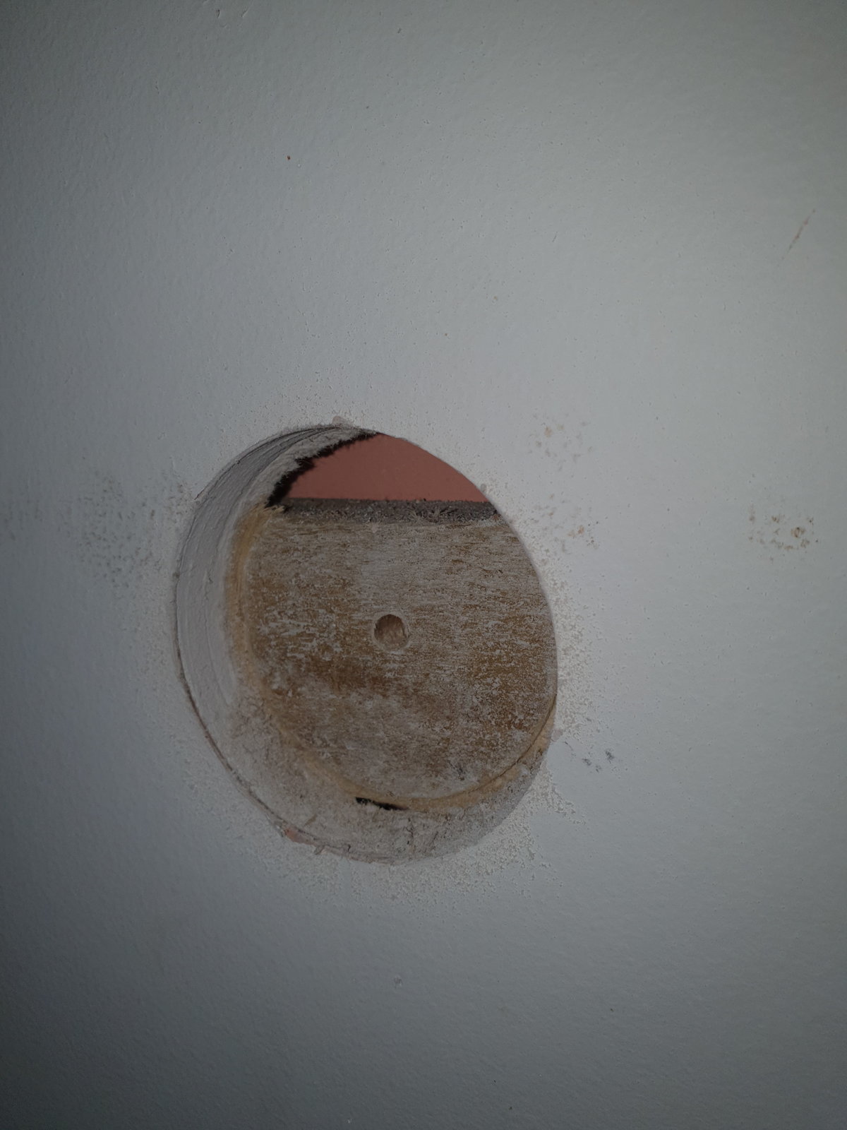

Ok I drilled a few holes as i was still convinced the boards have been applied to batons not dot n dab. I was right.
Now is this the reason or contribution to damp on walls the cold air behind this plaster board? Why use baton instead of dry wall adhesive? Just alternative method?
So I'm planning to remove all this.
Apply 50mm celotex to walls and then drywall it all.
How do I stick celotex to walls and then plasterboard to celotex thanks.

To insulate my house I used 50mm insulation backed plasterboard from British Gypsum. They were secured directly to the walls via dot and dab.
Sounds like what my rooms were like when I moved into my 1930s bungalow - they had battened plasterboard on walls, no insulation. Lots of condensation damp / black mould.
I recommended 50mm kingspan (or equivalent) + plasterboard, all stuck on with loads of everbuild pink grip foam - works a treat and easier to handle than insulation backed plasterboard, and you can seal all joins on insulation board before putting the plasterboard up.
