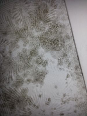

This is my first ever post and I am here because I seriously need some help. I am getting really pee'd off over the whole thing. We moved in to this house 11 months ago and everything looked fine and dandy except some dodgy half-a**ed DIY jobs that needed fixing.

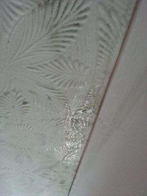

Around 3 months ago we started getting mould on our bedroom ceiling and the room has started feeling damp - to the point that as the weather has gotten worse we now have mould growing on clothing and bedding feels damp. I am starting to consider moving in to the spare bedroom because it can NOT be healthy for us.
I've had a few family members check the loft and should add that from what we have seen our roof isn't leaking.
So my question before I kill someone and my other half who say I am making a massive deal out of nothing - IS THIS JUST CONDENSATION?:

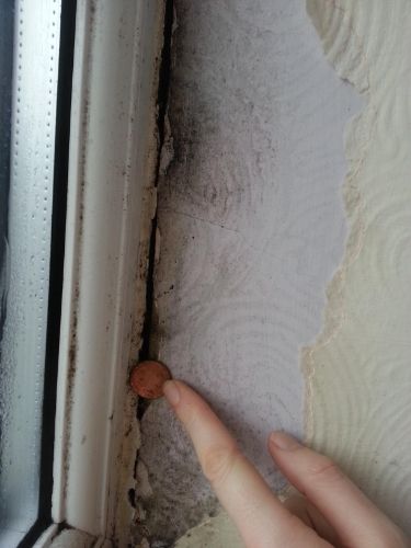

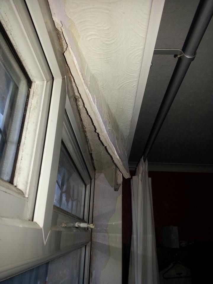

I have a problem with the window too in that there is a gap between the window and wall so the window obviously hasn't been sealed in properly. The plaster is getting so damp that it is crumbling and will more than likely need the whole thing re-plastering.

This looks bad and is probably caused by a combination of factors.
bathrooms are a high humidity area as we all shower nowadays, is an extractor fan fitted and does it work (can it hold an A4 sheet of paper against itself) or do you open the window during the shower or after.
Washing being dryed inside can led to this, just think how wet it is when it comes out of the machine
Does the property have heating, cold walls attract damp, is it north facing as naturally colder side of house/flat.
Has the property got cavity wall insulation - certain types of property should not have it as houses need to breath - watchdog has big file on terminal dampness caused by this.
We are also in a period of extreme rain and this May be adding to internal sources as will be soaking in brickwork or through badly sealed windows (brick to window silicone seals)
There are so many variations that can cause this that you need to take a look everywhere, I even know someone who had a damp problem in a ground floor flat who tried everything and the lifted a floor board and found the basement was flooded (dodgy London landlord denied there was a basement though)

As it started in the last few months (seasonal) it is very likely to be damp/condensation caused by you. I can see condensation on the window in one picture. Follow all the advice in those links. It is about changing living habits, good ventilation (especially at the source of moisture creation), and insulation.

I think i've found one major issue that's the first on the list to be sorted. Obviously from the pictures i posted the inside windows weren't sealed properly. On inspection of the outside, it seems that the sealant has worn in quite a lot of places (also need two small windows replacing as unit has failed). There is a lot of cold air and noise coming through the edges of the window. I'm currently in the process of sorting the inside window and will try sort the outside this weekend if we have decent weather (if thats possible)

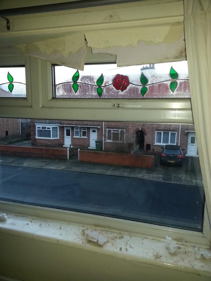

however, I mentioned concerns about the plaster on the window being soft. Well this happened today:
The wallpaper kept it up and there's another part that feels like it's going to give. The plaster that fell turns to dust if you touch it. So I now need to get the window re-plastered.

It could easily be a failed seal like you say. Either due to poor installation or just general wear and tear. Make a good inspection of the exterior of the window, the seal and the lintel, brickwork and roof above.
If the seal on the outside and inside has failed or in poor condition, then this could easily be the cause of water getting in, especially if you have had driving rain recently..
Another cause could still be the very cold air coming in round the edges of the window (due to the poor seal). Any moisture in the warm air of your house will condensate very quickly on the cold walls in this area. It soaks in the the paper, gets trapped there and turns to mold and eventually gets absorbed into the plaster.

With regards to the misted windows, you can get them "de-misted" however (depending on your financials) a better longterm approach will be to just get those panes re-glazed. If the frame is ok, you should not need to replace it, just the glazed unit.

With the windows, I should be able to get the small unit replaced shouldn't I? So the small windows and the plastic frame because they are they opening section of the window? The frame with the misted window is holding water which drips out so think it all needs to be changed.
Yes, as I said, unless you windows are 1st generation sealed units (they dont look to be) you can just replace the glazed units that have misted up.
There is a system whereby you can demist the damaged units without replacing them, but I have never had it done and do not know how long it lasts. Usually just better to just replace the unit if you can afford it.

Also, when you say water drips out of the glazed unit when it mists up, what do you mean? Do you mean that water appears on the interior window surface?

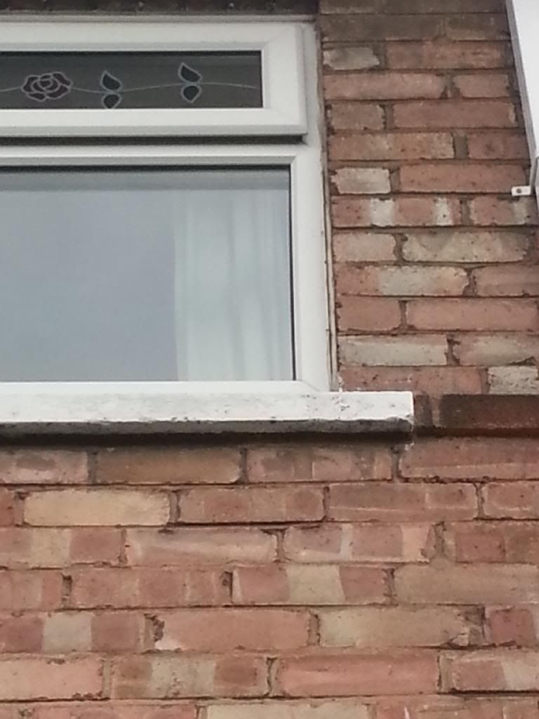

I took this pic from the outside of the house this morning before I got in the car and before it poured down with rain.

Try and get a good photo/look at the soldier course of bricks (the vertical bricks) above the window. That is an area where there may be a problem. Specifically check the pointing between the bricks in the soldier course.
If you are not sure what I mean by soldier course, type it in to google images and you will see.
I know what you mean, I'll have a look tomorrow. I know the seAl is patchy on the top because I could see through it in the part where the plaster fell down. Got plastering sorted out today so hoping it'll dry properly
I'll expect the pointing to be horrendous on the soldier course of bricks. There is a lot of pointing that desperately needs doing on the lower half of the house. Already designated it as a summer job. The pointing in a single brick utility room on the end of our extension has worn away in parts and there are holes. I could probably easily touch the plasterboard on the other side

Looking at the photos of the interior, there seems to be something wrong above the window, or the seal at the frame, that is causing moisture to get in and the plaster to fail.
There also seems to be a condensation problem, (the water droplets on the wall paper), the warm moist air in the house is meeting the cold surface and condensing.
Any cold air coming through the window seals or surround will cause cold spots where you will get condensation.
Until you find the source of the problem, make sure that the bedroom is well ventilated, especially at night, and use a watered down bleach solution to clean off the mould.
