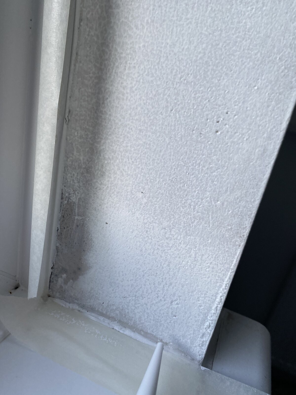

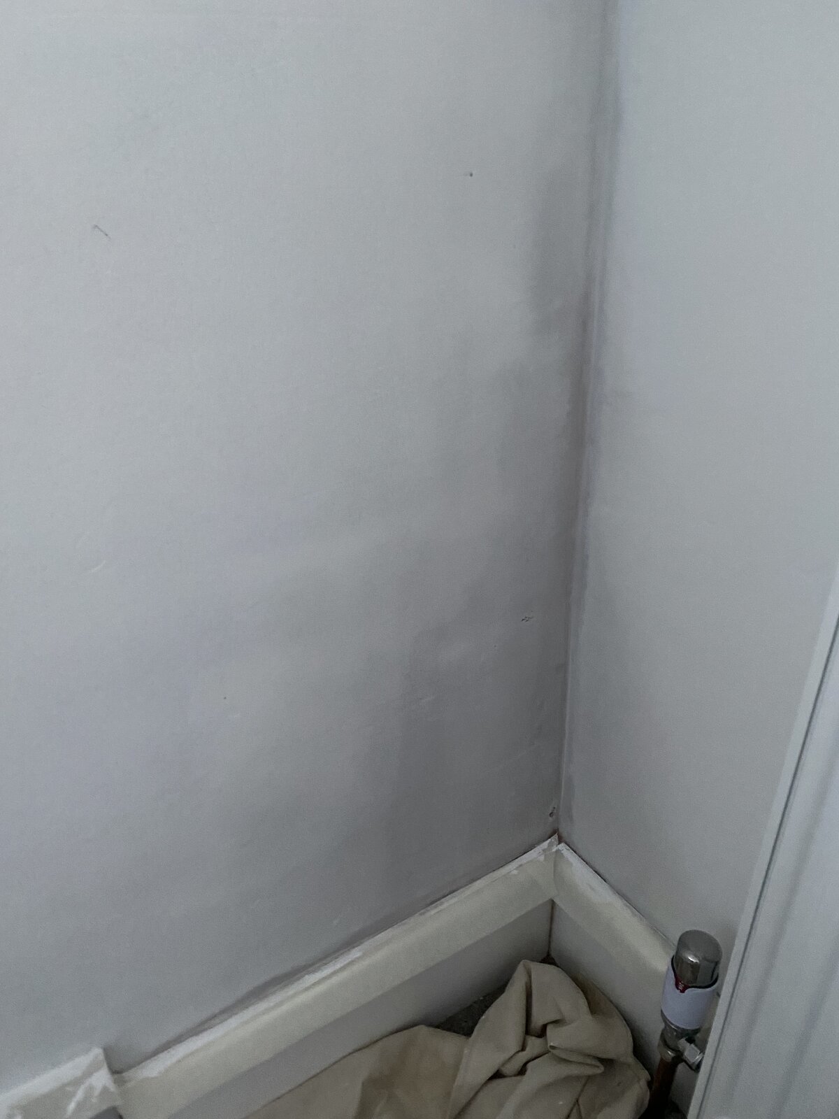

Just refreshing one of the bedrooms
I live in a 1902 2 up 2 down terraced
In the corner of the external walls the paint is still wet to touch (24hrs later), also a bit next to window inside the window reveal
I know it’s obviously a cold wall
Would painting it with damp proof paint before finishing it be a solution?
I don’t want to have to re do all plastering
Cheers
find out why the damp is occurring
send a picture it could be cold bridging due to a lack of insulation or high humidity.
Is the room well ventilated? Do the windows have trickle vents?
That looks like condensation. You need to reduce humidity and invest in a dehumidifier.
Have you got a humidity meter?
I have the window open but I do dry clothes in there (with window open a jar).
The radiator has only just been replaced as it’s not been heating up correctly
I have a dehumidifier, I shall put it on and see what happens
Cheers for help
Don't put any paint or damp seal or anything on top of it till it's dry ....
I assume it's water based emulsion
Get the radiator on for a few hours
It should cure in a day
Cheers for help
As said its OK to dry clothes indoors sometimes ....we have no choice in the UK really .....but u must use a combination of heat , window ventilation and a dehumidifier from time to time as at this time of year moisture has to have a helping hand to go away .and in some colder rooms it will stick around till the spring
Painting in damp rooms will soon show it up
Ventilation needed and heat.
Dehumidifier should help a lot.
