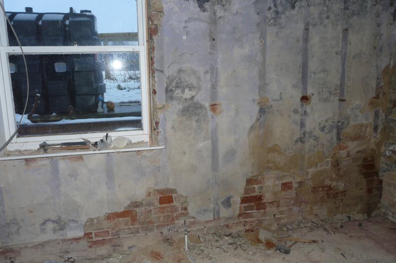

We have recently moved into an old Victorian property which has not been very well maintained. We are currently renovating the living room and planned to insulate the solid wall internally. We have removed the lath and plaster and the stud work that held the laths and found a few of the bricks are damp (they powder away when you rub them) and the plaster under the laths on the solid wall is crumbling off and cracked (and also the purple coat is powdering away as well).
The wall in question is an external wall and someone has raised the level of the concrete path (outside) alongside this external wall by about a foot, so is probably above the DPC (if there is one). The outside wall has been painted over, I am not sure if this is helpful or if the wall needs to breath to help dry out.
I would like to know what I need to do with this wall, before I proceed with the stud wall insulation. I can think of three options, but would very welcome more ideas or improvements for the best solution??
Pictures are in the Damp Living Room album.

Whatever you do internally will be ineffective unless you tackle the problems outside.
The wall is obviously remaining wet, probably due to the raised path, and also the external paint. With this arrangement, any dampness coming up from the ground (it's unlikely to have a dpc) will be unable to dry off externally and will come through inside instead.

What should I do with the damp plaster that is on the damp brick.
1. Hack it off then fit the insulation straight onto the brick?
2. Hack it off then apply an undercoat of plaster before fitting the insulation?
3. Just dry it on the brick and fit the insulation to the old plaster patching up the large holes?
(all options we will dry off the wall with a dehumidifier and fit the insulation with an air gap that leads to under the suspended floor, as this is where the air bricks feed into.)

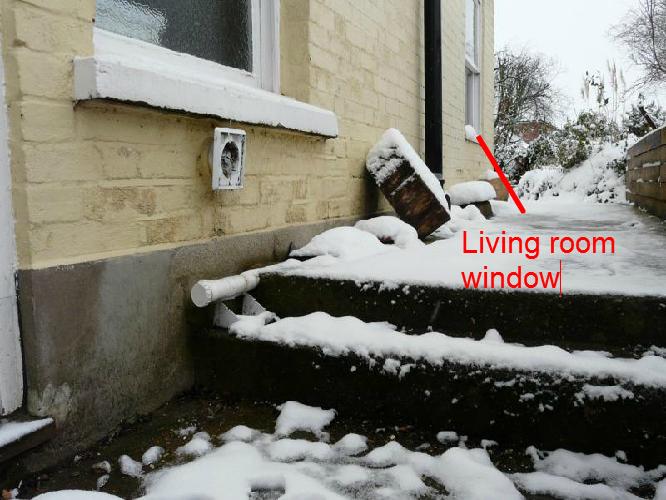

This is the path along side the house:

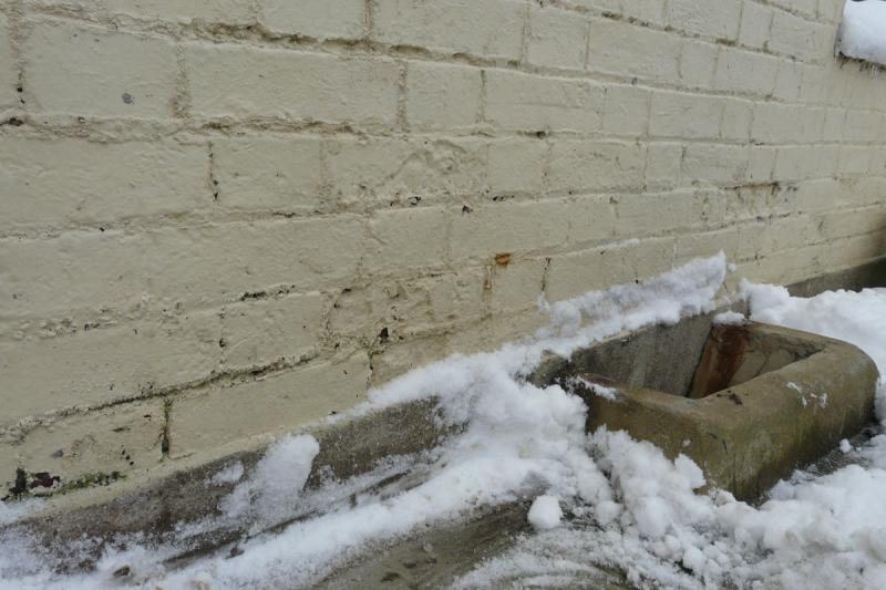

This is he condition of the bricks from the outside and the air brick which has been left open within the concrete path:
I see a downpipe and a wastepipe close to the damp wall. No surprise there.
I won't be surprised if you dig them out and find leaks.
I'd have thought that you'll need to fix the outside first (drop the path below the DPC, restore any blocked ventilation holes, fix any drain leaks etc) and then let the bricks dry out before you do much inside.
If you're insulating the inside wall then you may as well strip all the existing plaster off. Might help dry things out a bit quicker but I'd imagine it may take a while.

At the risk of being repetitive, you need to sort out the damp problem first.
This means lowering the path, checking - and if necessary adding more - airbricks and getting the paint and plaster off the wall.
Then leave adequate time for the wall to dry out before attempting any reistatement; this could take some time.
