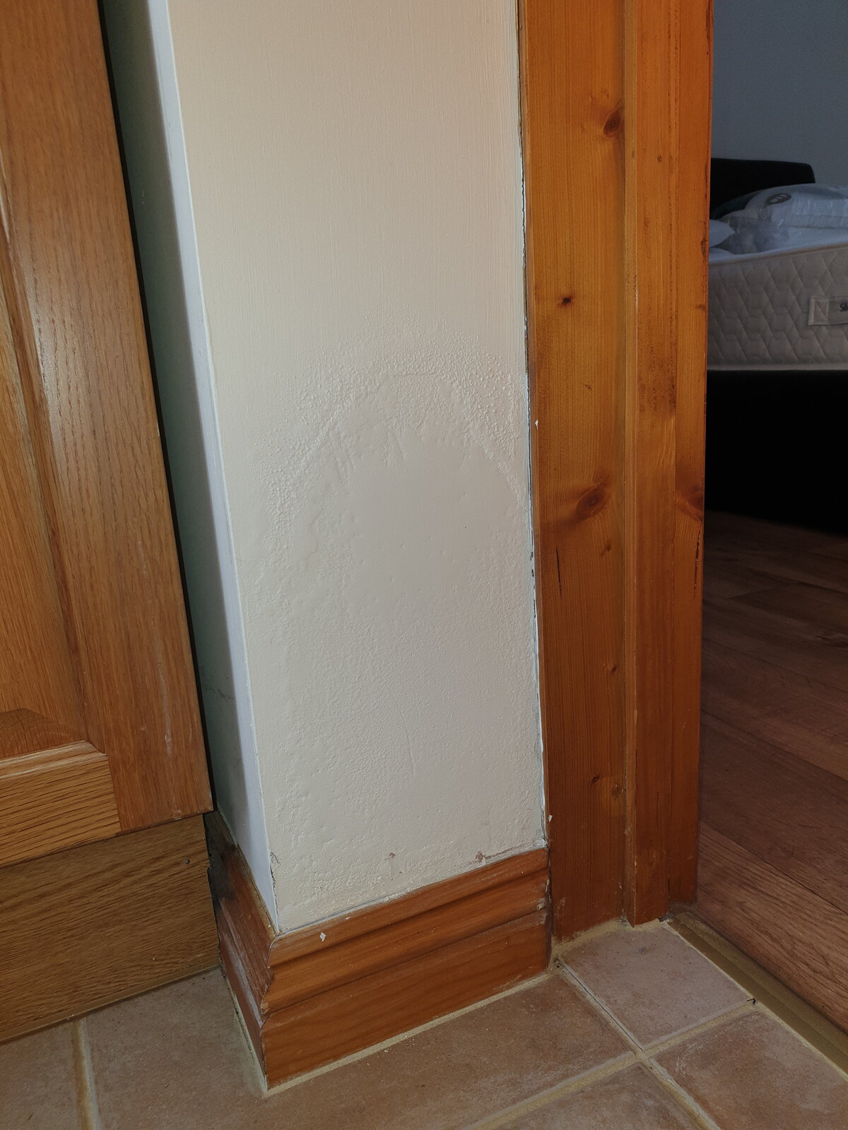

Hi,
New house, uncovering various things.
Could anyone help with this damp? Not sure if the pattern indicates what is causing it. Also not sure if it's historic or recent as we've only been here a couple of weeks.
The "damp" only appears to be on the end of the threshold, and not on either side of the wall.

depending on age, I'd be thinking of a pipe leak under the floor, or water penetration round or above the doorframe.
I think that wall has recently been hacked off and replastered, probably to hide damp damage. There might be a pipe buried in the wall.

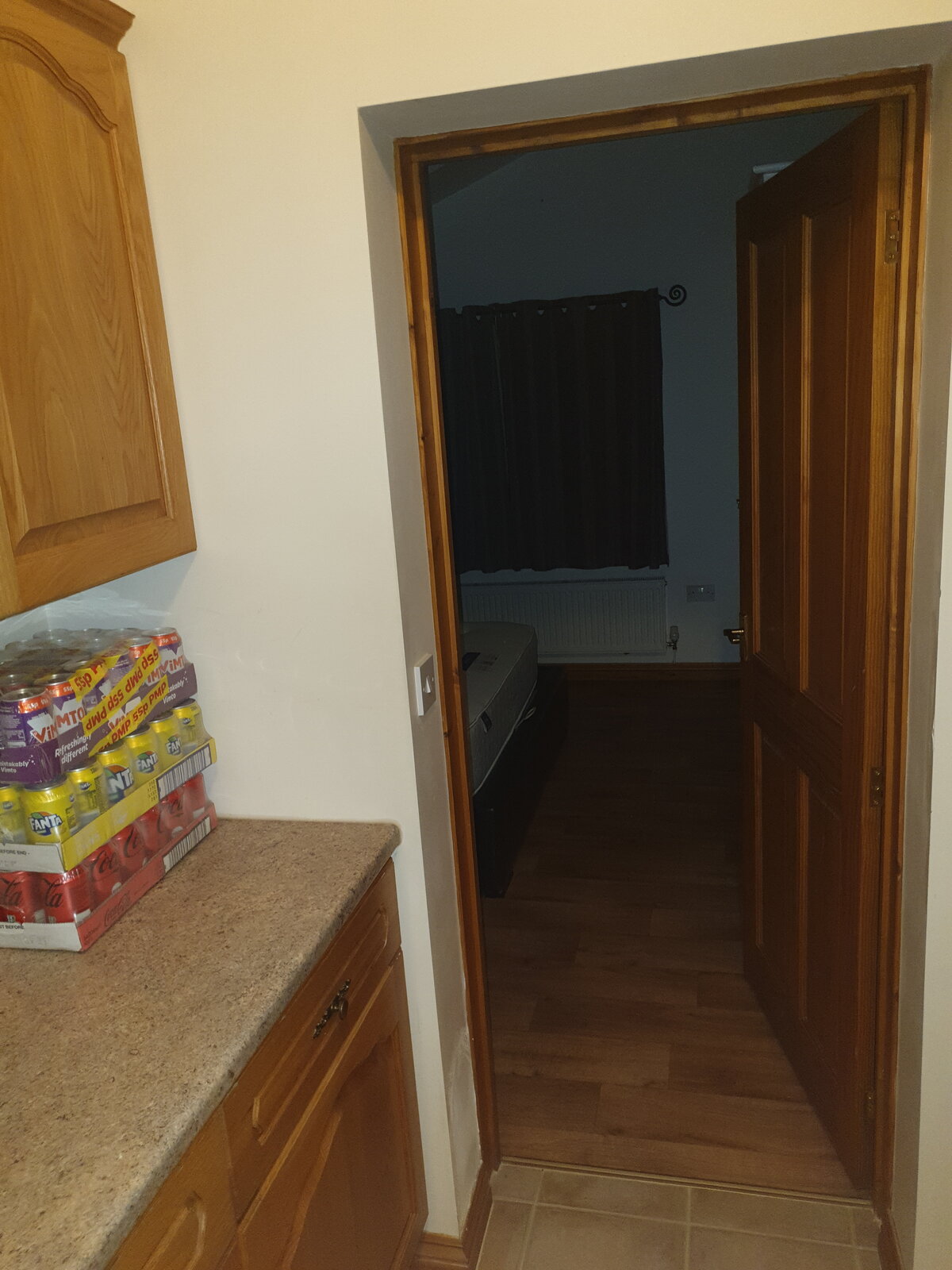

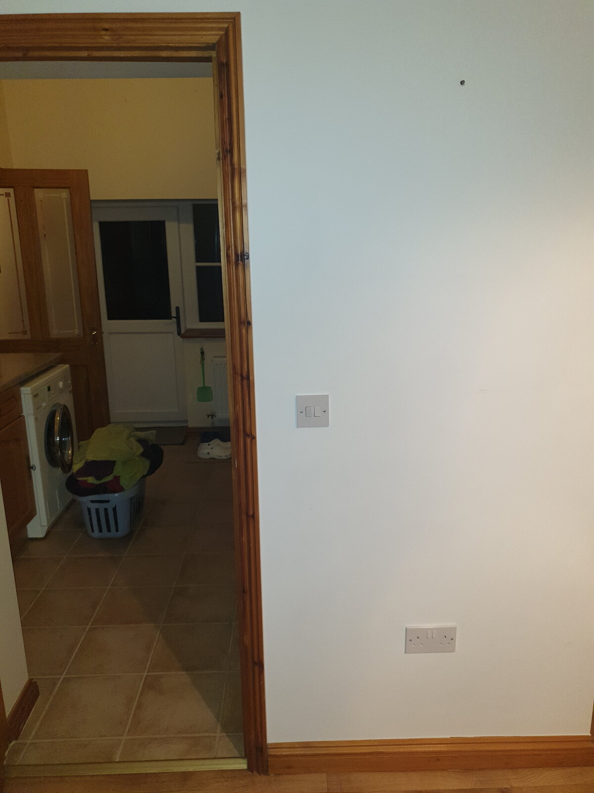

So here are photos of either side, and as you can see, there's no indication of damp.
Can you clarify what exterior photos you need? I'm just a bit confused as that patch is not near any external wall.

I can't see any marks on the wall with the socket. Is it plastered brick? or plasterboard?
Might be old damage, if it was more serious I would expect it to also be on either side of the wall.
It might be caused by condensation bin the kitchen over a number of years.
Also check to see if there are any pipes under the floor in that area
Also if it's as old as you say, it might have the wrong plaster on the walls, meaning the wall cannot breath as it should.
Rub it down back to bare plaster, prime it with zinsser bin and then paint over it, see how it goes. If it comes back will have to look into it a bit further

I've not looked hard enough yet to know if it's plaster or plaster board.
What was confusing me is that the patch is on only in the end, and not on either side.
My theory is it is a cold spot and condensation. I had a virtual identical spot in the kitchen in the last house. We had a fridge with base condenser next to it and the air circulation from the fridge caused condensation on the base of the wall nib (which at one time was an external wall). I bet there's a draught under the door.
Agree with mrrusty. Most likely long term condensation damage, possibly due to incorrect or contaminated plaster type, uninsulated wall junction with uninsulated floor, excessive moisture vapour, poor ventilation, etc. Numerous possible reasons.
