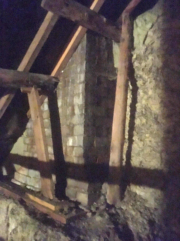

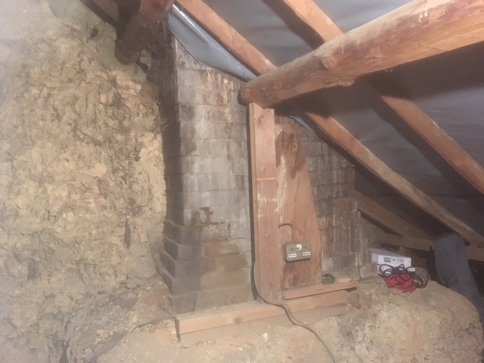

I went up to the loft the other day and noticed damp patches on the chimney stack:
What could be causing this? The pointing in the chimney stack above the roof line? The chimney pot has a cowl on it. All the cob around the stack is dry - its only the dark bricks you see that feel slightly damp to the touch.

OK there is a cowl but is the flue or flues in the chimney in use, or dormant? are there any vent terminals within the rooms? if the old fireplaces are blocked of?
You will have to get up close and personal with the chimney head to ensure that the pointing is indeed intact?
There appears to be on the image posted a "damp area" on the right hand side [as seen] which is it appears the full height of the internal area of the chimney breast, such a marking is indicative of a problem with the lead flashing between the chimney head and roof tiles or slates? I assume that there is a lead flashing or is it a cement flashing in this location?
You can sometimes see the lead flashing from the ground using a pair of binoculars or similar?
On numerous occasions I have seen the lead flashing as above being stuffed full of dirt and debris, the dam of dirt Etc. can allow rain water to rise above the level of the flashing and enter the property?
op, why not post photos of the outside stack an stack flashing.
if you can, photos of the flaunching an pots o top of the stack as well.
the streaks mean thers been leakin previous - maybe still is?
have all the flues been swept an ventilated top an bottom?
whoever fitted the membrane underlay has done it wrong at the chimney breast - it sshould roll up behind the flashings, not drop down.
the rafters are undersized for that span an buckling - two log purlins have been inserted.
the supportin post for the lower log purlin could split an thers no sign of any fixings to the waney rafters or the post - its all relyin on gravity - thats bad news.

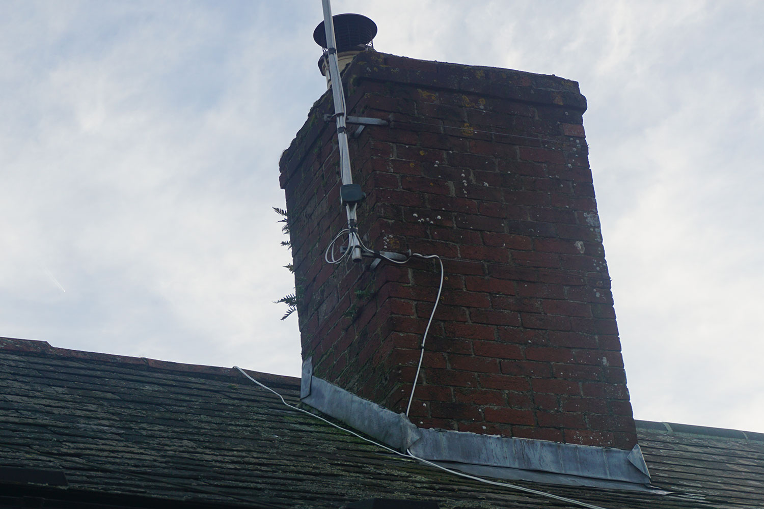

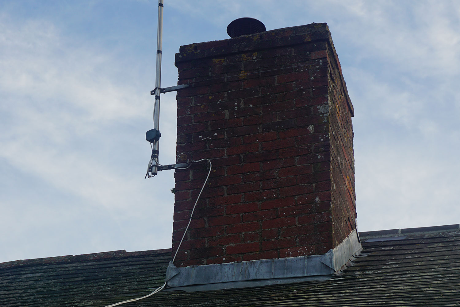

Best to get up there and have a closer look I think. Can only see part of the chimney and flashing from the ground and we can't see the condition of the chimney crown at all.
Hopefully these photos show a bit more detail.
Does the pointing look that bad that it would make the chimney breast damp?
Does the flashing look like it has mastic on, which is perhaps falling away. If so the water could be getting in behind the flashing.

yjones, good evening again.
Images posted above assist a lot, they can be enhanced and brightened up as well.
Several things.
1/. in the last posted image, there is a lot of "vegetation" [ferns] growing out of the mortar joints, never a great sighn, the ferns need to be totally removed?
2/. I the first posted image, there appears to be a lot of missing mortar on the right hand side near the upper [back] end of the side of the chimney, the position of the missing mortar is close to the line of the lead flashing, this will allow rain water an entry point?
3/. In image one posted there may be a load of debris built up between the lead and the slate ?
4/. The images posted appear to indicate that there may??? be two layers of lead, one stepped. the other may?? have been run over the top of the stepped lead flashing?? as seen in images 2 + 3 this could indicate historic problems with the flashing's, hence the need to insert the second flashing over the first??
5/. The cap, the "topping" to the stack appears to be thin? could be a skim of mortar only, this can crack and admit rain?
6/. There appears to be lead wedges that can be seen at the top of the lead, where it would appear that the lead has indeed been tucked into a raggle formed in the brick [the wedges jamb the lead into place to assist in holding the flashing's in position] however, some pointing appears to be missing at this raggle.
In general terms an overhaul of the stack would not go amiss, a general good rake out and re-point, at the same time a good look at the flashing's would be a necessity
