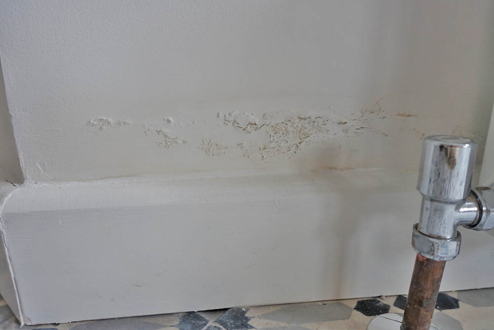

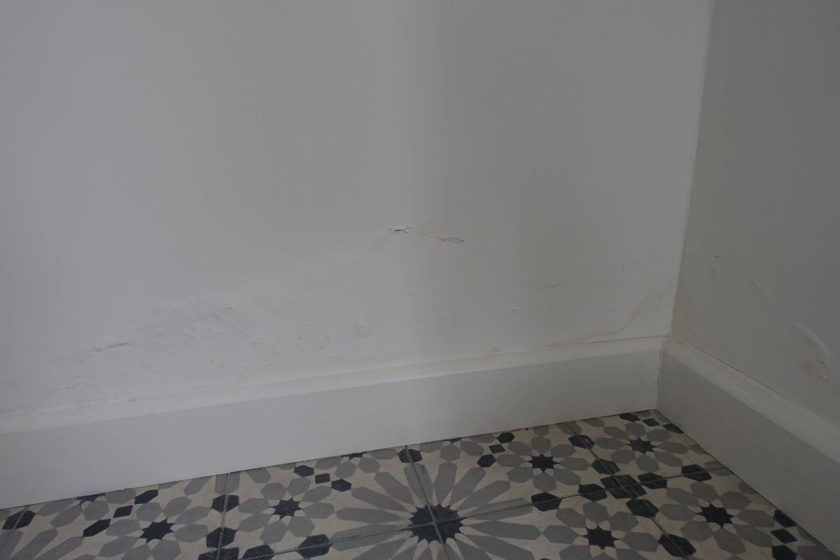

I recently had my kitchen renovated, in a Victorian terrace house I've just bought. A couple of weeks after painting, damp has started to show above the skirting on both the external wall (underneath the bay window) and internal wall next to it.
Under the bay window:
The internal wall:
Any idea what sort of damp this is?

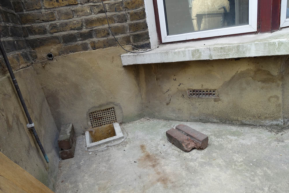

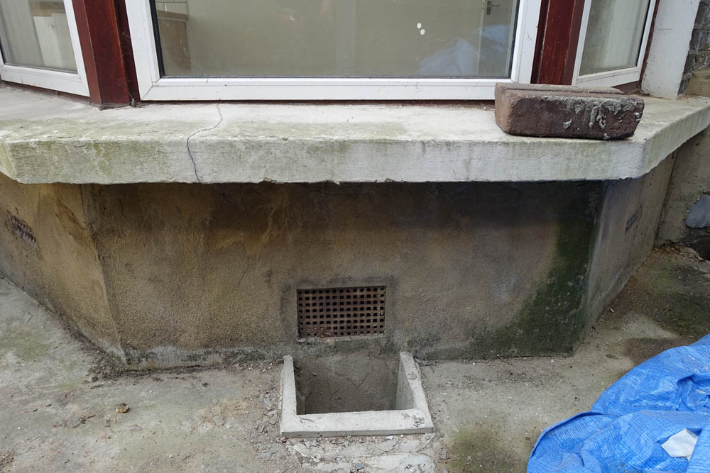

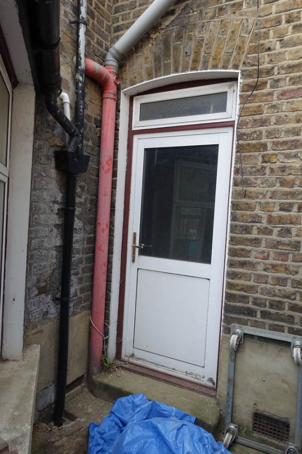

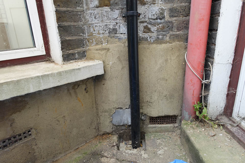

Sorry for the delay Burnerman. The damp is only in the bay - I've got some photos of the outside wall. There's some vents which are actually above floor level, which were there when I moved in a couple of months ago. Before I had the tiles laid, I got 2 deeper vents made (in the middle and left of bay), which are actually below floor level. You can see the hole for them in the photos.

Thanks for the pics, Dan.
What immediately springs to my mind is that the ground level outside the bay is much too high.....there's every chance of moisture wicking its way up there, although the two small air bricks may help keeping the cavity dry (assuming it isn't full of rubble, of course!)
Is there any chance of digging a trench through the concrete, alongside the wall to a depth below the damp course?
You can also expect water wash from the bay window and rain splash helping to keep that external wall damp.
Is that render hiding poor condition brickwork, do you know? It would seem that whoever put it on was trying to cure exactly the same problem!
John :)
1 - the yard concrete is too high.
2 - the render is bridging the DPC. The render should be completely removed or at least cut away for 50mm to break ground contact.
3 - can you mark the photos to show exactly where the FFL is on the bay?
4 - the house walls appears to be solid.
5 - there is no purpose for the air vents higher than the kitchen doorstep.
6 - the new vents: what is the purpose of the "hole" unless you are going to use vents at a lower level?
I assume that the bay floor is suspended?
7 - the sill throating is allowing drip back on the RH side dark green area.
8 - the window frames need re-sealing.
9 - have you been below the bay area floor & examined the joists for rot?
FWIW:
- the gulley appears to be blocked - clean out the gulley, grating and trap.
- the bay roof flashing is wrong & needs re-doing in stepped cover flashing - with the sand & cement filett removed & cleaned off.
A "Kickout" is needed at the bottom of the flashing to direct water into the gutter.
- Various applications have been applied to the brickwork - presumably to deter damp. The brickwork needs cleaning up.
- In a traditional build all external pipework should be in black plastic.
If the soil pipe after the WC elbow is a vent to roof then there are better ways of arranging it.
What did the mortgage surveyor have to report about these things?
