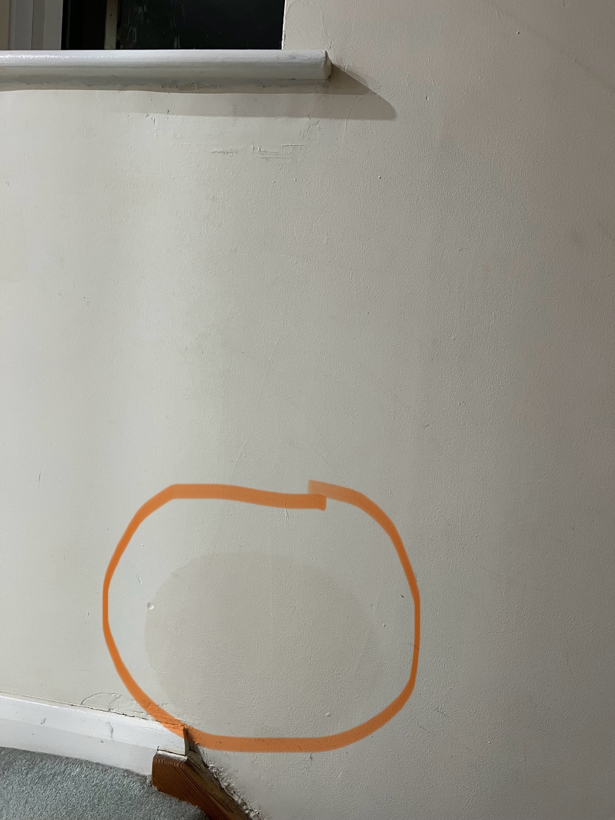

Can anyone advise what might be causing this damp. The property is a 2 storey end terrace, walls are standard red brick with block internal. The damp is on the end wall at the top of the stairs just below a window. To my knowledge it has only appeared today after the persistent rainfall. Unfortunately, I only just noticed it so couldn’t really see the external wall properly in the dark, however it didn’t appear to have any damage.

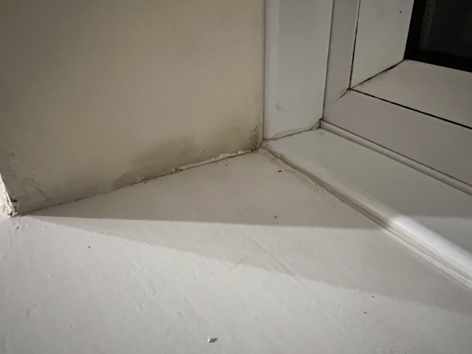

Check the sealant round the window first. An easy fix if that's the problem. When I had similar in the old house a 2mm gap in the sealant let in three bucketfuls of water during a single rainstorm.

Is the wall plastered block, or plasterboard on dot and dab?
The round shape suggests water is coming through at one specific point.

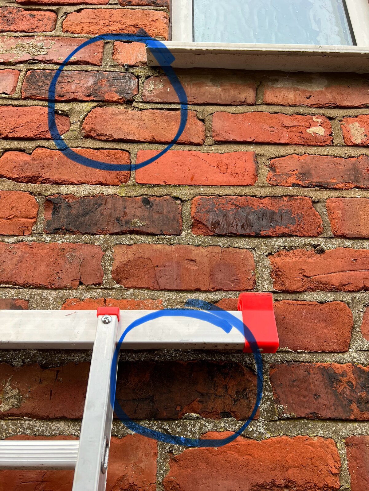

I’ve been up on the ladder to see if there was any damage to the pointing or bricks but there didn’t seem to be anything obvious. The bottom circled area is where the damp patch appears internally. The only area of pointing that looked suspect is circled at the top of the picture, although I’m not sure if it’s anything or not. Unfortunately, I couldn’t get up high enough to see if there was any damage to the window seals, from where I was they didn’t look too bad.
I’ve now just discovered a damp patch in the bottom corner of the window, the opposite corner to the damp on the wall. The plaster is very soft and the sill is swollen in the same area.
It appears to be a cavity wall. Water might be tracking across a tie or bit of rubble.
The bricks are very poor and the pointing is bad. Does water run down the wall from a spilling gutter or something?

There could be a take your choice selection of various issues
eg. sealing the frame - open the frame & use maybe a selfie stick to check the frame sealing - water test the.drainage holes Checking the eaves or verge. The pointing is rubbish - it needs chasing out to 25mm depth, & re-newing. Do you have CWI?
