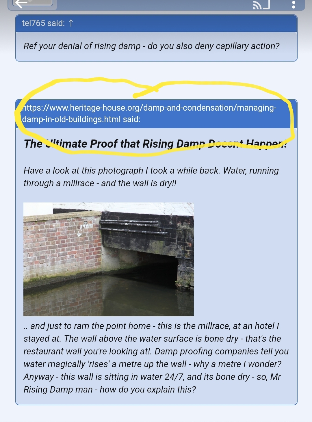

"have a look at this photo I took it a while back"
jacko555,
I'll try and explain Ted.
The big blue box is a quote box. You can enter one by pressing the quote button.
The source of the quote is in the title. I have highlighted it for you ted
Does that help?
And do you agree with the quote Bobasd? Maybe ask ree or vinn, maybe they can explain if the picture is not clear?
I cited the source of the pic in the quote title.
I did not claim to take it.

Good one jacko ! he's been at it for 5 years now, starting as ree. The best one is his insistence that mastic asphalt flooring is tarmac. Thing is, a lot of regulars know him but a newby DIY'er doesn't. Call him out at every opportunity;)
So wrong and so sad to quote a salesman called heritage house.
He defies and doesn't understand gravity either.
Maybe this will be a learning opportunity for me!
Can you explain, in simple terms, why the bricks are dry? Knowledge is important. Please educate me
