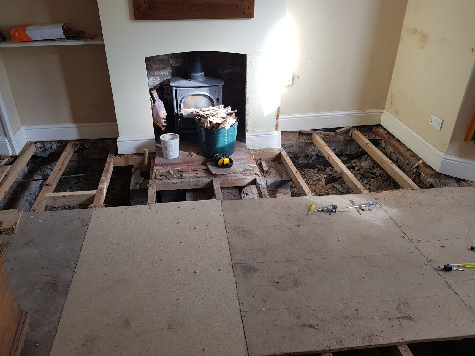

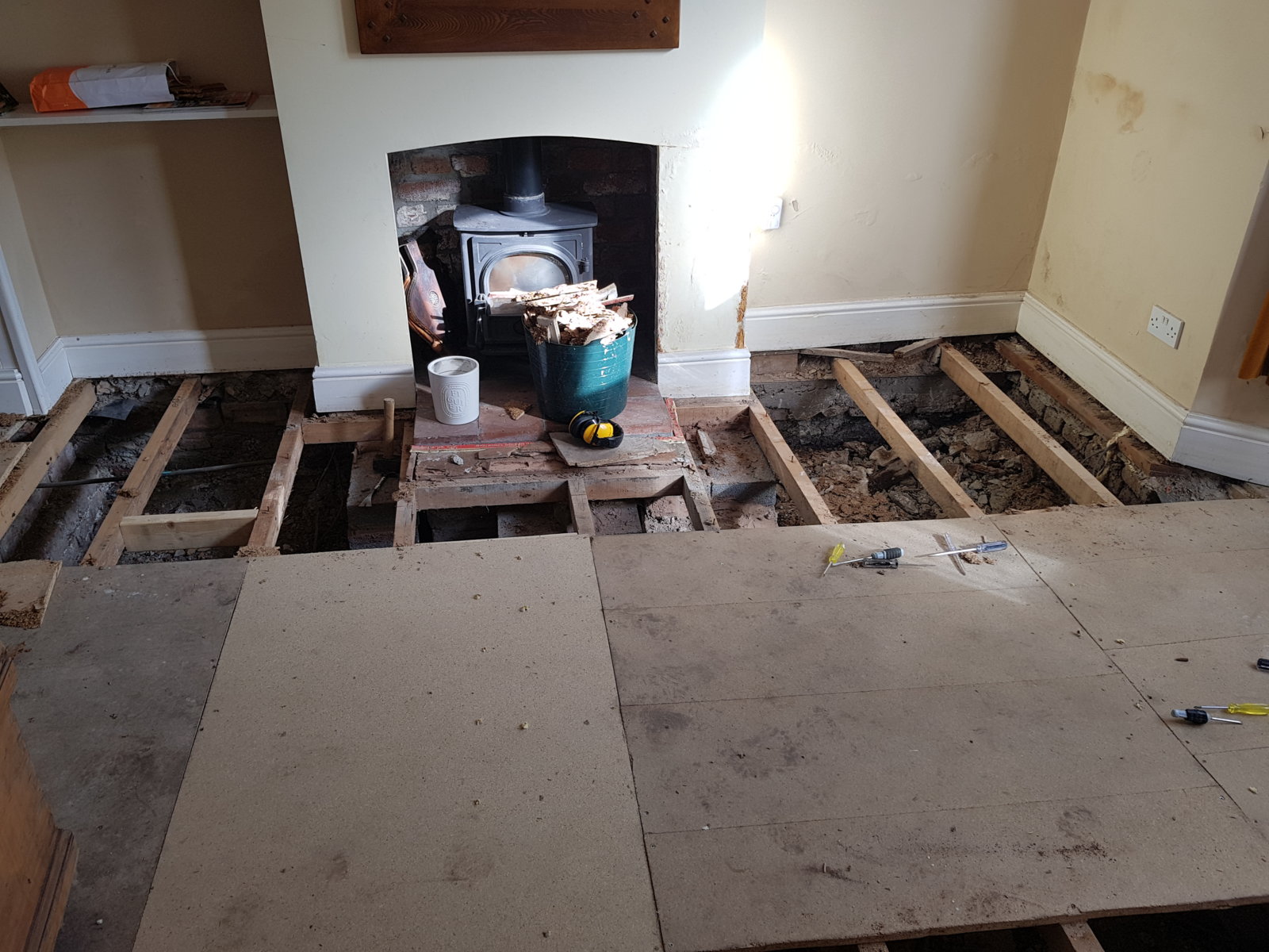

As you can see from this first picture, we are having a massive infiltration problem around the chimney breast.
To give some general information, we are at the ground floor of a two storey Victorian house. To the right of the picture there is the external wall. We have been living in the property for 2.5 years and the problem has surely worsened.
To be precise, the damp/humidity problem affects the chimney breast and adjoining wall on the right side, as it can be seen from pictures below. Plus there is some mould-like patch on the following wall, which is external. When ripping up the floor in this area, a forest-musty smell came up. There is a bay window in this external wall, it has a couple of air bricks at the bottom which are free on the outside, haven't checked yet the situation on the inside.
This picture is the external wall, in the alcove. It looks more mould than anything else
This picture is the alcove on the opposite side, as you can see this side is perfect.

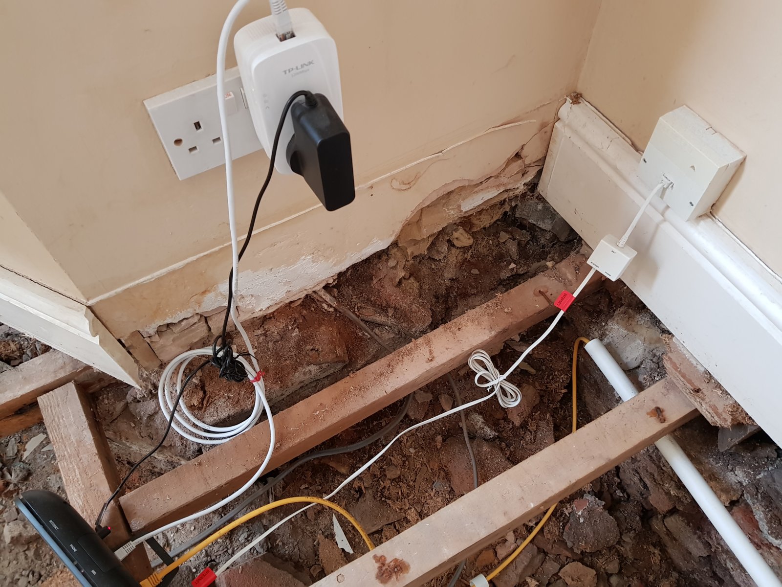

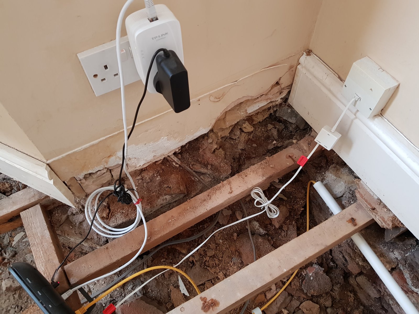

Now we are having a look under the floor level, where the biggest infiltration problem is. As you can see in the picture, on the right I see a DPC, I don't see any DPC continuing towards the front of the chimney breast. Evidently that joist is quite damp.
A view under that very same joist
Here is a view of that very same joist on the left and the DPC on the adjoining wall.

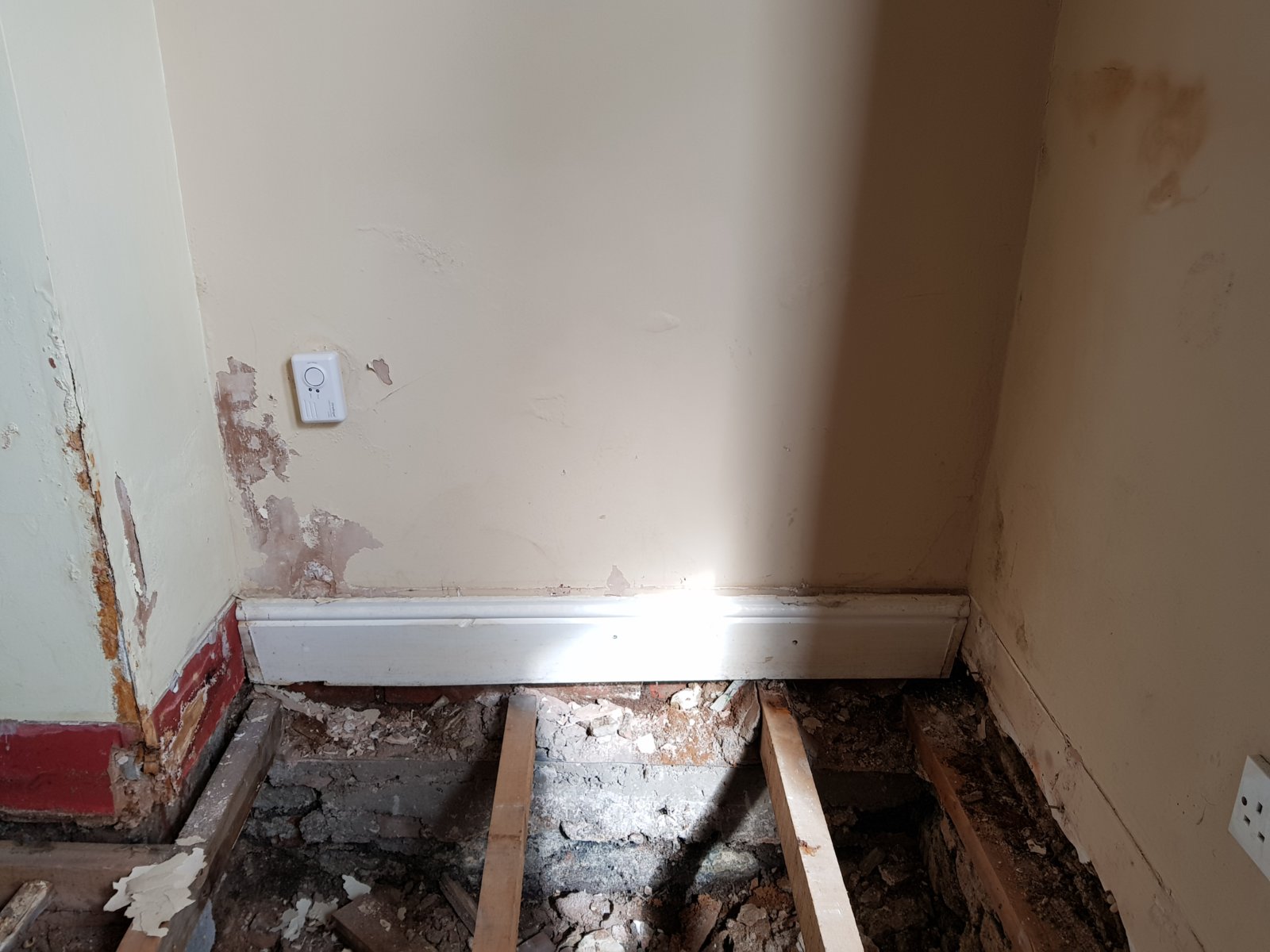

These two pictures are taken in the corner of the external wall, where there is that mouldy patch at mid-height. As you can see the chipboard that sits directly under the wall has turned into a friable sponge. It is dry to the touch, but it also hasn't rained heavily for quite some time.
This is a view of the sub-floor area under the front of the chimney breast, funnily enough it looks in pretty good conditions!
A couple of (potential cowboys) dampmen have been around. I am not really amused with their quick and dirty "rising damp" explanations.
To be remarked also, last year on that external wall we had the fascia/soffit and guttering re-done, as some rainwater was coming down the fascia onto the wall. So maybe that could have been the cause of the mouldy patch, but I am again dubious as it is just a patch mid-height on a wall on the ground floor, the rest of the house in that area looks fine (we do have wallpaper upstairs though).
I personally fear there is actually a couple of problems going on: the plaster in the chimney breast is bubbly, meanwhile the external wall is more mould-like, surely that has to do with two different causes? Also, chimney breast no DPC, maybe that is really rising damp, but the other walls have DPC, so probably it shouldn't be rising damp?
Anyway, I really am not sure how to fix this problem and who to turn for advice, hence I hope some of you guys can point me in the right direction or has maybe a tip on how to find a good damp specialist!

There's no easy way to repair what you've revealed - if you as a DIY'er do the work then it's simple to do but will take time.

In pic one remove all the skirting along that back wall and chimney breast. Is the back wall a party wall or an outside wall?
Hack off plaster to a height of 1m. all along above where the skirting was.
Mini hack saw off the external angle beads at 1m - use plastic angle beads when making good.
Remove proud nails from joists and lift the carpet gripper strips.
Remove all debris to outside the house.
You will have to cut out some of the joisting and do further works but for now, do the above and when its done pic it and come back here.

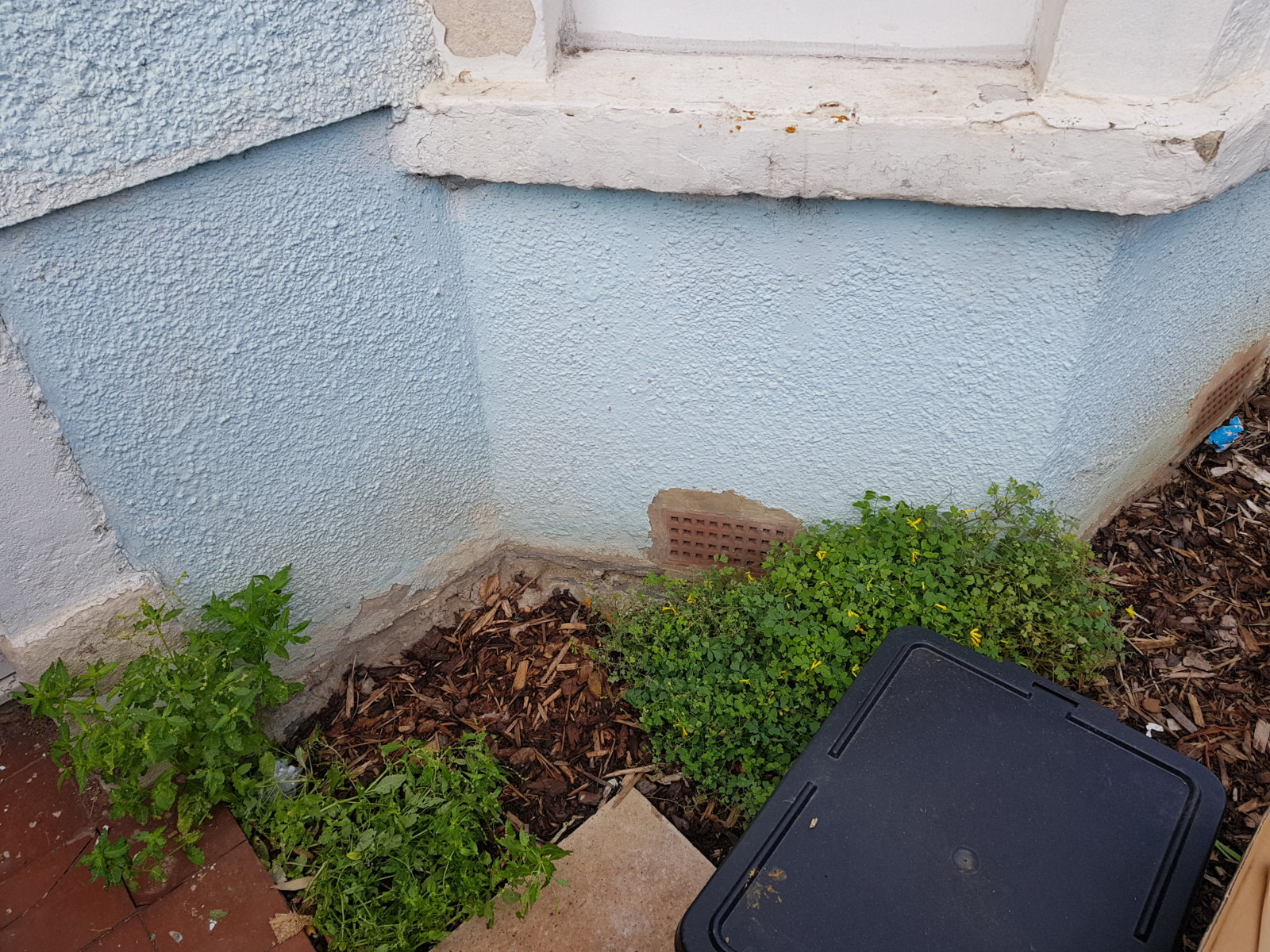

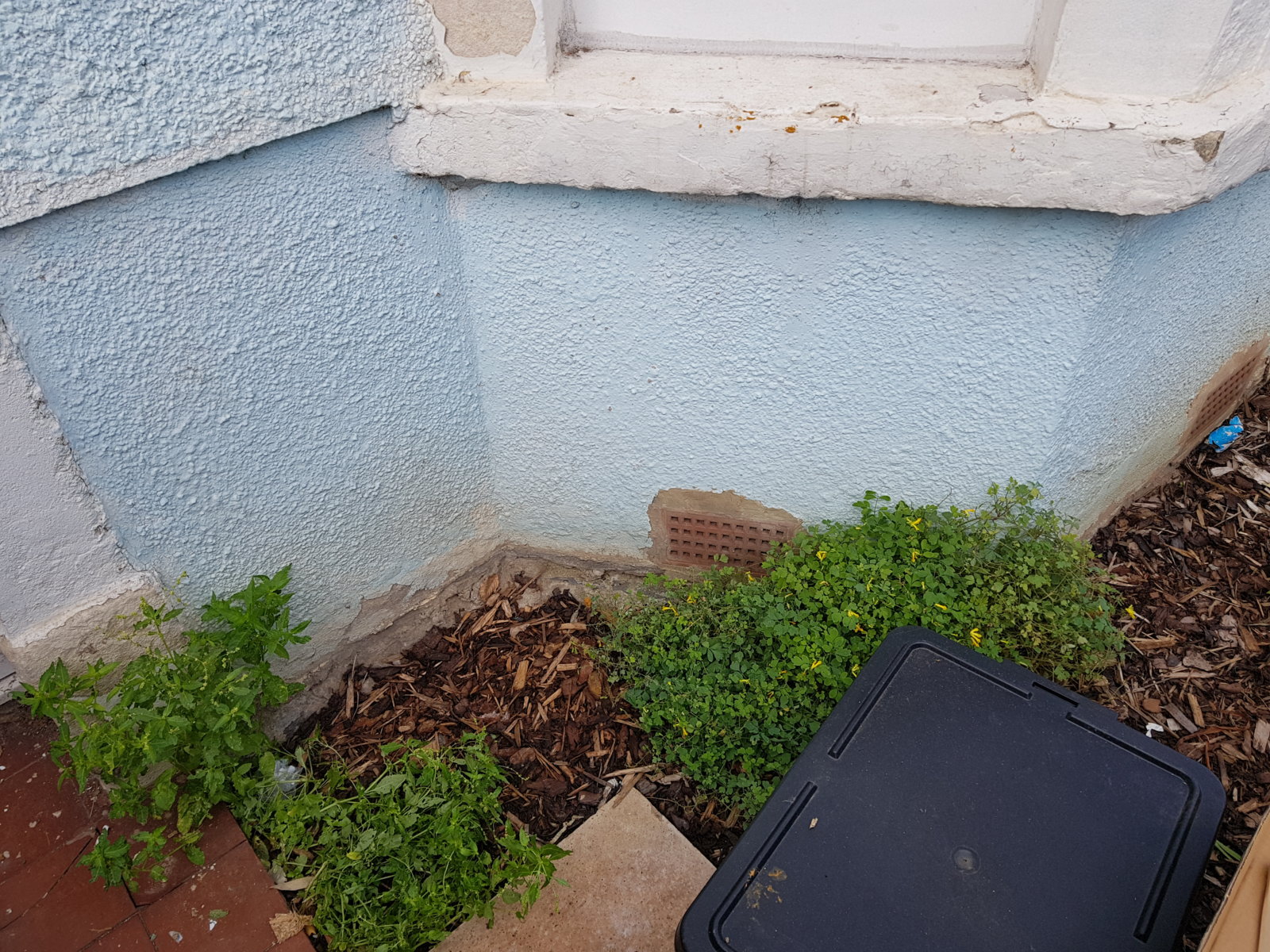

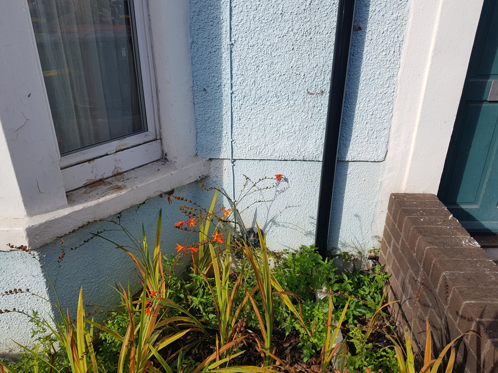

Also here is a view of the outside, with 2 of the 3 airbricks and the gutter in the corner.
JohnD a leak has not been ruled out, still need to go round the neighbour's house to check what's happening at her end, but she is not home
H2Gizmo I am starting to think it is more penetrating damp than rising damp. We have these three air bricks outside, retrofitted. They are quite in line with the floor level inside , rather then being below. It doesn't feel like air is free to circulate.
Further, the gutter at the corner looks like it is a bit undone on the elbow, so it could be that it leaks slightly when it rains, making the whole front garden damper than it should.
Finally, upon ripping up of the whole floor, the situation all along the external perimeter is not great and the soil is damper than you would think.
Our next steps are therefore knocking at the neighbours to inspect for leaks at her end, making sure the gutter elbow is not leaking and building a french drain all along the external wall.

1. air bricks above the floor line are useless. sub-area through ventilation from front to the rear of the property is necessary. best practice has air bricks set between the joist tails bays and at min of 150mm above ground level. the 150mm is not always possible.
2. your external render should not be in ground contact, esp as you might have solid walls.
3. the garden wall butting up to the house could be causing penetrating damp in that area.
4. your new pic shows a down pipe and a drainage piece presumably taking rainwater to either a sump or simply spreading it in the garden.
5. all RWP connections must be firmly fixed and leak proof.

The rank undergrowth shows the ground in that corner to be very wet. Stand back please and show us a wider view of the walls, gutter, roof, and especially of the gulley (or pond) that the downpipes gushes into.
No doubt the gulley will be cracked, leaking or blocked.
The downpipe may be as well, since the damp is quite high.

4. It's actually taking rainwater onto the sidewalk and then he water runoff onto the street, pretty common setup on the whole street for every house
5. We believed that the bottom bend was perhaps leaking but it looks to be sealed

I've attached more pictures, in order:
A. Showing the opposite corner of the external wall, not as bad as the corner in object, but it's quite damp here too
B. Overview
C. View of down pipe
D. View of the airbrick / garden from the other angle (just outside picture A.)

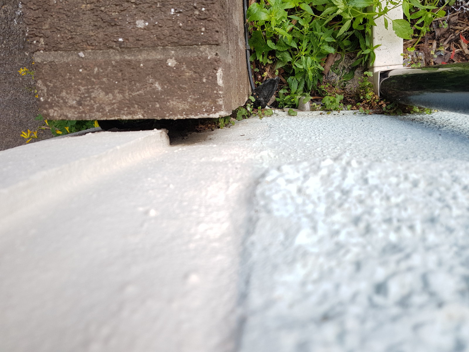

E. Picture from above of the party wall with e neighbour ( point 3 above), it is actually detached from the building
F. Another view of the damp corner in object

Hi JohnD, as mentioned the downpipe is offloading onto pavement / street.
The gutter / down pipe has been replaced last year, damp was already present before that and damp is still there, so probably it is not gutter / downpipe related.

the gap at the end of the garden wall needs cleaning out.

if the down pipe and "gutter" were replaced, why two different materials round and square?
I wonder why the garden and the wall are so wet next to the downpipe.

Well, that is a very good question! The black round gutter is the new one, builder wanted to complete the job but we told him not to, as it was in our plans to re-do the front garden at some point and we were potentially going to do a little trench to accommodate the final bit of the guttering. We haven't come round to do that.
