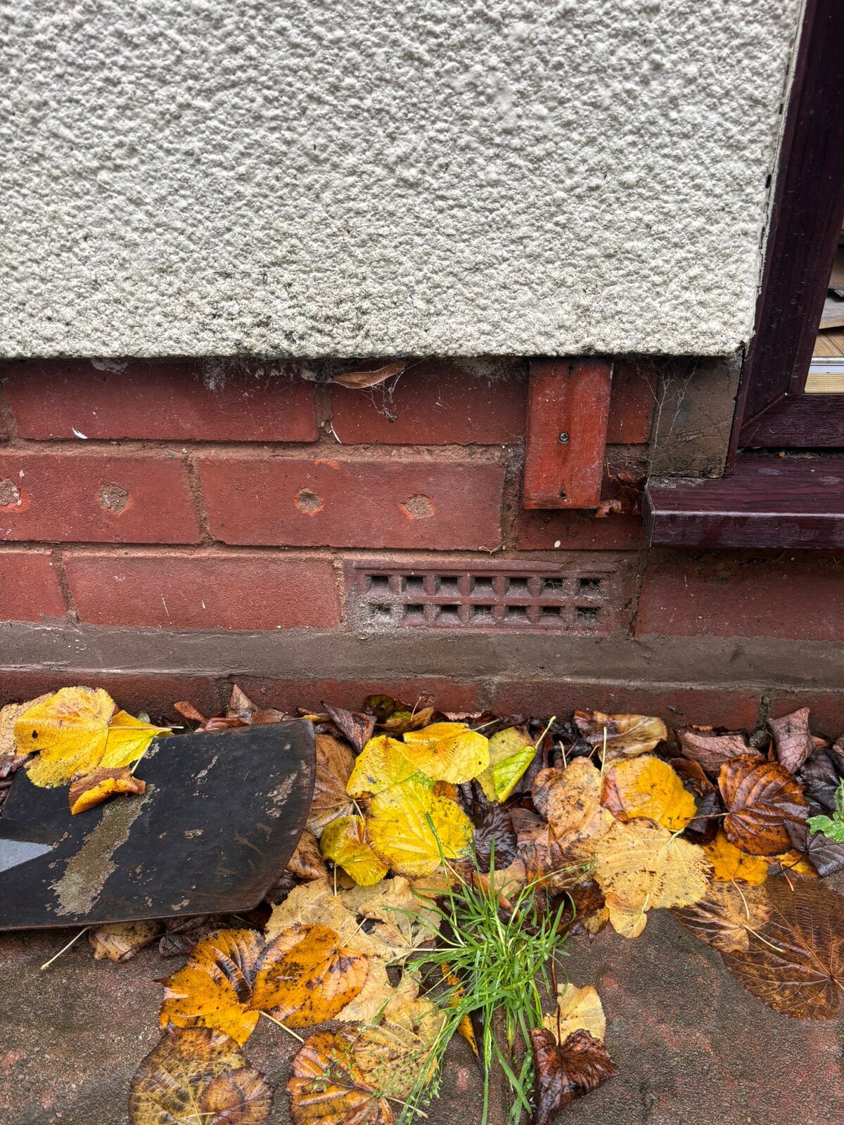

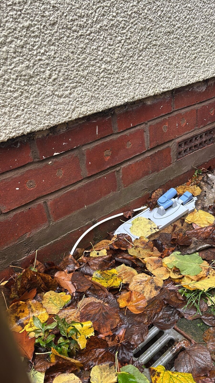

My daughter's house has started showing damp in the hallway that's just inside the front door. She sent a picture of the outside of where the damp is showing and one out the back.
Does that look like the damp proof course has been cemented over and might be giving the issues, or am I reading it wrong?
Thanks.

That line of cement does look unusual.
Would be good to see a pic of the damp inside.
OP,
The thick bed of mortar could be the DPC - using thick bed mortar for a DPC often fails in time.
A previous go at injecting a chemical DPC has been attempted.
Is that an Aco linear drain showing in pic one? What is the white plastic device?
Given the air bricks then it suggests a suspended floor - hence the joist tails sitting in wall pockets will be at risk of rotting?
The brick bonding suggests a cavity wall.
Tomorrow examine all around the external & the internal perimeter of the house - take interior & exterior pics.
I think it's just a length of cable and part of a mop.

Need better pictures of outside up to gutters. Strange piece of timber screwed to base of brickwork by door.?
Oh yes I never noticed that.
I've no idea, it's an old house that previous couple lived in for decades.
I would suggest that if the problem has only been observed after the bathroom works this is the first place to look.
Is there a gap behind the render? It looks as if the place has been battened out and maybe cut away to do the injection as you'd normally see a drip bead at the bottom to kick any drips out away from the wall face.
The wide strip of mortar isn't original: someone's idea of tidying up the dpc.
Check the aco is draining away freely and not backing up during heavy rain.
Pour a couple of buckets down in that location and see what happens.
I went down this morning and there was a last a 1 inch deep pool around the blocked drain channel and up against the house wall along with dirt and leaves.
