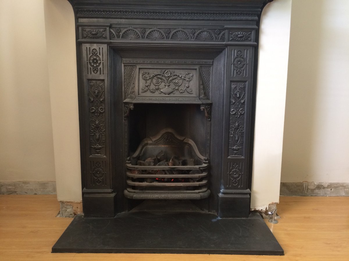

Hi. I'm wondering how I can solve my damp problem in the living room.
It's about 12 inches above floor level along an internal party wall of a terraced house built in 1895. There's no staining, mould or effluorescence just a darker area of paint.
It's two rooms knocked into one with two chimney breasts front and back. The damp meter readings reduce towards the centre of the room so I'm thinking it's to do with them. One is open with a DFE gas fire and the other has been blocked and plastered over with no air vent. I know it should have one but it's been like that for the 20+ years I've had it and it's only in the past year I've noticed the problem. Also the front of that breast is less affected, it's far more obvious on the side and front of the chimney breast where the fire is.
I had someone out last year who said I needed my chimneys capping, which I did, but nothing has changed.
It's a large well ventilated room, no damp clothes drying out and no leaking pipes. I'm changing the skirting and the nails and screws coming out are rusty and the brick dust is damp. I've got a laminate floor down so can't get underneath but it seems well ventilated as I can feel the draught at the edges.
My neighbours say they don't have a problem (their chimney breasts have been removed).
Any suggestions? Thanks

Its possible that the soil infill below the hearth is the source of your moisture. So i would very closely examine the other side of the chimney breast and party wall.
Your floor joists might run into that wall & will be trimmed around the hearth.
The trimming and the joist ends seated in the wall might be at risk of rotting so its best that you go below the floor and examine the situation around the hearth and chimney breast. Probe all the woodwork. You might have an access hatch under the stairs.
A posted photo of the full fire place and chimney breast might help.
Does the flue have through ventilation from behind the deco fire through the stack terminal?
When was the flue last swept?
You have a Restrictor Elbow and an old style gas isolator on the gas supply pipe: only the Restrictor is usually needed.
The other, blocked, chimney breast and flue should be opened at some convenient time and swept & vented top and bottom.

There should be ventilation above the deco fire - shine a torch up the flue.
The other chimney breast should be opened and swept.
A photo showing the outside wall where the leaking gutter has been dripping might help. I suppose you are getting the gutter fixed?
You would have nothing to lose by going into the loft and examining the loft chimney breast for damp or stains.
Sorry for asking a dumb question but when you say 'ventilation above the fire' what do you mean? It's wide open and goes straight up the chimney.

The simplest approach for you would be to sweep your chimney breasts and vent the blocked opening.
Hack off all stained/damp plaster for 1m ht. and render in a 3:1 sand & lime mix.
