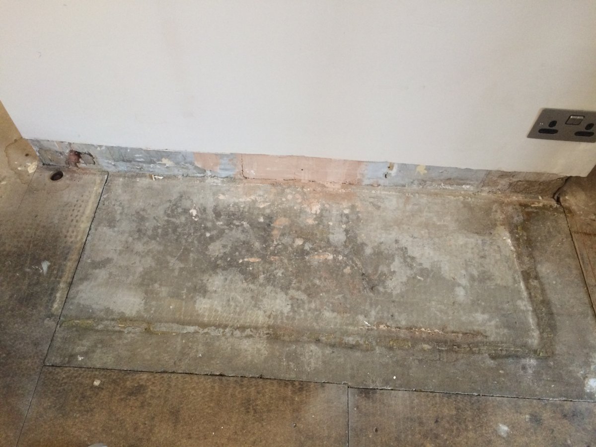

Attached is a picture of the hearth area, do you know what material it is? It's reading damp. If I dug it out how could I damp proof it? Won't it just rise through the brick surround? Thanks

Good, in your case an Independant isn't needed.
AAMOI, be cautious about using the "Damp Meter"
I'm confused with the two different c/breasts that keep appearing or being referred to.
Is the last hearth shot the c/breast of concern or are both showing damp signs?
The front hearth is concrete, & you can crack it out with a breaker.
If you are handy, a carefully judged few whacks with a sledge hammer will splinter the concrete - start near the back not near the flooring.
The fire place must also be opened up and the back hearth cracked out as well.
Once you have done that & cleaned up all debris then come back here.
Be alert to any gas pipes or elec cables in the area.
I put this photo up because the other still has the slate hearth on top. Both are showing damp - it spreads from them outwards towards each other but doesn't meet. I know to be wary of taking meter readings as absolute measurements but because they reduce the further you go isn't safe to assume the relative aspect of it?
When you say 'back hearth' do you mean the base of the fireplace within the chimney breast? Thanks.

I know this post is two years old, but your issue is exactly my issue. I’ve hacked the old concrete hearth out that was in the floor, and opened up completely the other chimney breast.
All damp still there, and surveyors saying rising damp with a chemical DPC, they said no need to hack the plaster just the bit around the chimney breast that we have just opened up.
I’m hoping the original poster can give us an update on how they got on, did you get the DPC done and did it work?

Do these "surveyors" happen to work for companies that sell chemical injection?
There aren't many houses left that were built without a DPC, and chemicals will not cure water leaks. Neither will they ventilate subfloors whose airbricks are blocked.
We had another poster recently who dug out the damp material under his hearth so the area could be ventilated and dry out.

There’s deffo no water leaks from any pipe works under the floor in that area as none run along that side nor in their house and doesn’t appear to be any damp patches on the floor underneath (we have suspended floors) and some sort of concrete base where we worked.
next door on the party wall have no damp issues there side either.
The company is a family run business and there surveyours are in house and do all sorts off work not just Damp related stuff, very good reviews on check a trade, that’s as much as I know for the company. I did get two quotes and both said rising damp - chemical DPC. One wanted over 2k and the 2nd no where near that price and issue a 20 year warranty.
The airbricks ain’t blocked and there have been extra ones put in many years ago to allow increased ventilation (the only issue I know previously from a burst pipe from the neighbour they had to get the wood treated? There’s prob more but he denied any knowledge, so who knows if his telling porkies or not)
However when changing the floor boards as they were no good we established that 8/10 joists were rotten and had to be replaced as they was just no good. One of the joists run along the old hearth base and was wet most likely from rising damp, we made sure we put new damp course down on the new joists and lay DPC on the hearth bricks as well as removing the wet material off the party wall below what looks like the DPC and it’s still showing the same High readings?
Surly if the company offer a warranty, and I still have wet walls, what actually happens?
Do party walls contain DPC? It’s a 1950s built property.

read the terms. Their "remedy" might just be to apply more chemical.
