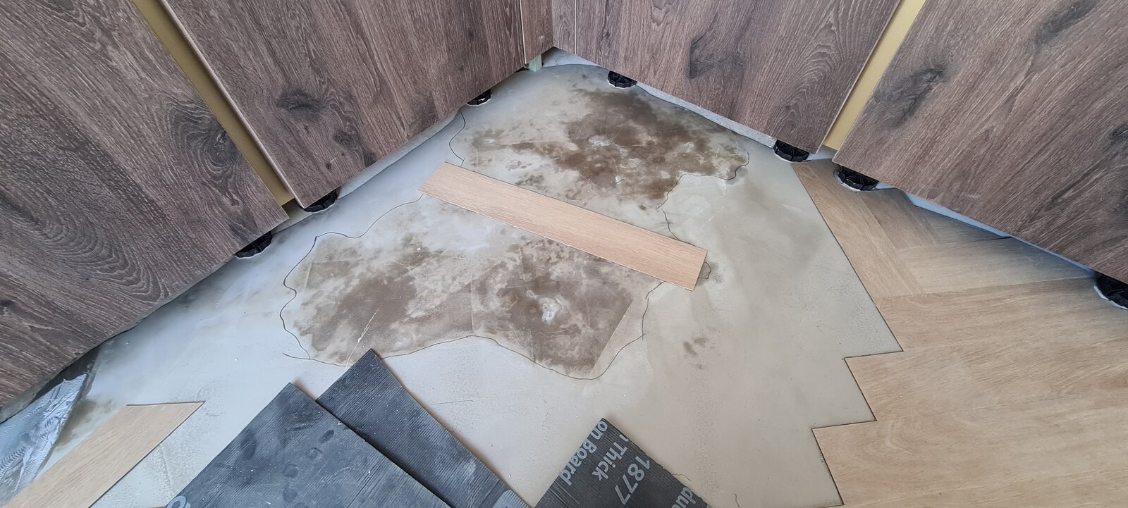

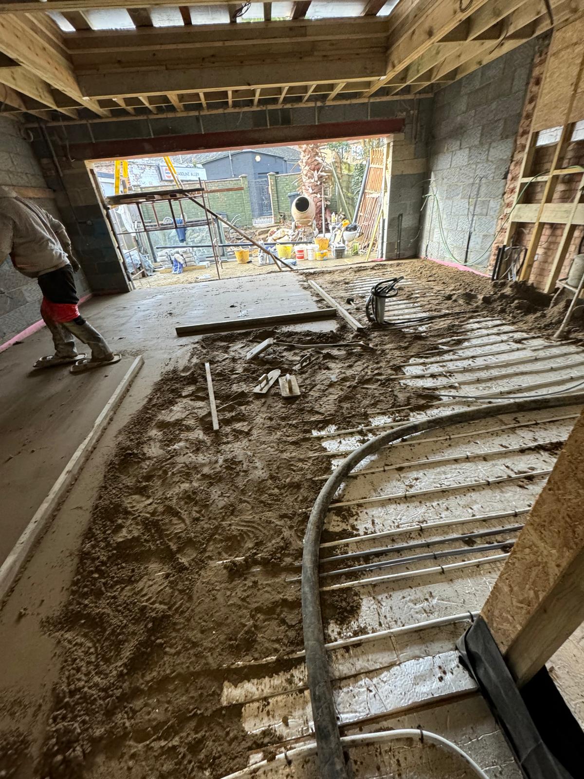

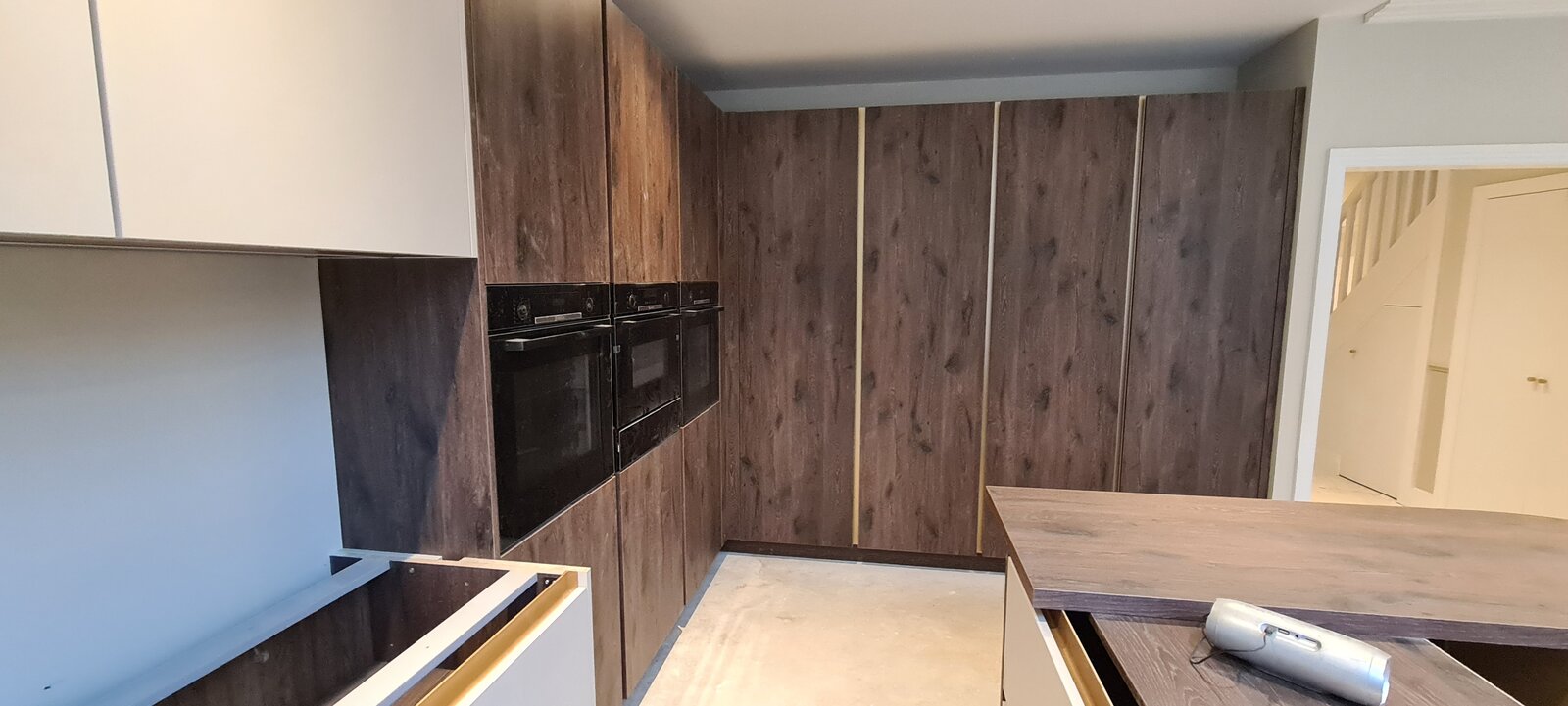

Hi, we're currently reaching the final stretch of a home renovation. We've had wet underfloor heating put in on the ground floor which was left on for a couple of months at around 20 degrees. Below the UFH the builders put black sheeting and insulation before covering it all with a concrete looking screed... you'll have noticed so far I'm not completely up on terminology/names of things... but here's a couple of photos:
We then had our new kitchen go in:
A separate business (not associated with our builders) then came in to fit LVT herringbone style flooring. They asked for the UFH to be switched off so they could put down a self-levelling screed and then left it for a couple of days to dry before they laid the flooring. At some point on the first/second day, a damp area started to appear in the corner of the room after they were about 70% of the way through laying the flooring:
We were wondering what may have caused this? We don't believe that the underfloor heating pipes are damaged as it's a pressurised system and the boiler is showing no drop ion pressure. The builders are blaming the flooring company, who have admittedly done a bad job of laying and finishing the flooring, however I can't see how they might've caused this damp patch?
Has anyone else had experience of something similar happen and do you know how it might be resolved? We'd like to stay away from painting on a damp proofing sealant if possible as to us, that would just mask over the problem.
The damp patch has dried a little over the last week, but probably because we've had the UFH turned back on, now looks like this:
See the original pencil line from where it used to be... also, if we lay one of the LVT planks over it, after a while it forms a damp patch underneath in the shape of the plank.
So any ideas of the cause, how to fix and who might be responsible for fixing it?
Many thanks!

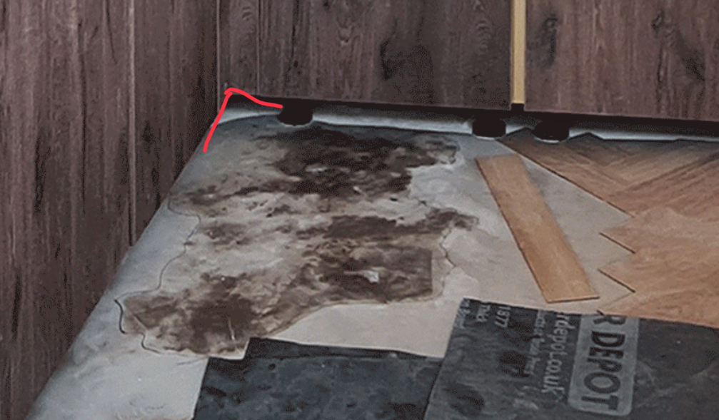

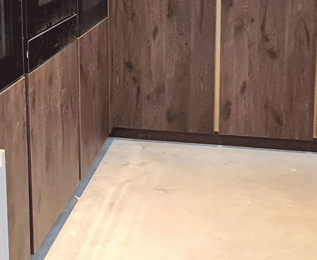

When going back to review the millions of photos I've taken throughout the reno, I noticed some darker 'marks' here in the corner, and then created a gif before/after as below, which seems to show the dark marks line up with the damp patches.

No leaks from above, this is a new extension after the builders removed the previous one and the ceiling is brand new... moisture is definitely coming from below. Only other pipe under the floor is the waste pipe (see first photo from my original post), but the kitchen and utility sink haven't been finished yet re: plumbing, same with the washing machine, which hasn't been switched on, in the utility room.
Only thing I'm thinking it could be is that the black sheet layer under the insulation has failed to stop moisture from the ground from coming through?
Re: not putting the self-levelling screed to the corners, the flooring guys couldn't as the builders wanted the kitchen in first... and as for the the GIF (I'm a graphic designer by trade), I thought it'd be a good way to show the before/after, and that there are what look like dark (damp?) patches before the self-levelling screed went down, so hopefully our builder will agree that it's his problem to fix!

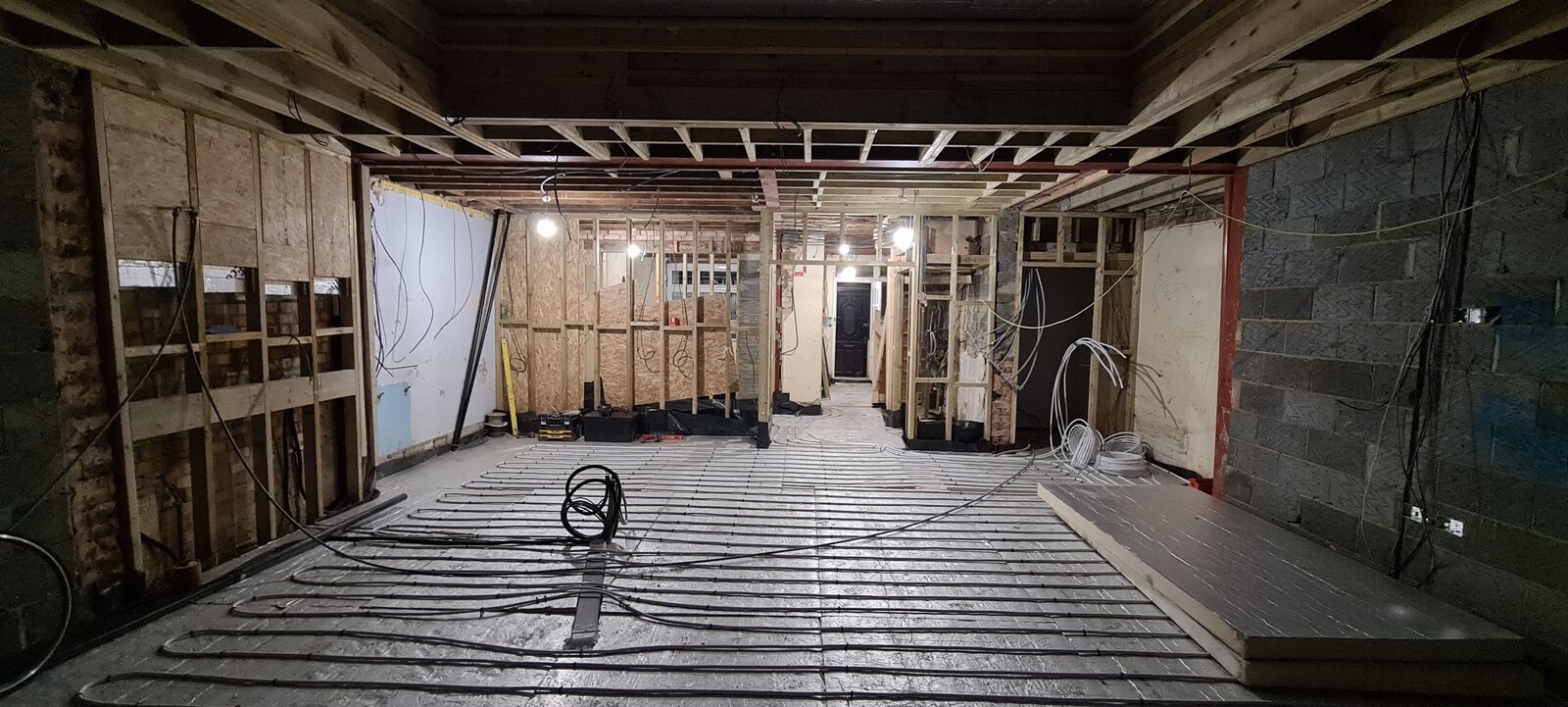

Any pics of the UFH in that corner

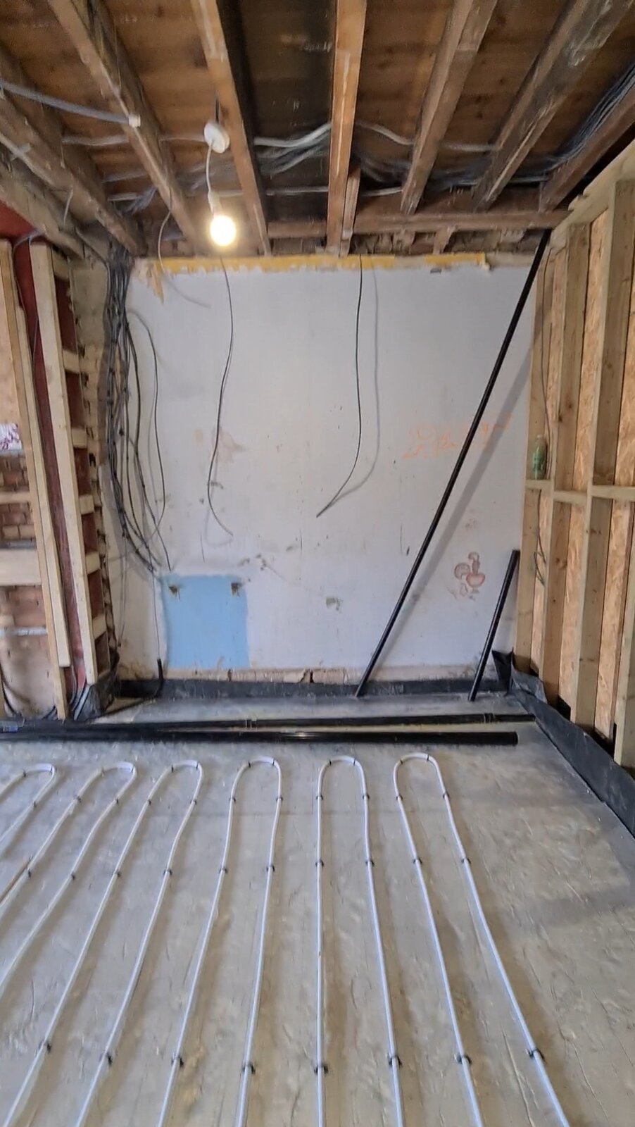

In the first photo is the best picture I've got. The back wall in that photo is where the units on the left hand side are in that gif...
Here's another shot of the UFH laid out in case it's helpful?
If looking at the first image (and I've got the correct orientation) there appears to be a black pipe/conduit running through the floor... looks large-ish diameter... do you know what it's for? water or electric?
Hi @Mr Chibs. That's the waste pipe running from the utility room, which hasn't been used. Plus it's set back further than where the damp patches appear.
The ufh looks good. Going to speak to my ufh specialist tomorrow. I’ll show him the pics.
