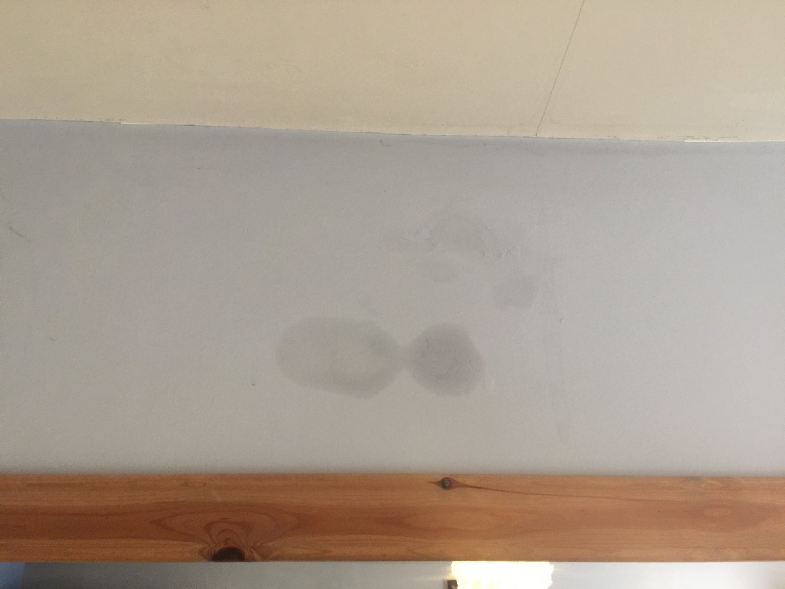

Hi all,
Not sure where the best place to put this query was, apologies if not the correct forum.
We've had a damp patch above our fireplace for over a year now, it hasn't changed shape or got bigger. I've had a pointing guy come round thinking that it was an issue with the chimney but he didn't seem to think that would be the issue.
The fireplace is in the living room and the chimney breast protrudes in to the kitchen, please see pictures below.

siross85, good evening.
The image posted? has it been rotated by 90 degrees? if so the damp marks are in the kitchen ?

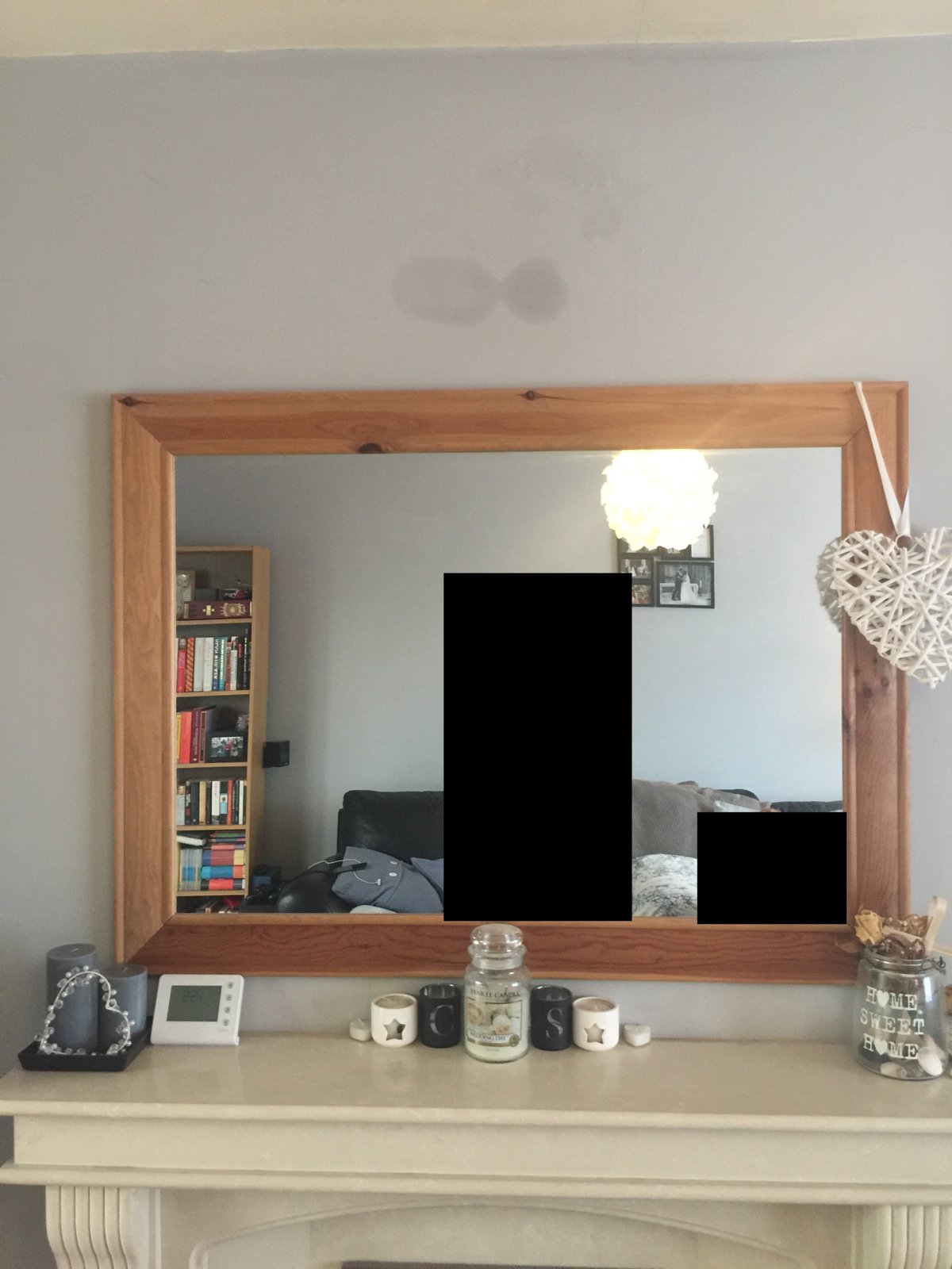

No the image hasn't been rotated, that is the where the blue wall meets the white ceiling, the wood is the frame of the mirror hanging above the fire place. The damp marks are not in the kitchen no, they are in the front room. Please see further picture below.

Hi Ken,
Please see answers in the quoted message above :)
Thanks for the reply!
They look typical of straining from the flue. If they feel greasy, most probably so.
If so you'll need to hack of the plaster and coat the wall with a stain blocker.
Thanks for the reply.
Just felt it and can't really feel a greasy texture. The paint did come off in my hands a bit.
Assume hacking off the plaster would need me to get that part of the wall replastered?
Is there any risk of it doing any long term damage.
If not treated it just remains or extends, as more salts leech out.
Yes, although not just someone masquerading as a plaster who just knows how to skim plasterboard.
The wall will need to be coated with a suitable product too. You'll have to research that unless someone here knows one.
