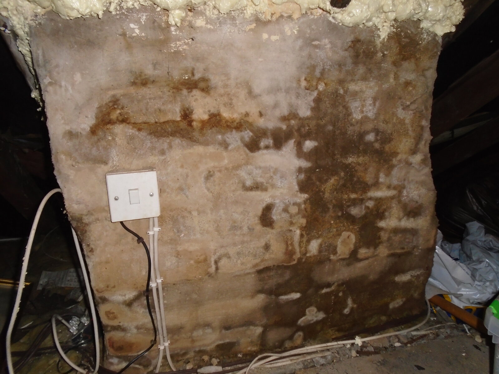

I guess the first pic is the stack in the loft? It sure looks fairly damp and this can be confirmed by a cheap damp meter available from Toolstation or whatever. If it is, this must be coming from above.

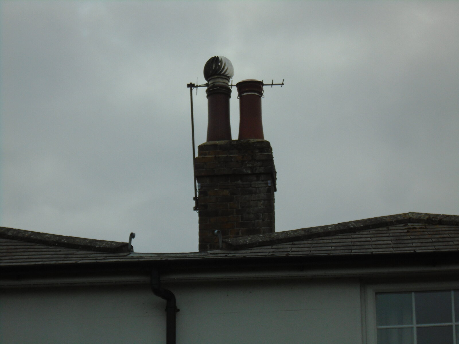

Looking at the chimney stack, it does look as if the pointing isn't the best up there and of course we can't see the flashing or flaunching. Where the bricks project there could be some slate 'soakers' which prevent damp coming down but of course there could be pointing issues below this. Do you know any good builders near you who would give you honest advice?
Finally.....you have two fireplaces down below and one in the bedroom above - but only two pots are visible on the stack. Is this correct?

you dont need any kind of meter. stay away from all of them. you have obvious damp on the loft chimney breast, possibly penetrating from the flue and just running down the outside of the chimney breast, the foam you can see might have been an attempt to stop the leaking from thestack flashings.
The stack pots have a rotor vent and a colt 316 cowl, why, whose idea? did you have aproblem with a downdraft in the open fireplace? the pots for the upstairs fireplace flues havebeen removed. the stack looks shot. pics needed of the stack, the flaunching and theflashings.
The dip between the hip irons has been flashed with sheet lead without any clips showing?

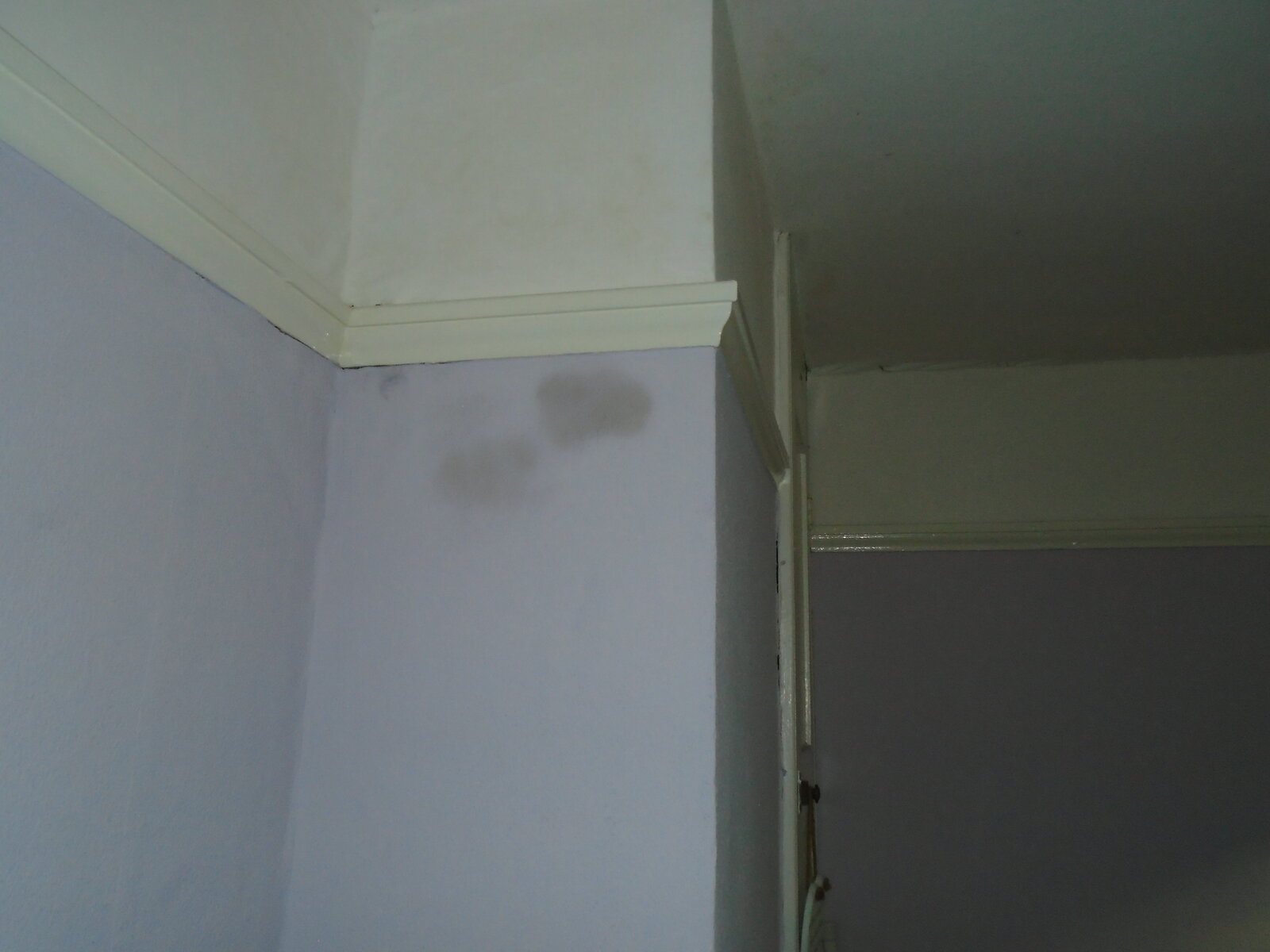

tell80 ...thank you for your reply too. We had the cowl put on as yes there was a problem with the downdraft and the cap was put on recently because naively we thought the rain may be going straight down and causing the damp. It is well ventilated though. There is only one chimney breast left upstairs but it's just a wall now with the 2 damp patches at the side (please see photo). I have heard of soot chemicals before but not sure if that's the case - it could be, although the sweep was only here a few weeks ago and we have only just moved the furniture that was in front of the damp spots so there's still time for it to dry out I suppose. It's getting quite depressing now!

Thank you all for your replies -you have given us lots of avenues to go down and opened our eyes up to the possible solutions. I think we'll spend today looking for the right man to come and view. My husband is leaning towards the condensation theory but I am almost certain it's a problem with the chimney stack from what you have all said. Thank you all and have a great day today.
There could be issues with contaminated bricks and hygroscopic salts. Not every chimney stain problem can be attributed to outside water ingress.
