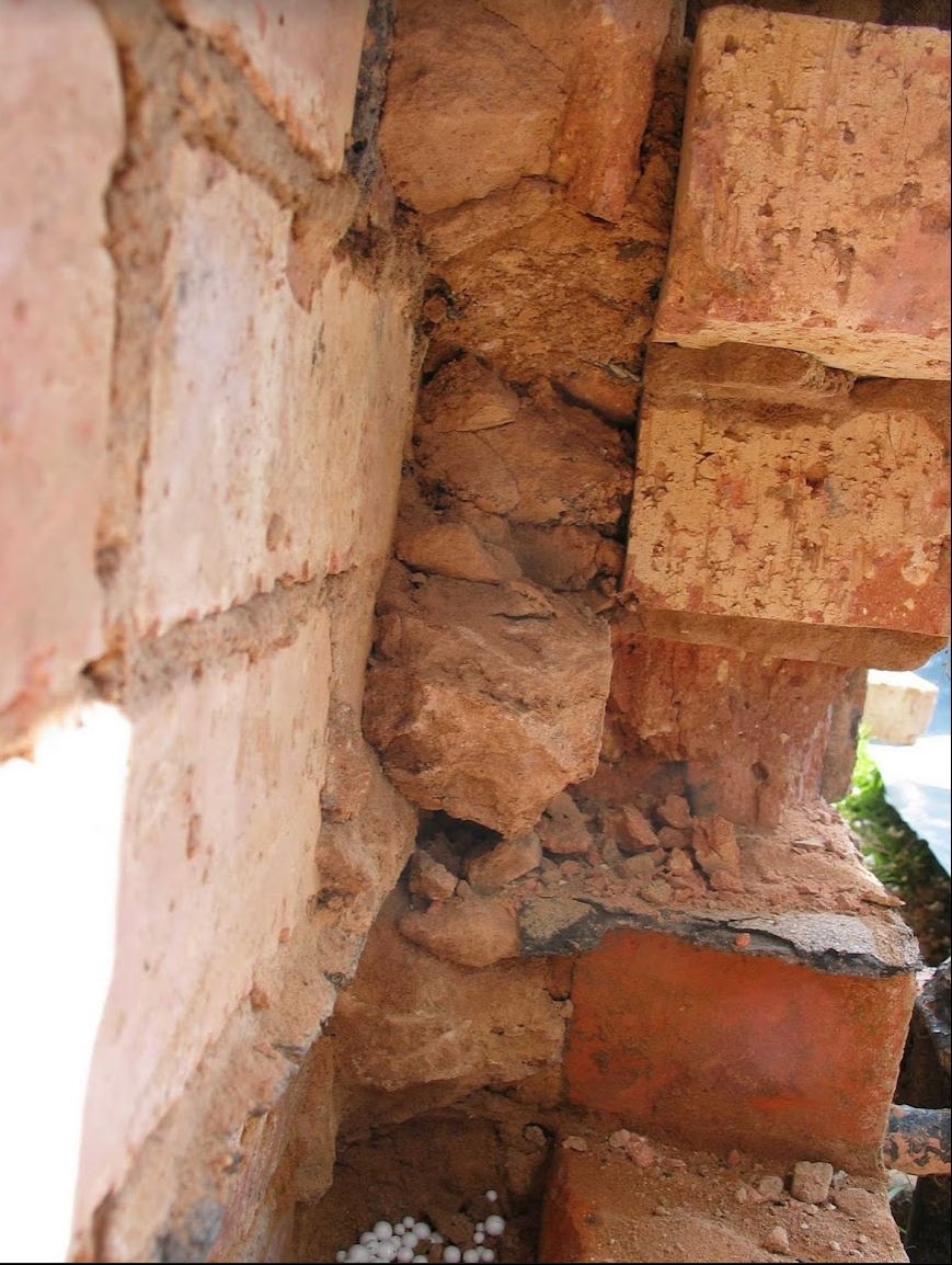

I have removed some bricks to clear the cavity. I have seen the slate DPC in the wall and I can feel the slate DPC in the cavity. I have taken 4 rubble bags of sand and loose mortar out of jsut two separate holes in the wall so far
The inside is a solid concrete floor. I guess it replaced a suspended wooden floor (originally 1930's house). The concrete floor feels dry. I can see the membrane of the concrete poking through the edge of the floor slightly. It feels damp between the mebrane and the wall.
I'll send some photos
Well done, you jumped the gun with opening up to clean out the cavity bridging - I was going to suggest that as a possibility.
With the any new pics can you add pics of where you've opened up for the cavity?
Here one cavity
That looks like a clean & clear cavity, thats great so keep going.
With a torch and a small mirror you will be able to see further up and down the cavity look esp. for snots on cav ties,
Well done in clearing the cavity
I found it easier to remove one corner brick on the outside, and rake the rubbish towards me. A builders canister vac will suck out the loose stuff, you can buy additional metal extension tubes to increase your reach, and poked into sand and mortar, they will break it up enough to suck it out.
or a cheap borescope plugged in your mobile phone - no need for 1930's technology

Stay away from removing corner bricks but under windows is doable.
Try and first take out the course sitting on the DPC or from a course a little higher.
Removing six bricks should give you ample room to work in.
