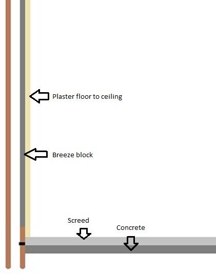

I have acquired a detached property which was built in '62, and has damp at the bottoms of pretty much all the internal walls. Initially suspecting DPC failure, after much digging and removing I discovered that the DPC is very slightly below the level of the screed. Adding to that there is mostly floor to ceiling plaster. There's no evidence to suggest the DPC has failed, but it is brittle, perhaps bitumen?
A test dig into the screed at the edge of the main reception room shows it is about 35mm thick and there is no DPM between it and the concrete below. I assume that layer of concrete has a DPM underneath it, and sits on top of the raft on which the house is built.
So how to proceed? I was thinking of removing the screed, laying a DPM (sheet or liquid) and getting a new screed put in. Should I inject a new DPC one brick higher and tank to it?
I attach a very badly drawn diagram which I hope might help.
