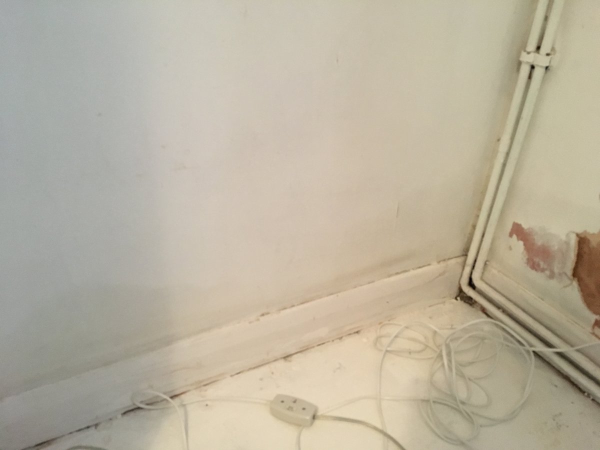

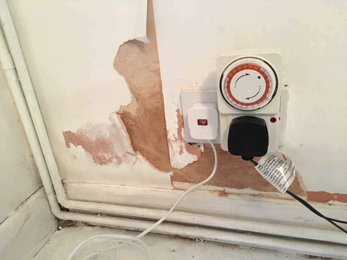

I live in a 1890's terrace house and seem to have a small damp issue at low level on an external and party wall corner. It has been like this since I moved in to the house about 4 months ago (surveyor missed it as there was a bookcase in the alcove).
The main problem area is only about 30cm high and about 30cm wide. Here the lining paper was very slightly damp to the touch and came off easily. This is on the external wall. This is the photo with the sockets in.

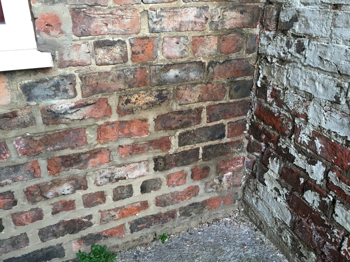

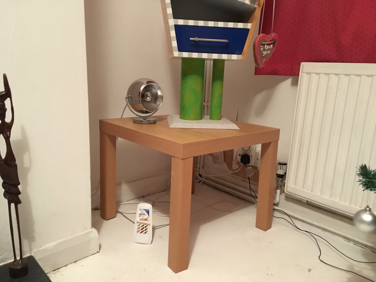

On the adjacent internal wall there is some slight discolouration to the paint at about 20cm high, but it feels the same as the rest of the walls and the lining paper isn't going anywhere. See the other close up photo.

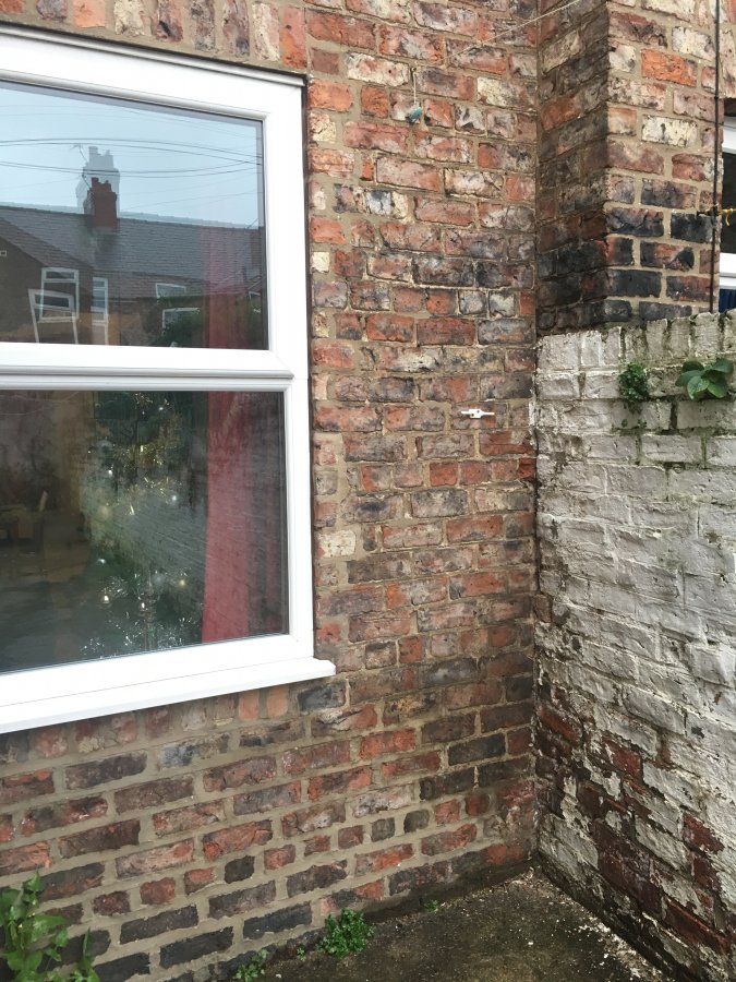

I'm assuming this is rising damp, although there seems to be a damp patch on the outside of the wall but higher up. Perhaps this is a red herring?

1. Is the floor solid or suspended? It appears to be level with or lower than the ground level outside?
2. The wall is solid and the Remedial treatment company should have used a render not gypsum plaster in any re-plastering work.
3. If you probe the mortar beds you might find a slate or bitumen DPC behind the smeared on pointing.
4. Notice that some attempt was made to point up the lower brickwork (probably the Damp company's idea of Remedial work) - all that rear elevation, and the adjoining yard party wall, need raking out to 25mm and re-pointing.
5. The party wall is butting up to the main elevation and most probably bridging penetrating moisture into your rear wall.
6. Why not show pics of the whole rear elev. and the top of the party wall?
7. All affected/stained plaster will have to come off to say 600mm height and be rendered with a sand and lime mix. Plaster/render should stop 50mm shy of the floor - no contact.
8. Skirtings will have to be removed.
9. The outlet is at risk of damp arcing - (& its overloaded).
10. Is the chimney breast ventilated top and bottom? Was it swept before blocking up?

6. Photo.

9. I understand the damp arcing but not the overloading? At the moment it just has a table lamp and a set of xmas lights on a 24hr timer plugged in.

In order of likelihood, I'd put my money on
1. That garden wall causing lateral moisture movement.
2. A leaking gutter
3. The stack - with or without nr 1
4. The paving level - associated with nr 2
And potentially the pointing above the damp area
1. The lowest course in the pic is half buried so any chemical DPC (FWIW) should have been inserted in the higher bed or brick - allowing for the re-pointing, there's no sign of any holes in the pic?
As above, the external ground level appears to be too high esp. if the solid floor doesn't have a membrane (DPM).
If you remove the skirting in pic 2. then any membrane will be revealed.
2. DriCoat and Renderlite are fine - but what the D&T Co. specify & what they use are often two different things.
5. As above, the yard wall is a probable cause of penetrating damp - there are ways of isolating yard walls from main walls.
Besides re-pointing it needs coping stone cappings.
Matching vertical injected DPC's can be taken to the top of the yard wall (injected both sides of the wall is best) and the main wall - but again, its a matter of what they are worth?
10. The neighbour's external chimney breast is bleeding dark sooty chemicals - these have spread on to your brickwork - making it possible that you will have to hack off and render higher up on the inside surface.

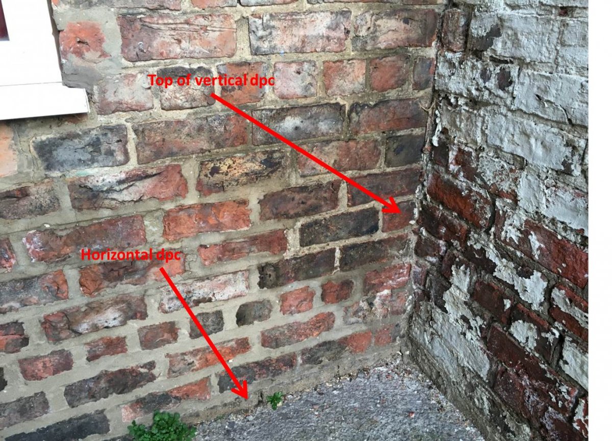

With a membrane in place then its likely that the damp is a combination of penetrating damp from the outside and rising damp coming up in the wall through the remains of any previous damp courses.
Can you point out on a pic exactly which bed or course of bricks the injection DPC holes are in?

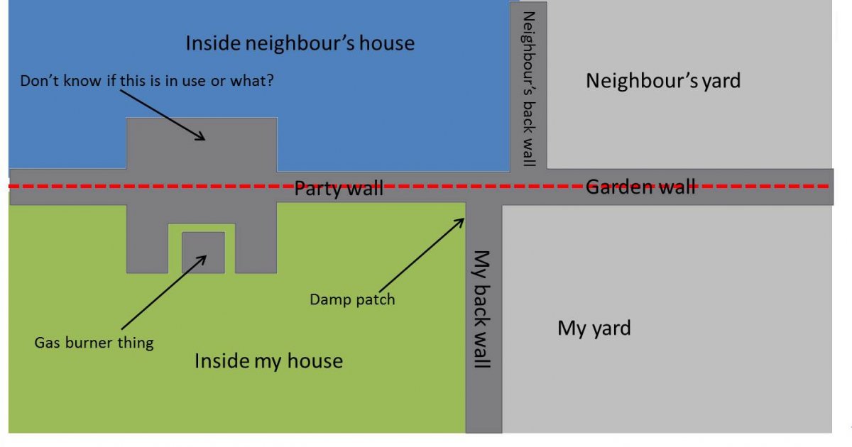

Hi Vinn
I have added an arrow to the photo above showing the dpc. It is only in this corner that the it is half covered.
I don't think I've been explaining the chimney/wall interfaces well, so I've drawn a quick sketch on the computer showing a plan of the walls. This should clear it up.

Injected DPCs don't work.
The outside ground level is clearly too high.
1) Lower ground level by 8 inches.
2) Wait a year to dry out.
3) Replaster if necessary.

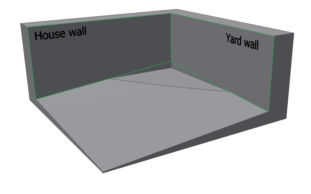

The whole yard slopes to the drain which is on the kitchen wall. The area in question has quite a sleep slope so I could convert this to a gentle slope by taking about 100mm off the top corner and gradually making the reduction smaller until it there is no step over about a 500mm square. Does this make sense? I've sketched it out below:
This would make it so the outside was at least 1 course lower than the inside all round.

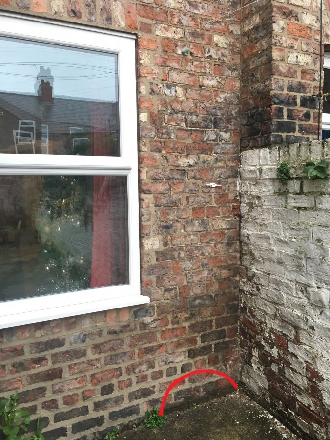

Any damp from raised paving can be dealt with by coating the wall externally with a water repellant, rather than messing about with paving levels.
The position of that damp patch higher up the wall in the lastest image, shows that the issue is not related to rising damp or splashing. And the apparent dampness of that boundary wall supports this.
Could you live with gravel instead of concrete?
Definitely - I only moved in at the end of last summer and have been thinking of easy ways to hide the concrete as the yard is pretty big and all covered in it.
The damp on the inside of the house is below the visible damp patch on the outside wall. It extends from the floor about 30cm up (about 20cm above the top of the skirting board) in a rough semi circle. I've added where it roughly is to the external photo. It was raining when I took this photo so the whole thing looks wetter than it usually does.
I'm not sure if these are separate or related issues or if one is a complete red herring. I don't mind work so am happy to try different solutions I can do myself if possible.
