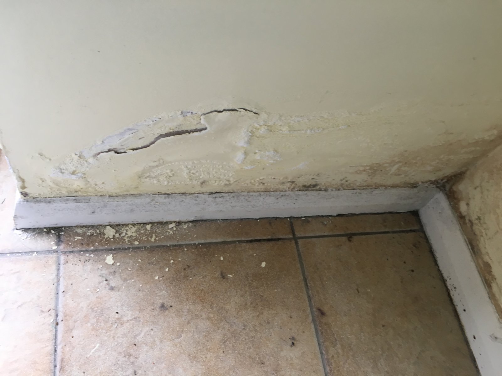

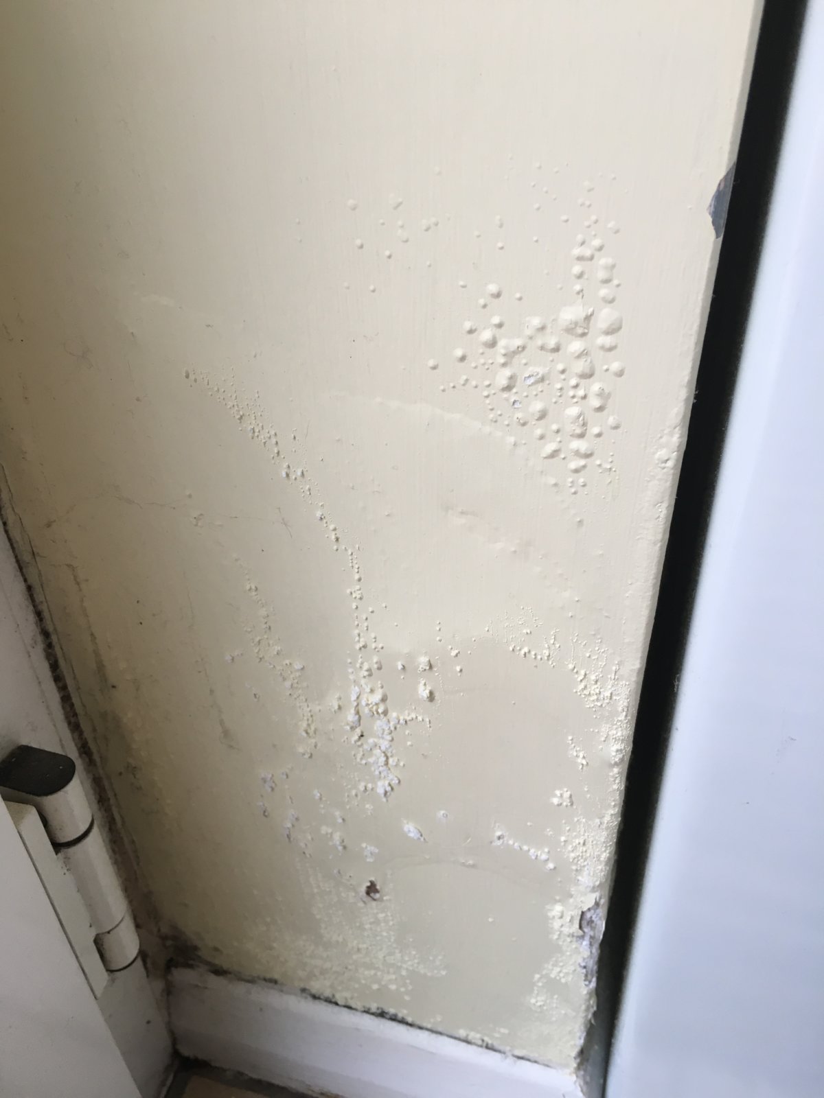

Hi, I have what I think is damp, it's in the Utility room in the extension, that was built in 2000, before we owned the property, we've been her 3 1/2 years.
It's near a tumble dryer that is vented outside, that is what makes me think it's damp, although it isn't wet, the property is a bungalow if that makes any difference and it had the same condition when we moved in, but we had the place decorated before we moved in, so the decorator took care of it.It's a conventional double layer brick wall and it has been insulated, I know this from when we had the outside vent put in.
I've added a couple of pictures. As you can see it's a bit Bubbly and loose, some of the paint has flaked onto the floor and if I wipe the wall with my hand it is a bit powdery.
How do I get rid of it and stop it coming back?
Someone said to use some Unibond PVA Adhesive & sealant, but I thought I'd ask here.
Many Thanks, Steve

A real good scraping down and clean off all the powdery residue and then give all the areas a coat of Zinserr and then fill areas and rub down and apply your top coats, but if you have a damp problem from the outside it will just do it again.

is there a water pipe or waste pipe buried in the wall, or on the other side of it, or a drain, or in the floor?
Very likely the damp is caused by a leak.
Paint does not repair leaks.

Forget about any type of paint because you would be wasting your money. You must first, find and rectify the cause of the dampness.

youve got penetrating damp - and maybe rising damp as well.
the skirting could be rotting.
ignore the nonsense about applying so called blockers and sealants.

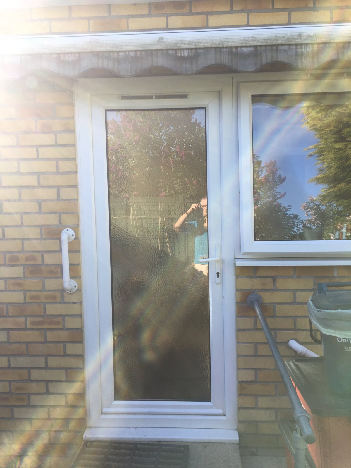

pics of the wall outside and how the door's sealed will help. the door appears to have been fixed wrongly in line with the face of the outside wall surface, it should be recessed a min of 75mm.

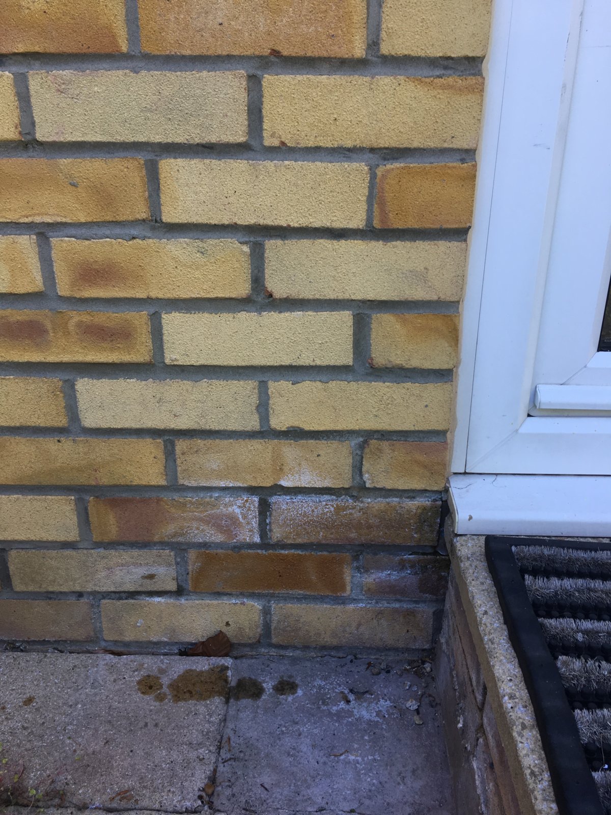

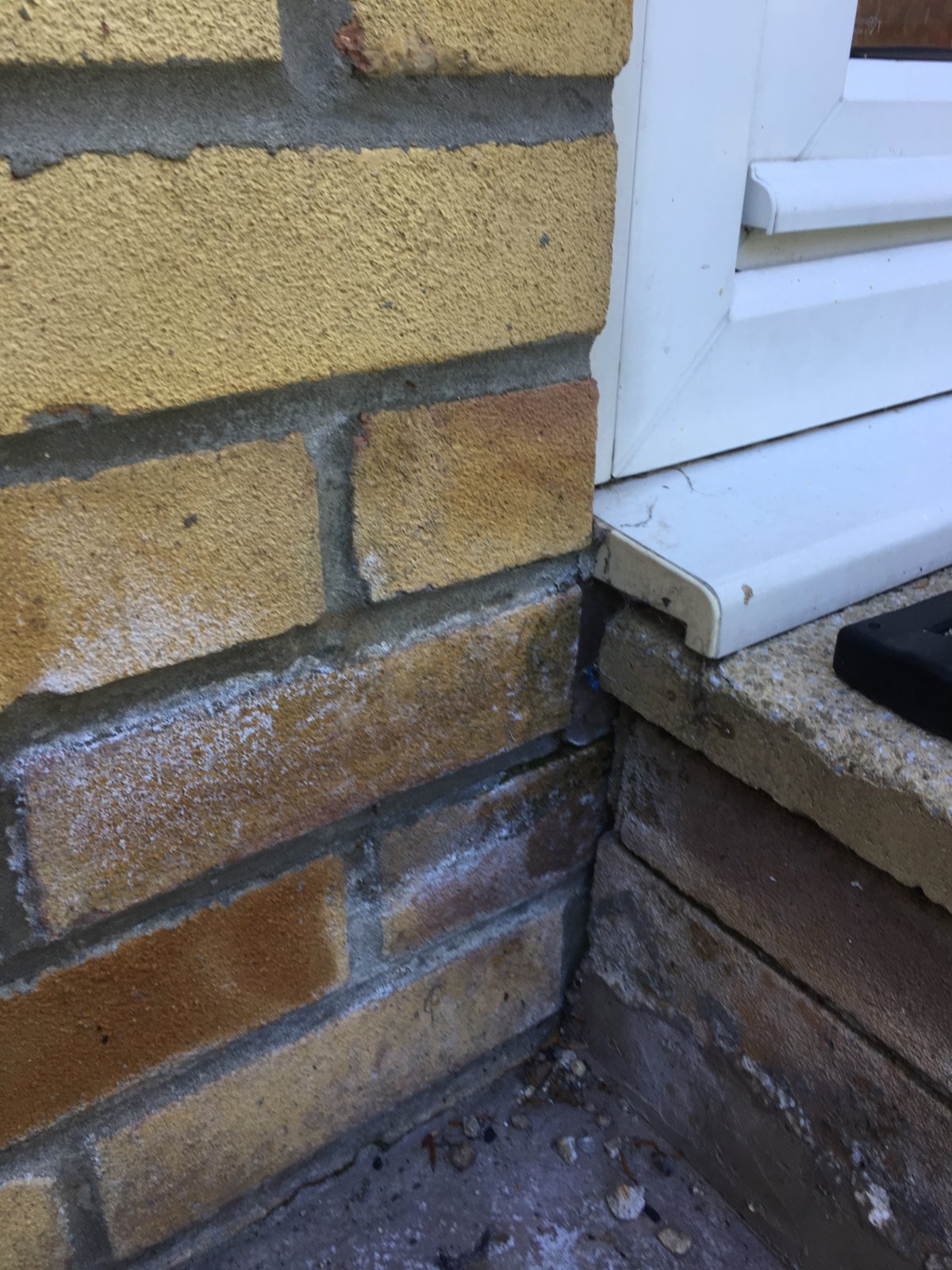

Thanks for that. I've felt the skirting board and it feels fine. I've attached some pics of the outside wall, it's not rendered but I have noticed some white near where the damp is the othe rside, there is a step and there is a slight gap (3mm) between the step and the brick, Yes I have cavity wall insulation. I've measured the door recess and its about 10mm, so no ware near enough, but might be a pain to move.

the white stuff on the brickwork is efflorescence - dont worry about it.
the step is a codge up and might be bridging the DPC/DPM - lightly probe the mortar beds to locate the DPC bed.
yeah, dont mess with the door but check around the frame that its well silicone sealed.

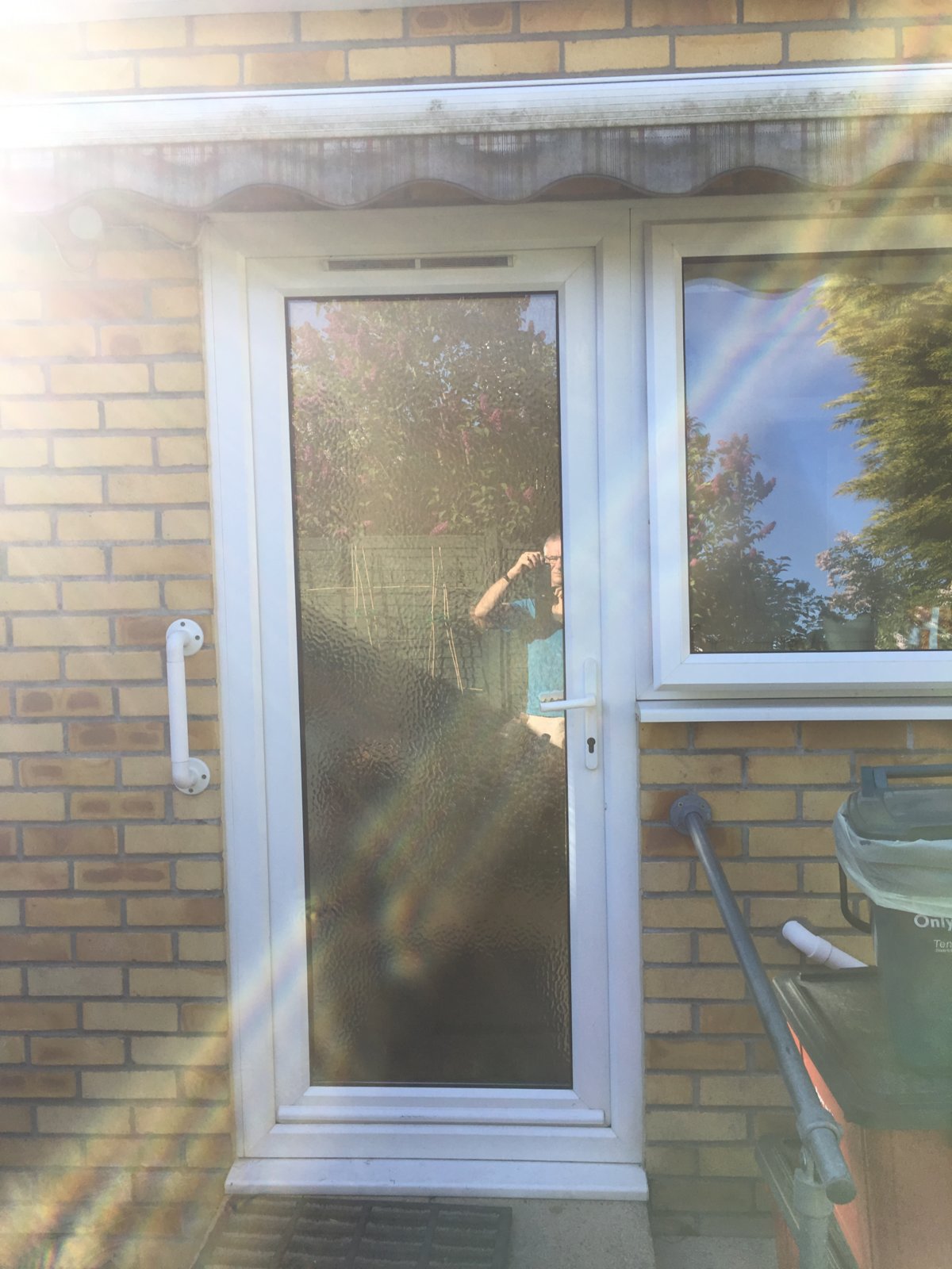

i cant clearly see the canopy arrangement - is it flashed into a mortar bed where it meets the wall? does the canopy definitely slope away from the house?
if moisture is somehow penetrating into the cavity and soaking the insulation then you've got a problem because wet insulation takes forever to dry out - if then?
you could remove all 3 pieces of skirting in damaged areas, and hack off all plaster that shows damage.
dont re-plaster using gypsum plaster - instead use a 3:1 mix of sand and lime.
re-fix pre-painted, sound skirting.

Well done for noticing the Canopy :)
Looks like penetrating damp caused by the built up step under the door breaching the dpc.
