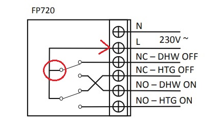

So from the diagrams above:
The 4033 has a permanent live to be made to terminal 1. The FP720 already has this connection made internally so doesn't require this connection.
4033 2 HTG ON = FP720 HTG ON
4033 3 HTG OFF = FP720 HTG OFF [this terminal probably won't be used]
4033 4 DHW ON = FP720 DHW ON
4033 5 DHW OFF = FP720 DHW OFF
4033 6 L = FP720 L
4033 7 N= FP720 N
Whilst the FP720 doesn't have an earth terminal, if there are wires in the 4033 earth terminal they should remain connected together. You might need to add a separate new connector to do that.
hi sorry to bother you again but does this mean -the red wire to terminal 1on rhe 4033 -just dont connect to any terminal on the 720
There isn't anywhere on the FP70 for you to put it, because the FP70 doesn't have a 'DHW COM' terminal.
And that's because the connection between terminal 1 on the 4033 and the internal switch shown here in the red circles....
....is already internally connected to the L terminal for you on the FP70
I would expect to find now that other end the wire in the 4033 DWH COM (1) is connected to L (6). If so, just get rid of this link when you move to the FP720.

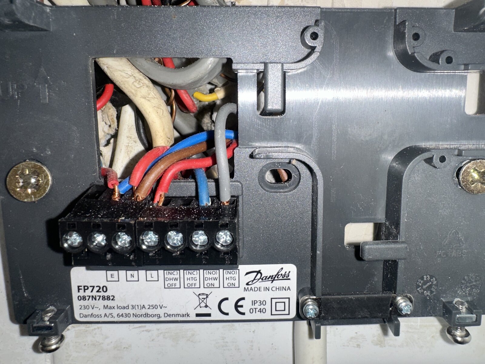

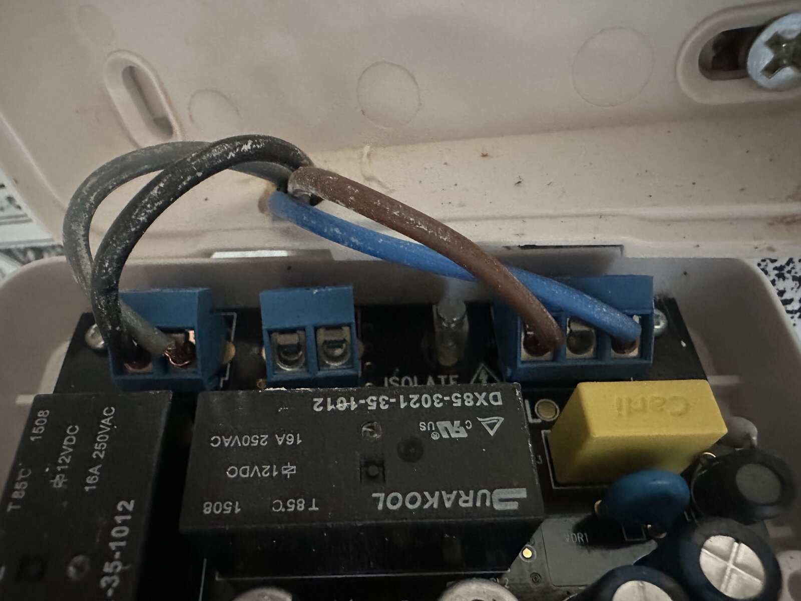

Hi, sorry for piggybacking on this thread but stem seems a good person, if around, to ask my question. Currently using a fp720 programmer with a geo cosy smart thermostat. Need to replace the cosy as being disbanded. Just wondering as the fp720 has internal live links to terminals 1 and 2 why term 1 (dhwoff) would currently need a connection? Nothing in htgoff, wire in dhwon and wire in htgon which believe goes to the cosy switch and then onto the old room thermostat, whcih currently runs in parallel.
thinking of switching to a Drayton wiser 2 channel smart thermostat to replace the fp720. Which would mean moving the black wire from the cosy to htgon.
P.s. ok think I’ve answered it myself, the dhwoff wire is related to the mid position valve. So replacing the fp720 should be a straight swap of wires other than htgon wire, ie the black in cosy into the fp720 instead.
Correct. Mid Position Valves require a 'Hot Water Off' signal to move them across to the Central Heating only position when Central Heating is required and Hot Water isn't.
The Danfoss and Drayton as you have figured provide the same wiring functions. But the Drayton software also includes a room thermostat function, so the old wired thermostat needs to be decommissioned to prevent it overriding the Drayton. It can't simply be disconnected as this would leave the heating wiring 'open circuit' and it will not operate. The thermostat can be decommissioned in three ways, unfortunately I don't have details of the Geo Cosy to be more specific, but generally in order of preference (or professionalism), the methods for thermostat removal are:
1. Find the origin of the thermostat cable. Note where the wires are connected and disconnect the cable. Then link the terminals where the two ‘live’ switching wires came from together.
2. Remove the existing thermostat and replace it with a junction box, connect the two ‘live’ switching wires together and isolate the neutral (if there is one)
3. Leave the existing room thermostat in place and join the ‘live’ switching wires together in a separate connector that you can tuck away in the corner of it.
Ta, yep done stage 1 today. Got the cosy disconnected and running off the fp720 and old room thermostat. Just had to connect the wire going off to the cosy into htgon, and remove the wire coming back from cosy. So wiser now should just be straight wire swaps. For now will probably just leave old room thermostat set high. Just leaves a bit of diy to secure new bracket to wall and bit of tiling fixing to conceal the mess of cables! I suspect could be made neater but don’t have a full wiring centre box.
