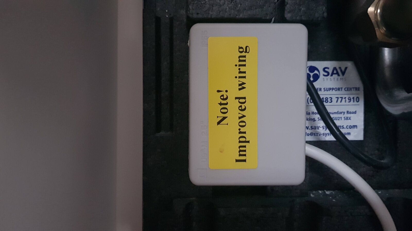

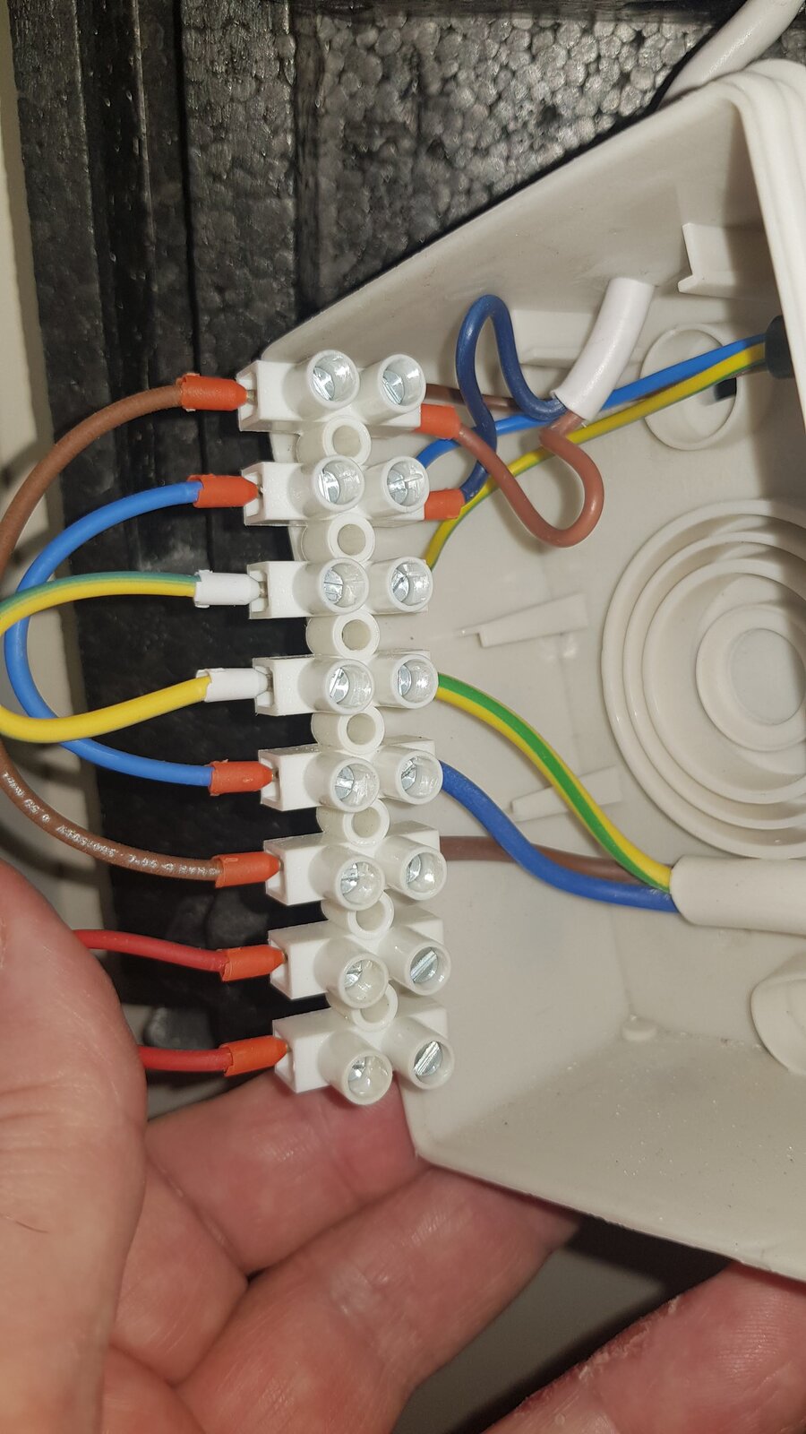

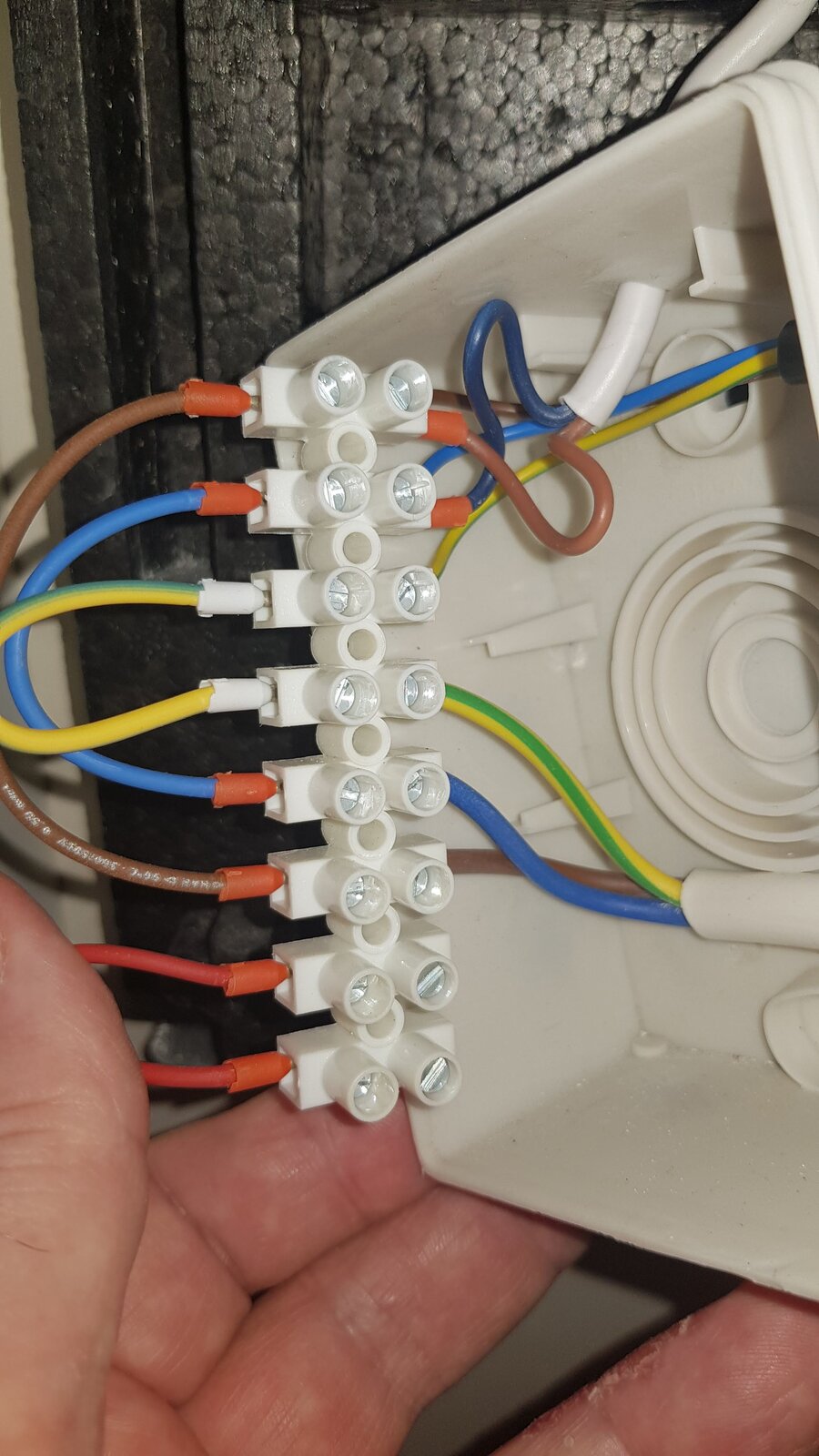

Hi to all . I wonder if anyone can advise me please.
I have Danfoss heat exchange setup in my flat . All the flats are heated by a communal boiler in the basement. The hot water is on demand and is not a problem .
The heat exchanger has just got a normal power lead that plugs into the mains and is simply switched on and off via the switch on the plug socket. Not very efficient.
I would like to install a Hive type thermostat but as there is no existing programmer to replace I'm not sure how it should be connected. I have uploaded some pics of the wiring setup (the power lead is to the right )
Any help or advice would be greatly appreciated.
Happy new year to you all.

If it’s on a plug, what about a smart plug? For a hive thermostat you’ll need a permanent live and permanent neutral, along with finding the switching wires
The three cables on the right of the picture just lead to a plug . That's how it was set up when we moved in . We plug it in and turn it on or off with the socket switch .

I have thought about a smart plug but I'm not sure how I would connect it with a thermostat and/ or a timer

No, I specifically underlined cables, not the wires. There are three cables and nine wires.
However, apart from that, aren't there two lots of three cables wires 'on the right'?

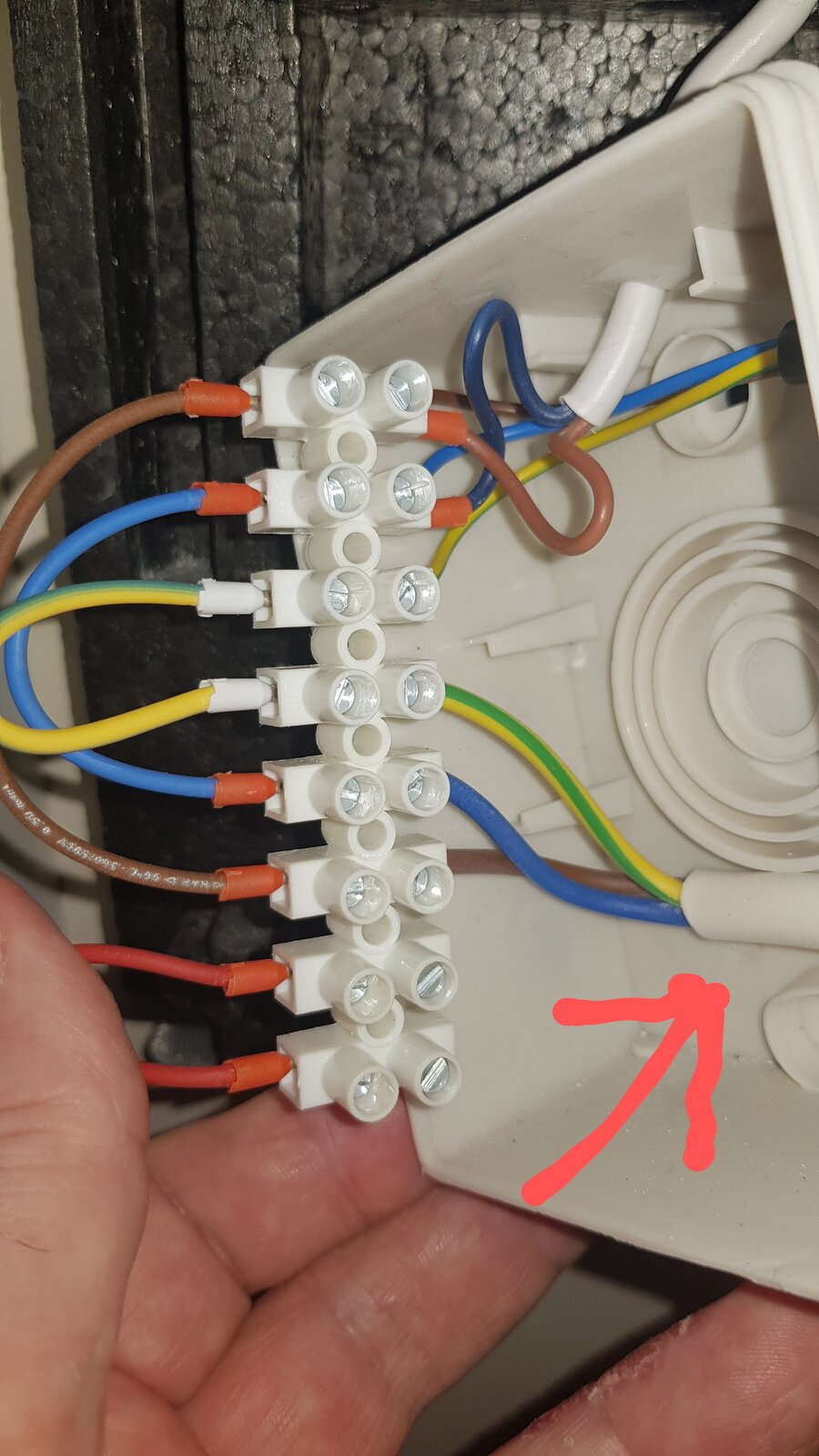

The two cables on the top right of the picture disappear up behind the heat exchanger (sorry not sure where) . The cable on the bottom right leads to the power plug.
The red arrow indicates the cable to the plug

If that’s the plug, thermostat should be easy. L-n-e are the obvious ones, the other brown and blue look like switching wires.

I've assumed the wires on the left are only links and therefore it looks like all 3 cables are in parallel.
I assume: power in, pump and valve. But this is not from experience of the product.
No, you still need the supply in, what you’d do is piggyback the supply.

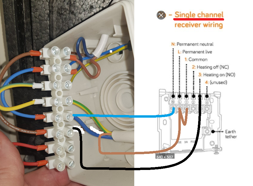

I don't know the product either but if it works from the plug switch and nothing else, then surely -
all that needs doing is for the Single Channel Hive to switch the plug cable Line(live) wire, so -
Brilliant diagram thankyou . Regarding the brown wire in your diagram it goes to the L( permanent live) and also to 1 (common) . Would I just use a short jumper cable for that ?
