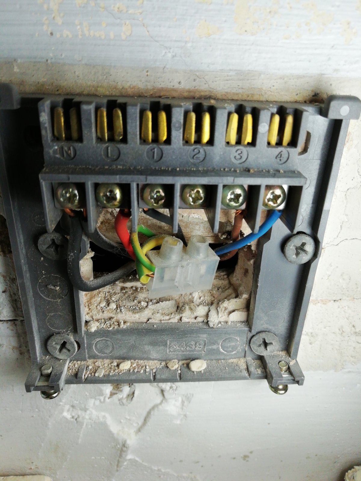

Hi guys
Just had a CP715si fitted in replacement of our old original CP715.
We have a fully pumped system.
How do I get the new programmer to do separate HW and CH timings? Some one has told its a wire swap on the backplate?
I've attached a photo of the current wiring
Matt
Both devices have exactly the same wiring diagrams.
Are both CH and HW on when only HW is called for AND when only CH is called for?
That's correct. maybe I'm getting confused. I was under the impression you could physically set different times for HW and CH?
When the programmer is set to auto for both CH and HW they both come on at the times set regardless of if its called for. For example in the winter, the hotwater will go off at a certain time but so will the heating. I then have to go and override it to keep the heating on longer. Very frustrating.
I must add, the old programmer never allowed separate timings either.

Does the system allow separate HW and CH? That needs a mid-position valve or two 2-port valves. If you have an either/or 3-port valve you can have HW only or Hw + CH, but not CH only.
I have a 3port valve fitted.
The wires at the programmer are connected to where they would be expected to go if you have a standard 3-Port motorised valve as part of a Y Plan system. That would be N, L, 1, 3 & 4.........But, what the wires are connected to at their other end of course is unknown, as is the rest of the wiring.
Assuming yours is a standard 'Y Plan' it appears to me that there is a probably a fault somewhere else, in which case, you will probably need someone who is competent to use electrical test gear and understands how a 'Y Plan' system works and is wired to check it through bit by bit. This can be tricky, because not all plumbers will understand how the wiring works and not all electricians will understand how the 3-Port valve works.
To answer your earlier question, terminal 2 is virtually never used. Only a rare type of valve called a MoMo would use it [I've only ever seen one] and AFAIK that applies only to the two port version. I seem to remember that the three port MoMo doesn't use it either.
