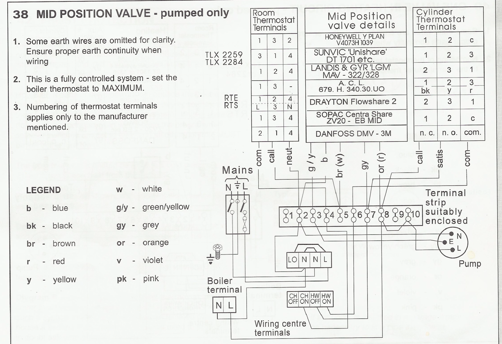

Danfoss CP715si wiring to allow separate HW and CH timings
OK, so it's a mid-position valve. If the timer is wired correctly, you can have any combination of HW and/or CH.
My guessing is it isn't wired correctly. As I can't set individual times on programmer. I'll have to get someone out to investigate.
Below is the wiring diagram for mid-position valves. As you can see, terminal 2, CH off, is not used. Presumably the wiring hasn't been disturbed, so if it worked with the old programmer, and the new one is working correctly, I can't see why it wouldn't work.
But reading the set-up instructions made my brain hurt. Are you sure you've done it right?
