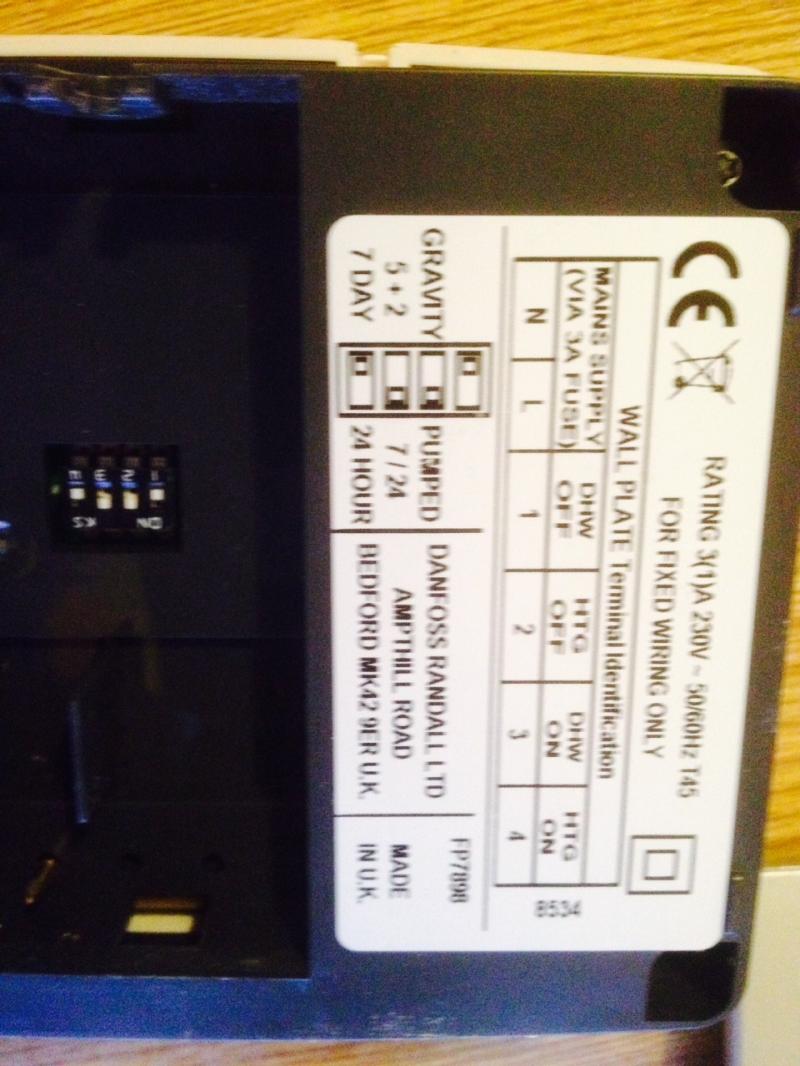

Can you post a photo of the programmer wiring diagram just to confirm it's not a wiring error there? It should be shown on the back of the programmer.
Also, does terminal 10 go dead if you physically remove the programmer from its back plate?

I removed the programmer from the back plate and 10 and 15 are now both dead. (I did remember to turn the power back on at the spur after removing the programmer from the face plate)
Faulty programmer looks more certain now???

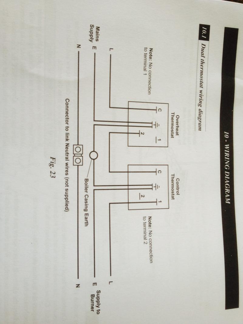

Before digging too deeply into the external wiring go back to the boiler and check the wiring connections in there.
Many new boilers have a link (links) between the main live and switched live terminals so the boiler will run out of the box. This link (links) needs removing as they effectively over-rides some, or all, of the external controls depending upon boiler configuration.
