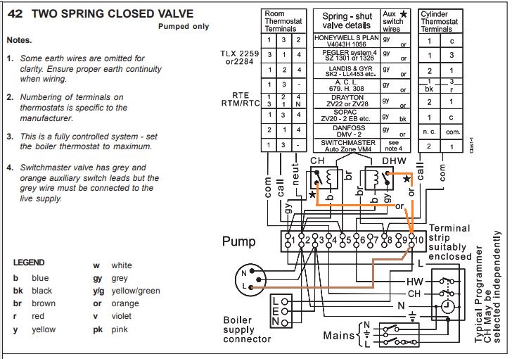

Maybe not the boiler PCB. Below is a diagram from an online SE24 FF manual and as you can see the pump is connected to the wiring centre, the only connections going to the boiler are its L, E & N. The pump should be connected directly to the microswitches from the motorised valves via the wires I have highlighted
Which is odd (if your boiler is wired the same as shown) when you say...
Testing the valve microswitches shows they are opening fine and both fully open when the system is off
If the microswitches are 'open' the pump (and boiler) won't be getting any power.
Yes, looking at the circuit diagram the live can only go through the 2 microswitches - operating singly or together. One of them is definitely 'on' when it shouldn't be, albeit intermittently.
