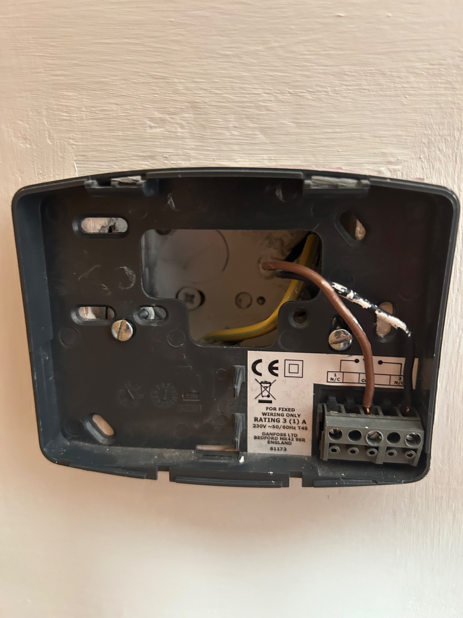

The Danfoss TP 5000 runs on a battery and has 2 connected wires to COM and N/O (as per the photo - IMG 7235). The wiring in the back box contains an earth and grey wire too.

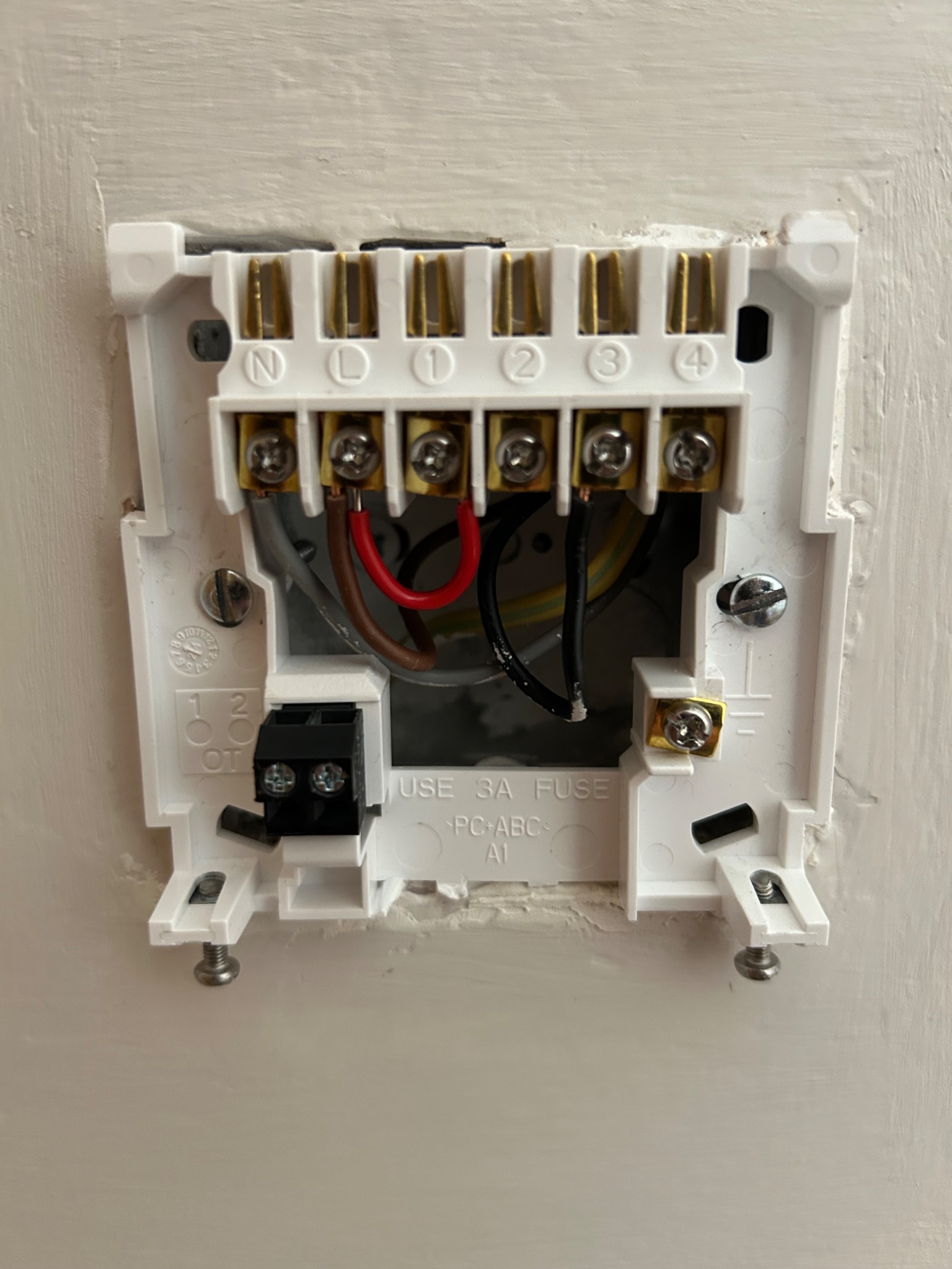

I have taken the COM to L on Hive and linked to COM at Hive (terminal 1), the black wire to terminal 3 and connected the grey to N at Hive (as per the photo - IMG 7236).
At present, the Hive doesn’t fire up as it appears there is no power going to it, but I know the Hive unit works having tested it on the main zone, and if I move the black wire to terminal 1, the radiator comes on when the power is restored so I know the circuit works.

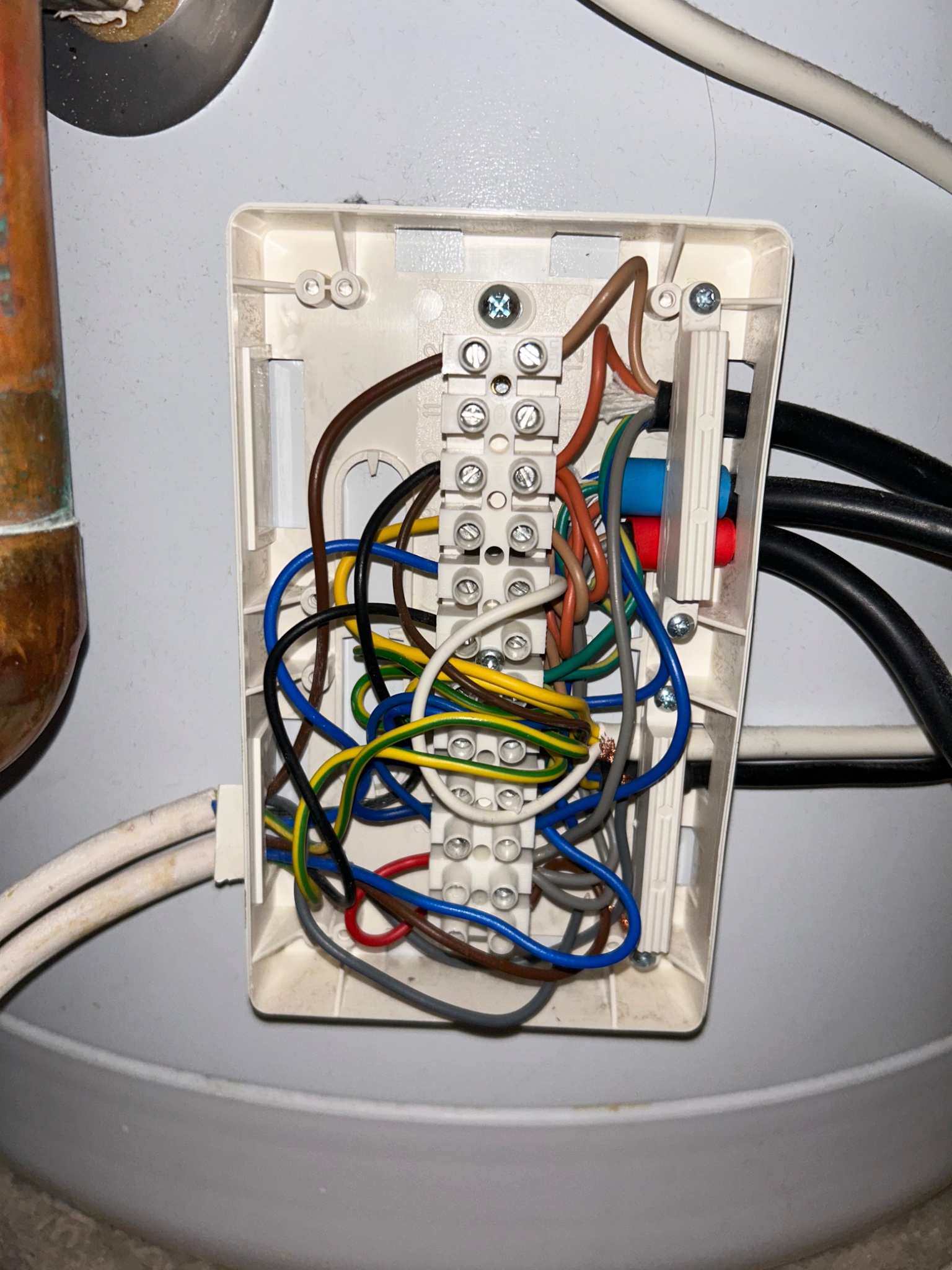

I suspect the issue may relate to two disconnected grey wires in the wiring centre near the hot water tank (as per the photo - IMG 7237).
What’s the best way to identify which grey wire is the correct neutral and where it should connect?

There won't be power to it because it needs a permanent neutral as I said in the linked thread. You need to ideally bell the wires to ascertain which is which grey and then connect to Neutral in the wiring center, ideally sleeving or taping blue so people know it's a neutral.
Alternatively, wire your receiver at the wiring center and disconnect the wires that feed the Danfoss.
How do I know what is neutral in the wiring center?
If you follow the blue from your motorised valve cable (it appears yours is a black cable) then all the neutrals should be located together, it’s not the best photo to see clearly

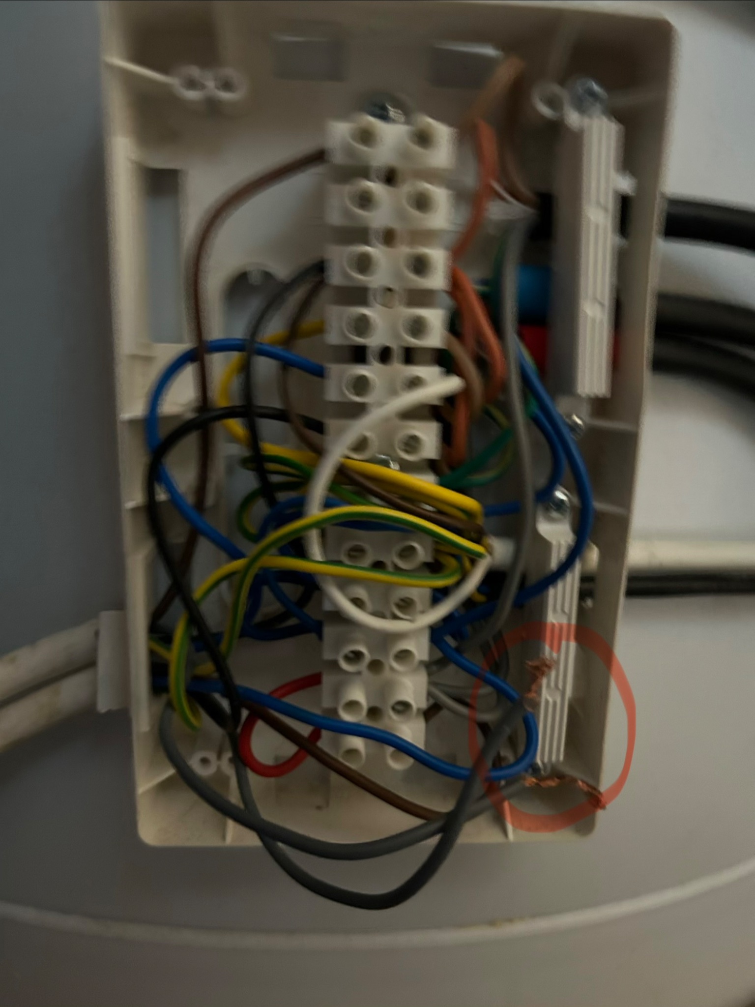

Thank you and sorry for the bad photo - here is a much clearer one.

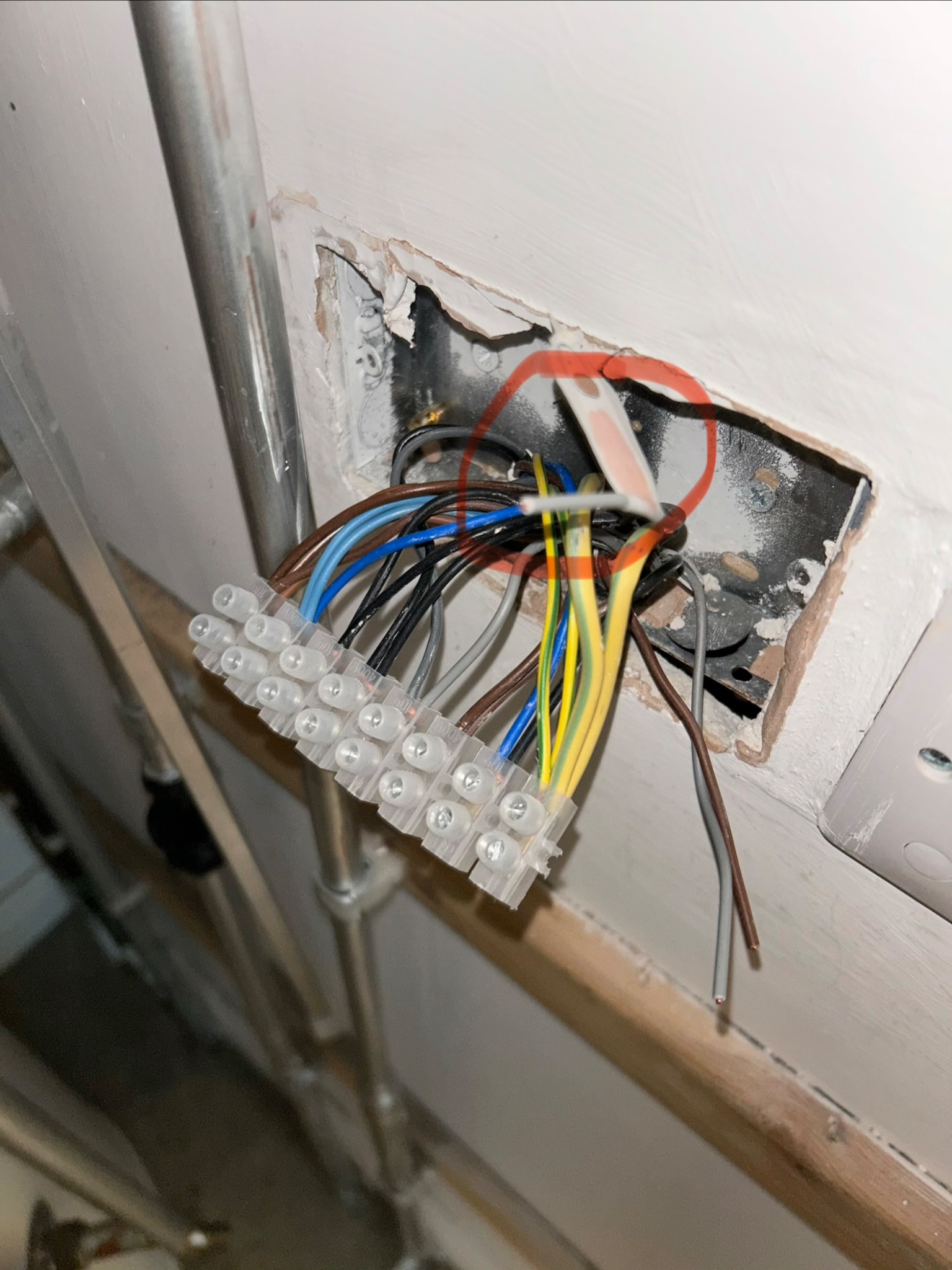

That didn’t work because I was wrong. You were obviously right CountryFan about belling the wire.
I’ve used a multimeter and found the other end of the grey cable and it’s in a connection box that’s a few feet from the wiring centre (as per the photo).
I’ve connected to the neutral (blue) here and success!!
Thank you for all your help!
