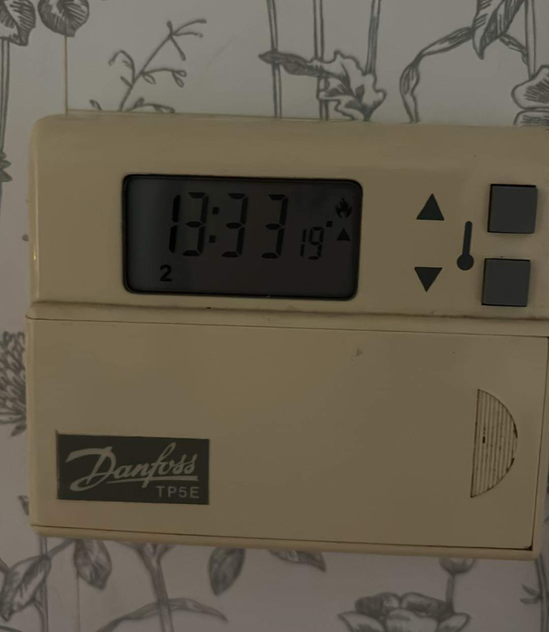

Looking to replace this old intermittent stat control.
Danfoss TP5E
I’m not local to it at present as it’s at my sisters, I’ve been looking for a installation guide to see how many wires there are but only found user manual.
Anybody know how many wires ?
My goal is to remove this from the wall & replace it with something newer but I was told need to know how many wires it has.
Can you advise how many wires & an easy to use replacement.
My sister only ever uses it in manual if that helps you advise a replacement
Looks like it’s a 2 wire - live and switched, so to replace like for like you’ll need similar. If you wanted different, depending on the setup, you could opt for wireless.
I since found that it’s 2 wire.
It also mentioned no earth or neutral so live & switched live mentioned above would sound correct.
So do I now just look for a 2 wire stat ?

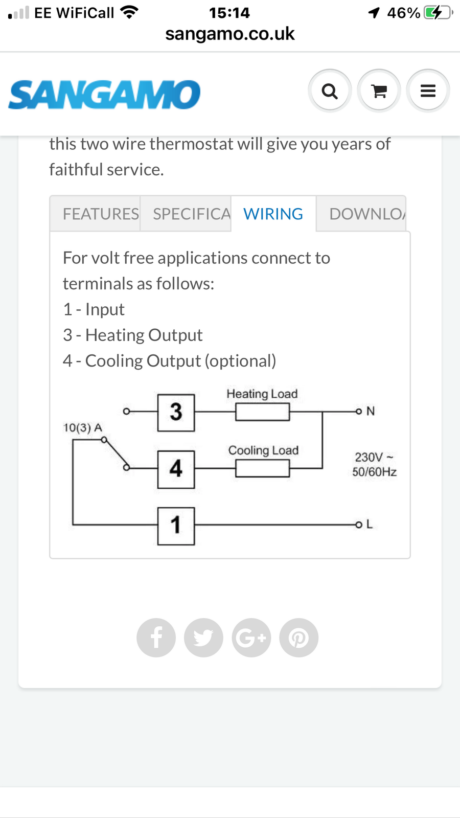

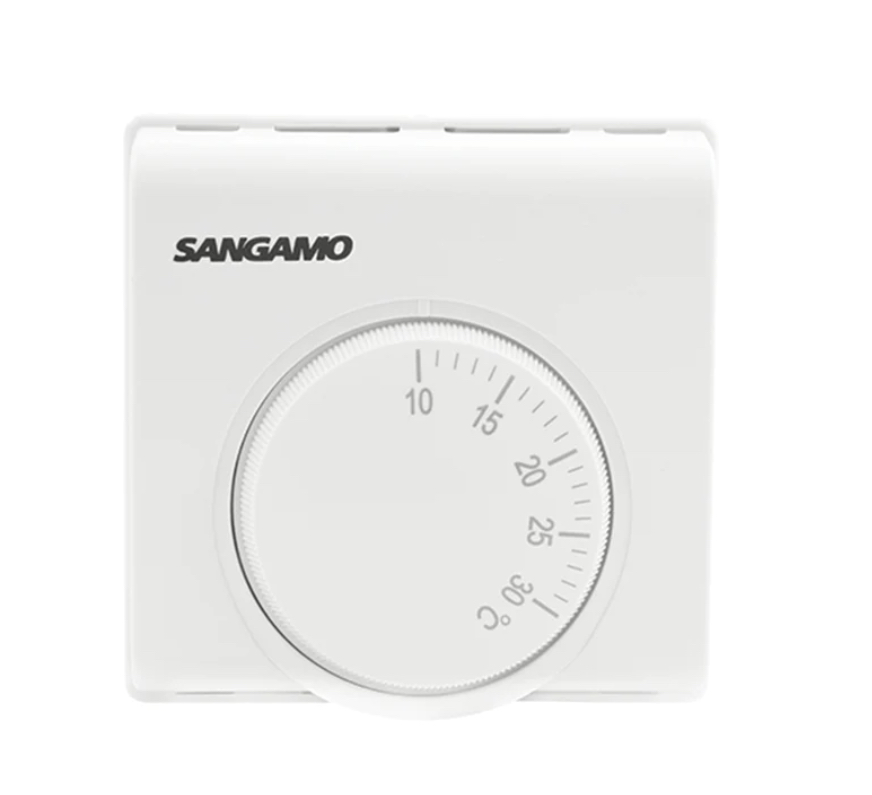

So going by the member saying it’s 2 wire can I use the following stat & wiring also shown, please advise thanks .
I would say so, if you read the writing above it states a 2 wire. Might be better with digital though, as it might be more accurate, so a Siemens RDH100 or Honeywell DT92.
I had seen it mentioned 2 wire but didn’t see what the 2 wires were.
You mentioned live & switched live.
So does that mean the above is the same or not ?
Yes, it’s the same. Some reason, manufacturers tend to put N as the return/switch live.
