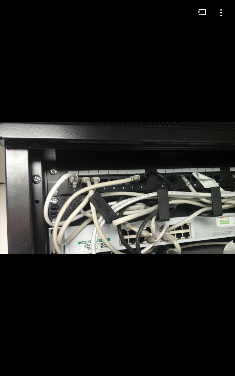

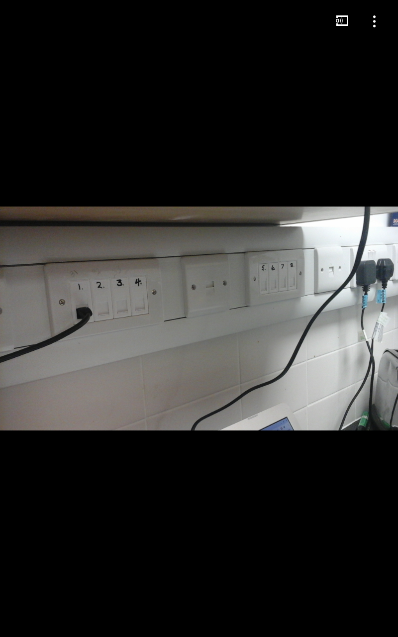

Looking for a bit of advise, was on a job today and asked how the following can be tidied up.
and whether the Data company are needed.
Theres a long data cable sellotaped to the wall and plugged into the outlet marked 1.
There are other unnumbered ports nearer below the data rack.
Am i correct to think each of these outlets will go back to one of the numbered outlets on the black box in the data rack.
I have one of them network testers so would it be just a case of finding the nearer outlet and corresponding port on the black box .
Assuming the port marked 1 currently goes to outlet 1 on the black box, i can check that, is it then just a case of moving the jumper lead out of outlet 1 and put in the relevant new outlet/port.
Thanks in advance
Yep. Ideally each computer/printer/etc is plugged in to a socket as close as possible.
that is why the patch panel(black box) is there
Yup.
Not because you aren't capable, it's not a big undertaking, but because when you start unplugging cables things are going to stop working, and that will need managing and mitigating.

Im not sure it disapears into the rack, i quess it could go completely and just bypass the black box and outlet by linking direct between the two relevant sockets within the panel, but bit confused why this was not done in the first place.
The manager thought Data outlets were like phone sockets and he could just plug that black lead further down the trunking, so I just wanted to confirm, as i thought, that he cant.
At the other stores the black things are numbered and each outlet too, which i quess is the correct way, but this is a new store and apart from the permanent marker thats it.
For now he just wants the lead out the way a bit and when the till bloke comes he can do it properly.
I dont want to start messing inside in the rack in case something does go wrong.
Its only for the tills nothing important and the managers prepared to try it when not busy, if theres a problem i will just put the lead back as it is now and hopefully will all work again :)

Thats what i thought, so ideally the patch cable plug going into that black box, could have gone direct into the outlet within the rack wherever the end of the black lead is now, as theres no need for the big loop as its just going out through the black wire and back to the rack via the cat 5.
I best not remove the lead, but im miffed why its there really
Do you have a cat5 wiremapper, might come in handy for tracing
I have one of the two part things with i think its 8 lights on and you plug it into each outlet and it flashes in sequence, is that a wiremapper, ive used it a few times replacing cat 5 fronts, we are mainly electrical so only do small data bits to help the site out sometimes.

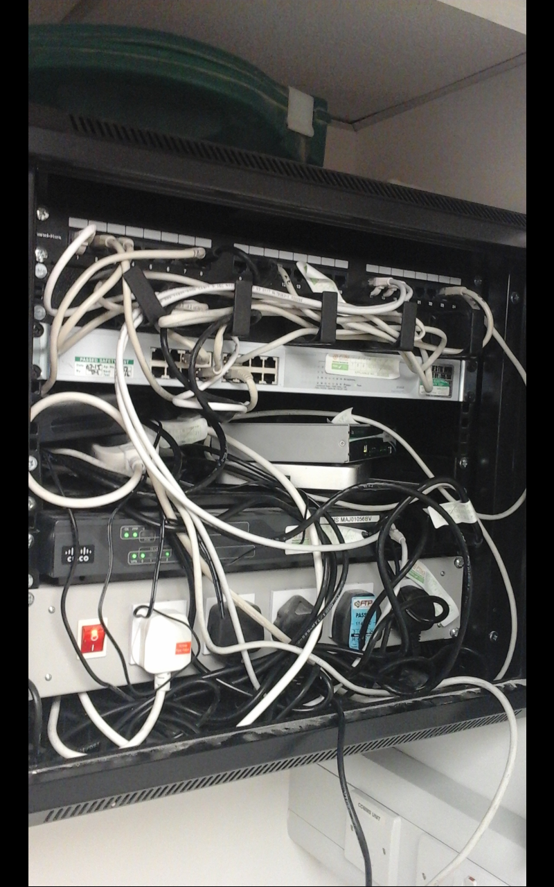

The manager seems prepared to chance it if its quiet
Well, fair enough. Some CYA in writing would be advisable....
The other thing about involving IT is that it could be quicker to just unplug the lot and start from scratch using the system documentation.
That's untidy ? I can tell you that compared to the majority of similar installations that's amazingly tidy :rolleyes: Though I see they've got the usual "lets provide some totally inadequate but ticks a box" power distribution panel in :whistle:

Yes, each socket on the wall should go to one of the numbered sockets in the patch panel. Each of those connections should be wired correctly and have been tested on installation - but some installers CBA with minor details like making sure they've not got any bad connections (there's 16 connections per wall socket - 8 at the socket end, 8 at the patch panel end) :evil: Similarly, some installers CBA labelling the sockets :mad:
In principle, you can move any connection to wherever there's a convenient wall socket and just move the corresponding patch lead at the cabinet. If you aren't 100% confident that everything's been done right, it would do no harm to do a quick test (your "box with 8 lights" tester will do) and see that at least all 8 lines are connected properly.
That's the point of "structured cabling" - you just have a load of identically wired sockets which you patch into whatever services are needed for any particular point. A couple of jobs ago I managed the internal systems which ran phone (analogue, digital (proprietary), ISDN), serial data (RS232), ethernet, and even the 10Mbps inter-system links used by the Transputers driving a serial I/O system. I had all the patch cables colour coded (blue for serial, green for phone, yellow for ethernet, and red for "don't touch this !") - after I left, someone thought it would be a bright idea to replace them all with black :(
