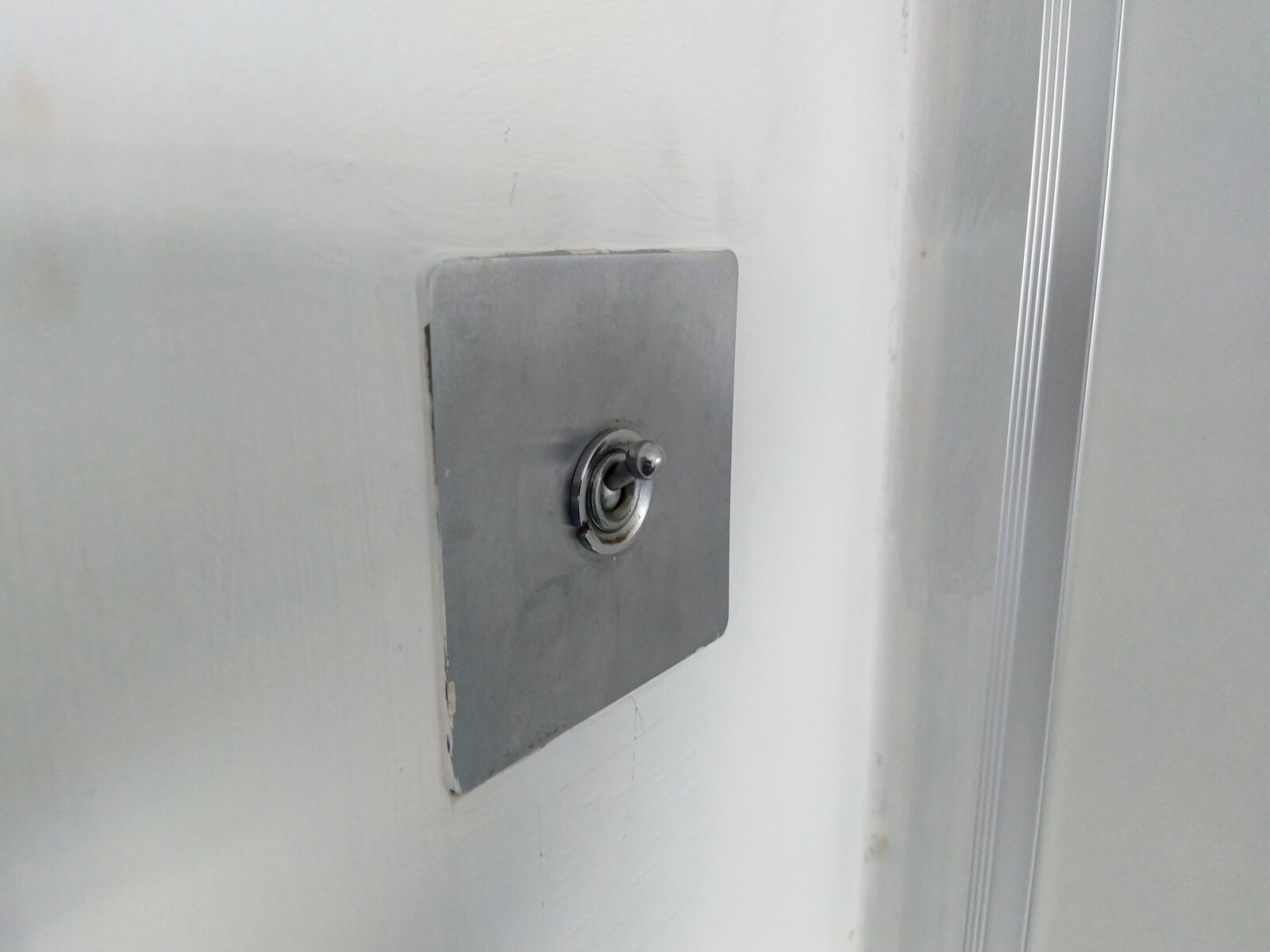

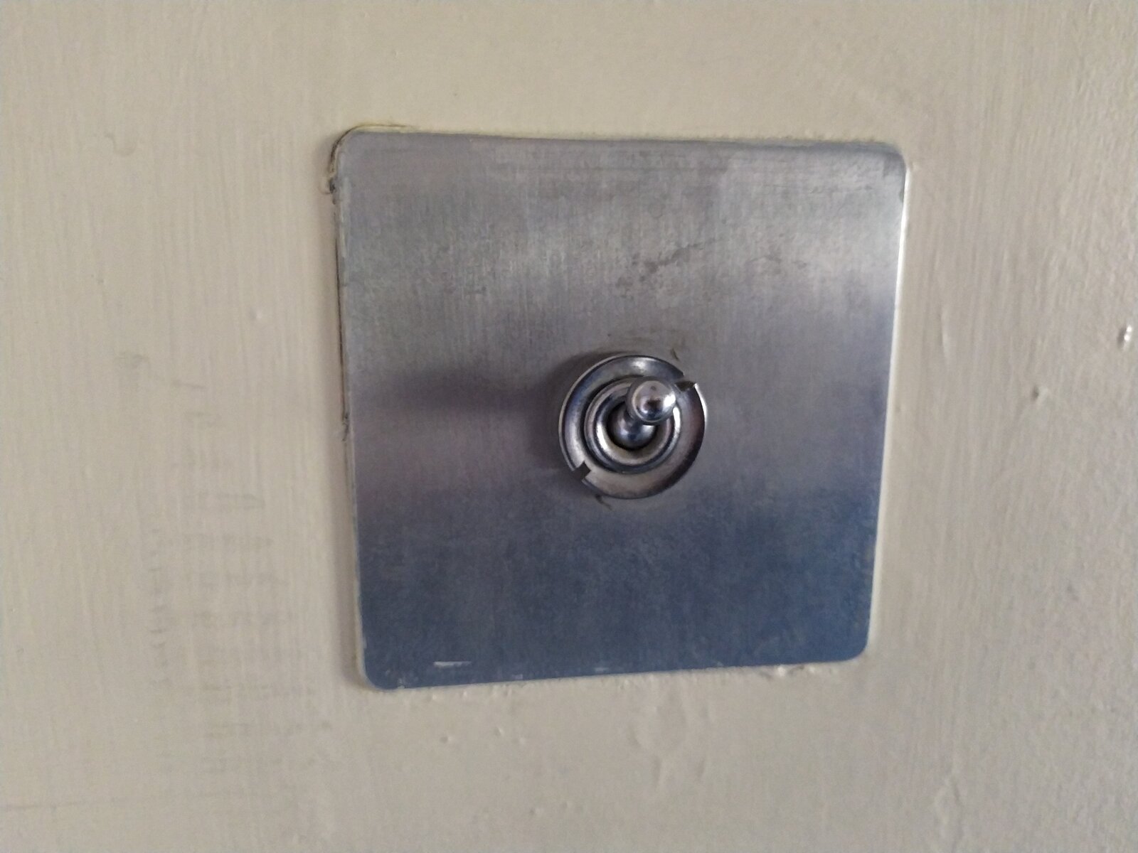

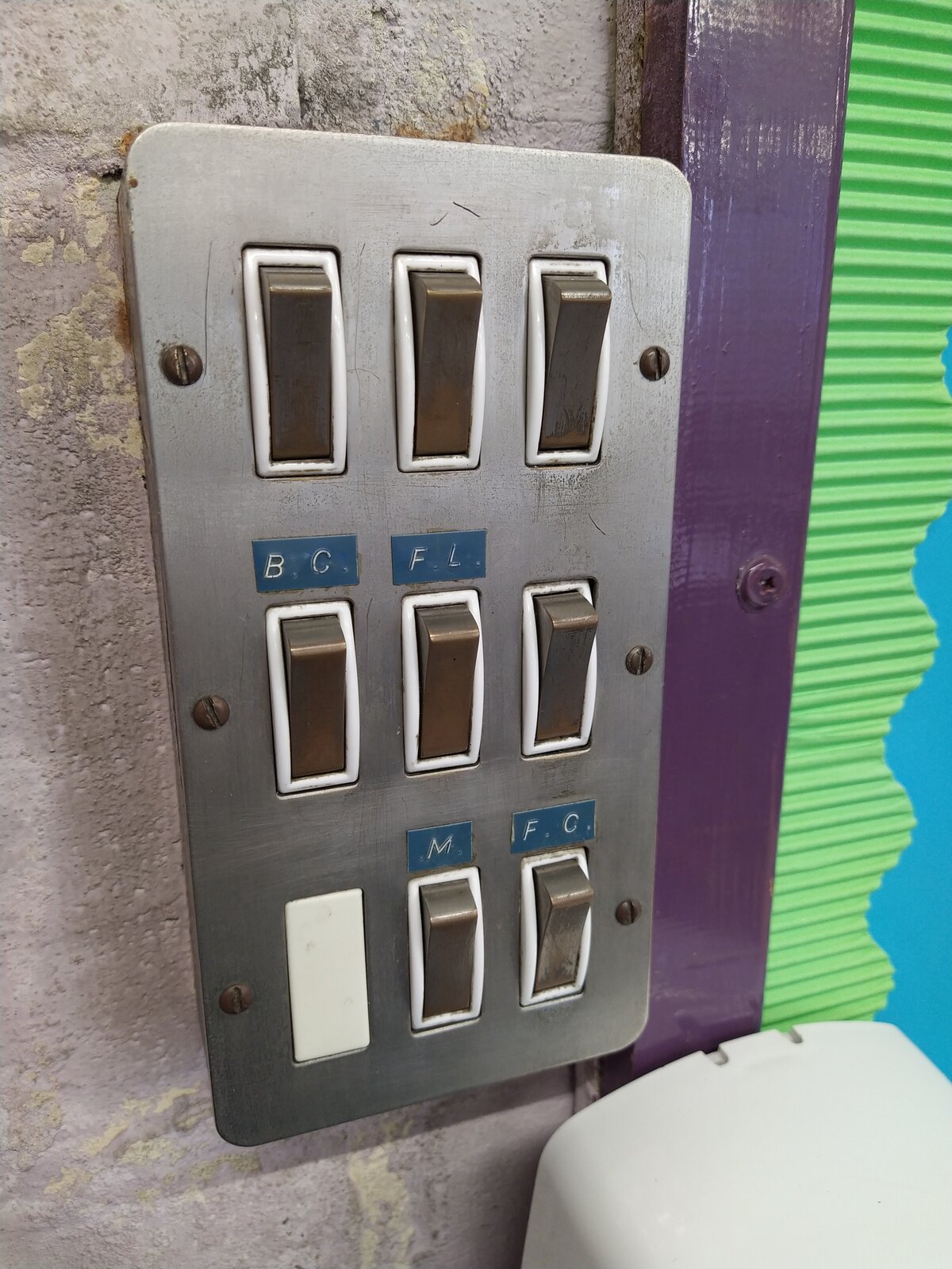

The toggle type switches have such a fantastically satisfying mechanical feel to them.
I can't find much info about them but similar looking vintage ones online on places like ebay seem to suggest they are Crabtree brand.
I actually have Crabtree 'Platinum' toggle switches in my house and while they are nice, they're nowhere near as quality feeling as those old original ones, so they've lost something along the way!
Anyway, thought I'd post some photos of it all on here in case anyone else wanted to nerd out on it all.
No idea what brand of switch the below is but there are loads of 1 and 2 gang ones around too.
Again, lovely satisfying 'clunk' when you operate them. Not felt any modern switch that feels that sort of quality.
Maybe someone could shed some light on brand? They look like maybe some sort of old grid system but not sure.

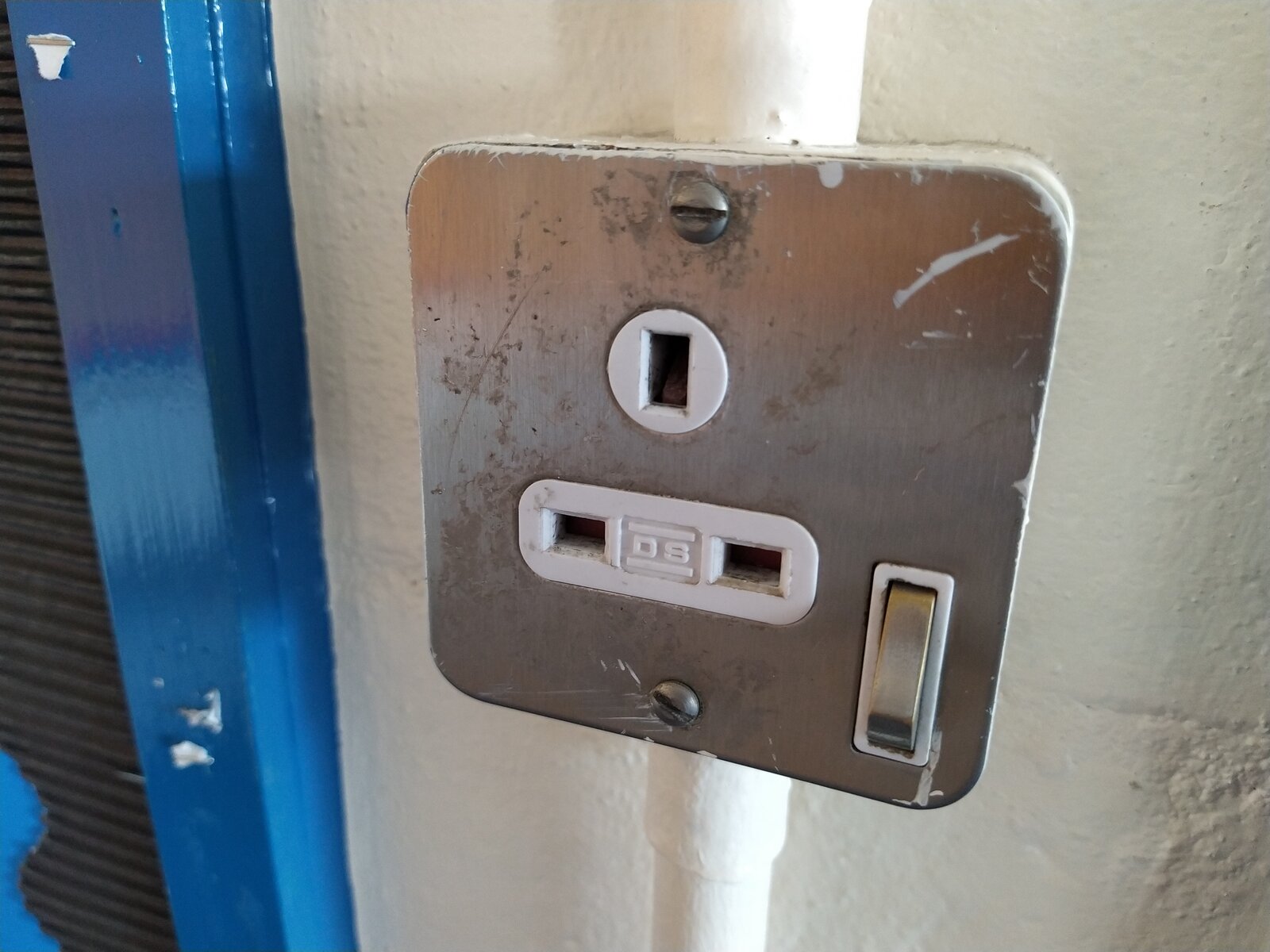

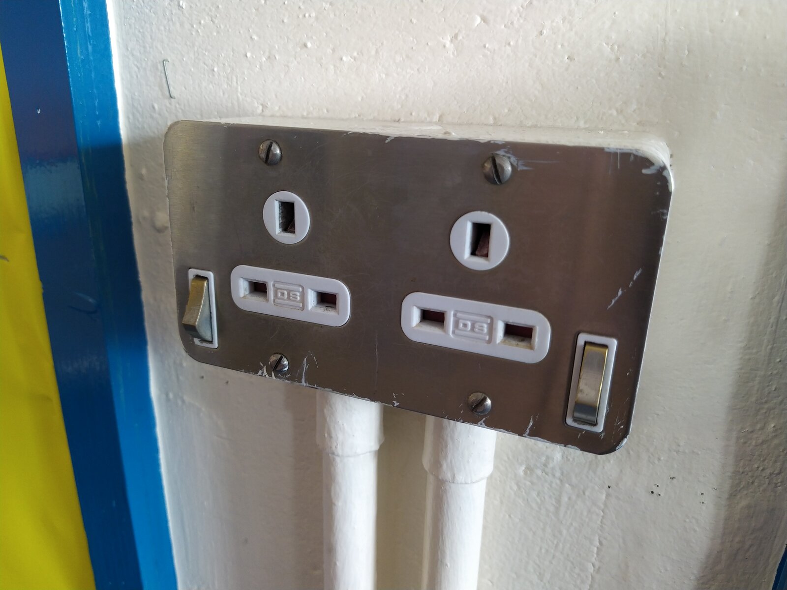

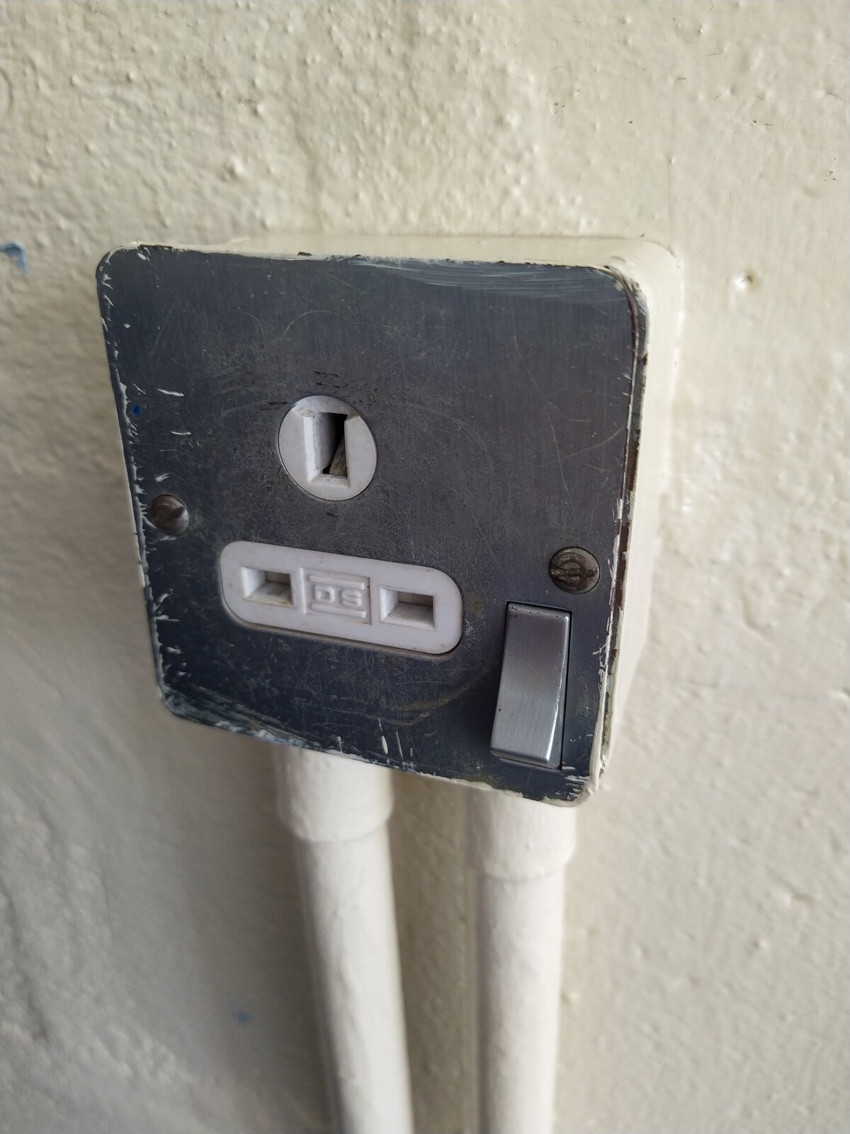

Found these sockets to be quite unusual with the switch in the lower corners - never seen sockets like this before.
While I wouldn't say they 'feel' like quality - the switches are all quite stiff to operate - they must have done something right as they are still in daily use!
Not sure of the brand. 'DS' is marked in between the live and neutral receptacles. Maybe Dorman Smith who seem to make large commercial distribution boards now?
Anyway, loads of those types of sockets around.

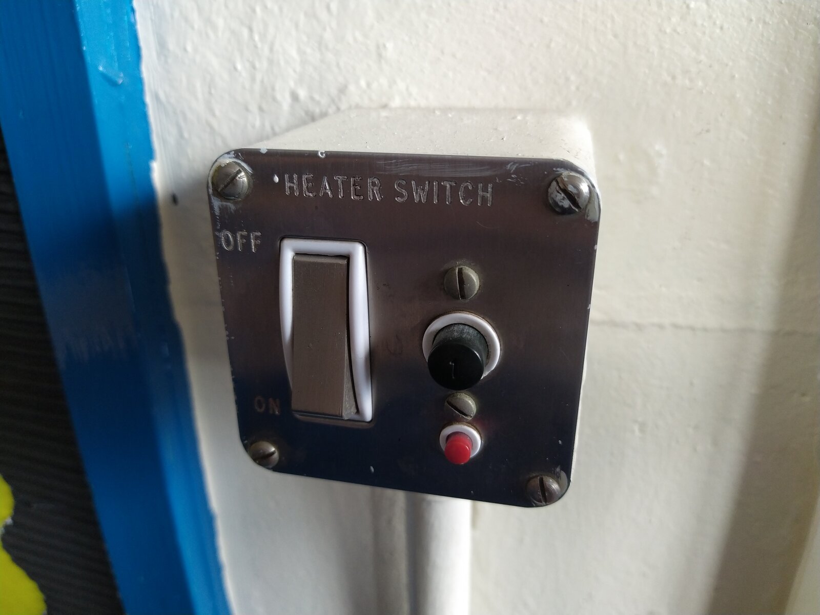

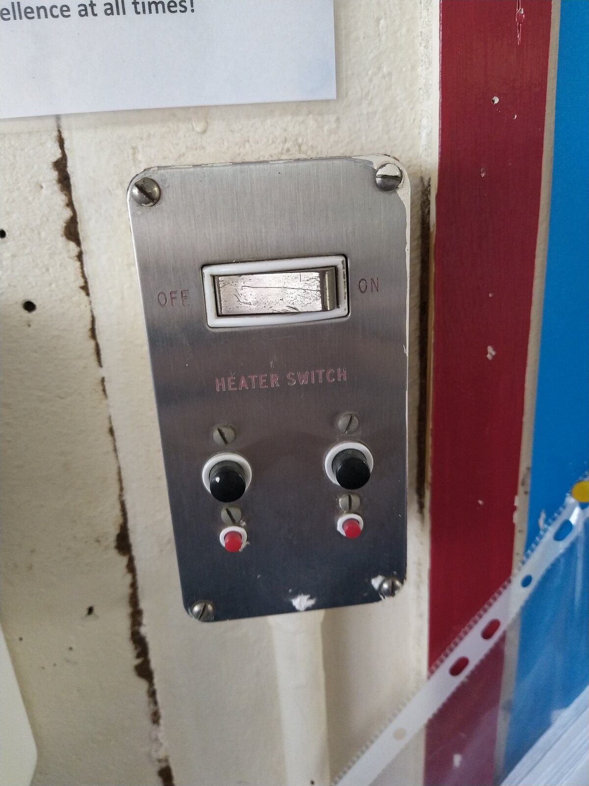

A lot of classrooms in the older buildings have these old 'Heater switches' in them.
Most of them appear to do nothing though I did find one that seemed to operate something as a whirring noise like ventilation started up when switched on.
The black circular button stays depressed when pushed, the red button then pops it back out. Not sure how they were meant to operate. Again, maybe someone has some knowledge of this?

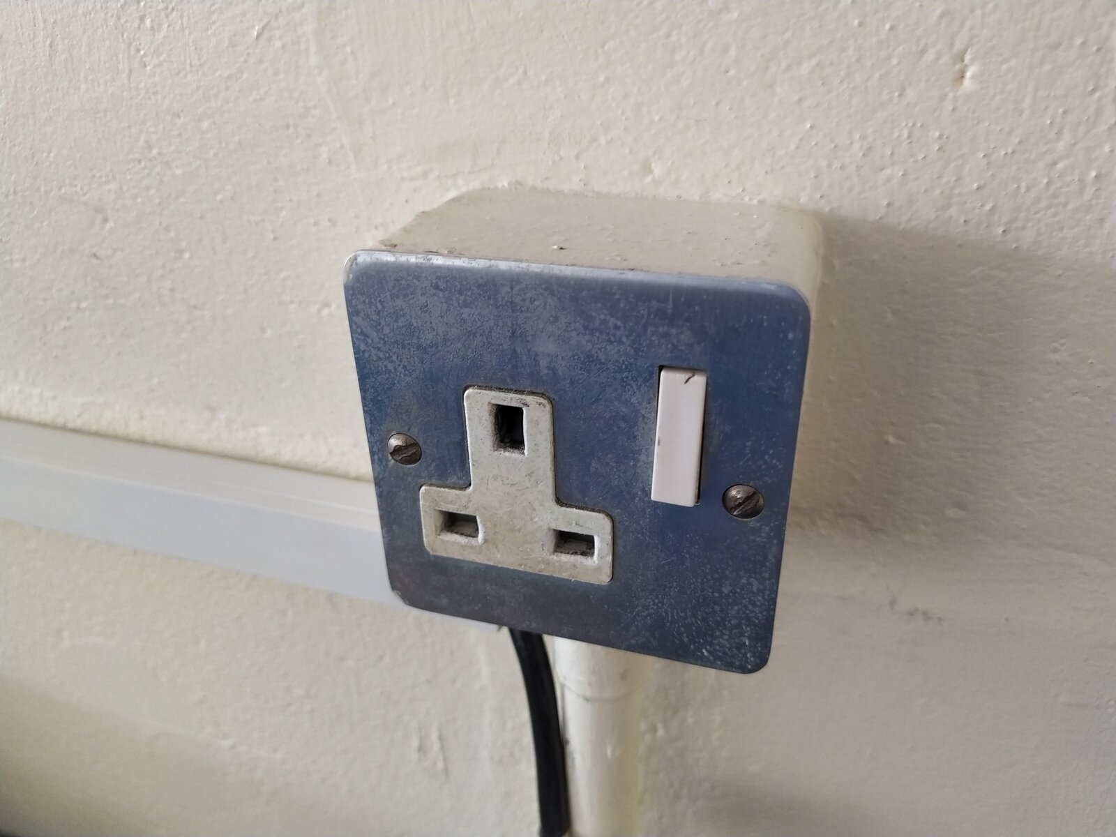

Boring but seemingly old metalclad type socket:

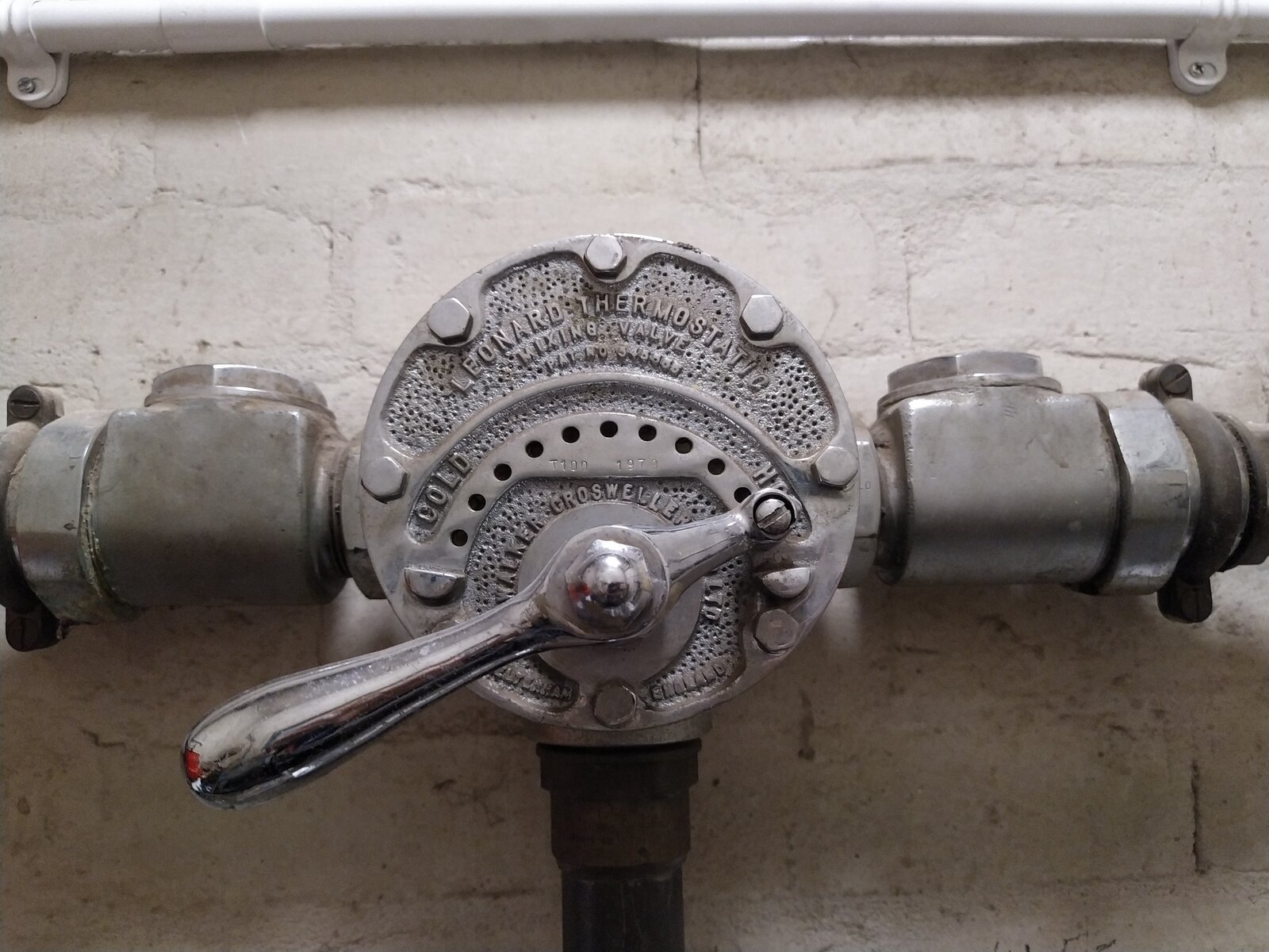

This is probably more for the plumbers subforum but putting it here anyway because it's old and awesome and you just don't see components like this anymore:
No idea if it does anything but the handle can still be moved!

Not familiar with that stuff marked DS, but a good call on it being Dorman Smith, particularly as a commercial environment.
Have to do some research :).
On Flameport's page he has shown some pictures of older DS sockets and plugs, mostly black - which are Dorman Smith.
Toggle switches with a satisfying clunk are probably designed to be able to switch DC. That is no longer a requirement so switches are lighter and cheaper to manufacture.
Possibly an RCD built into the unit, Red to test and Black to reset,

Early 50's there were earth leakage devices, both RCD ( operate on the difference between Live and Neutral ) and VOELCB ( coil in series with the CPC and operate on the current flowing to Earth from the CPC )
Possibly VOELCBs but, although you may be right in saying that RCDs 'existed' in the early 50s, it was 20-25 years after that before we saw them being installed to any appreciable extent.
I'm pretty sure that I had not even heard of RCDs until well into the 70s.

The actual switch inside was made from porcelain, fixed to the box via two, long 4BA screws. I would be inclined to check and ensure the metal cover plate is properly earthed.
We had those in our wooden temporary classrooms, the buttons are timers.
Despite the more complicated suggestions, was it probably not simply "Press Black for on and then red for off" (for two 'switches')?

Probably wrong, but I'm thinking fan control, for a unit such as:
Particularly as:
In one of our 1980's builds, we have massive cabinet fan heaters built into the walls.
Kind Regards, John
The units we had (remembering this from 1966-68) the switch would start the fan and the black button would start the oil heater (one building was electric, t'others were.) Pushing the red button would stop the heater but allowing it to time out the fan would stop.
Electric heaters the black button was a boost, fan ran much faster and i suspect another heater element.
EDIT: to correct info for electric version.
Particularly as:
Yes that sort of heater albeit our school units were big things; 4-5ft long, 3ft high and old brown/brass finish. Predated electronic timers by a mile:ROFLMAO:
