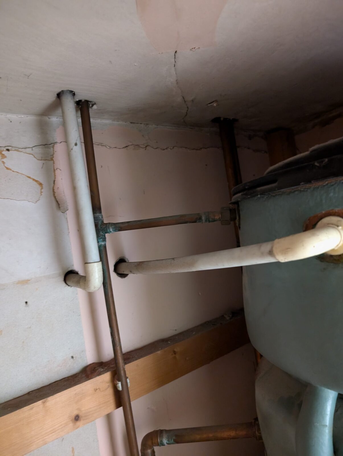

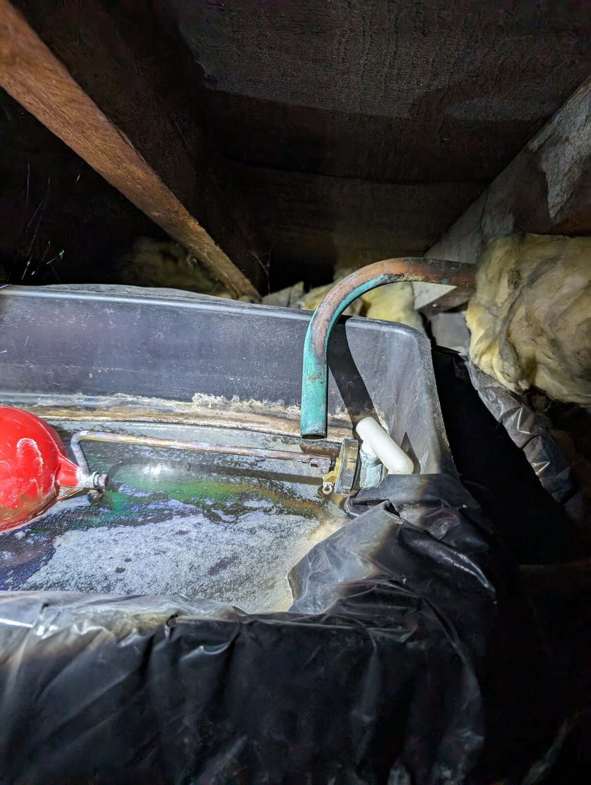

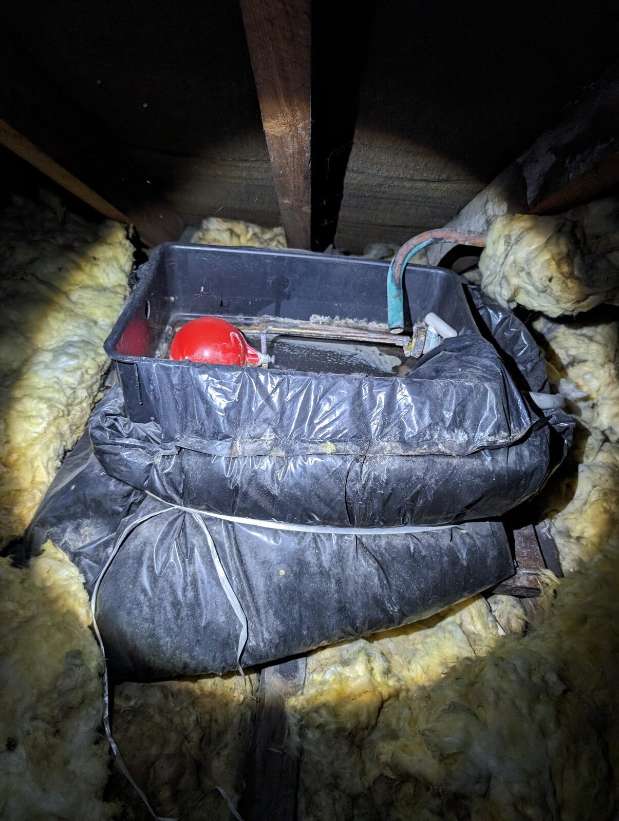

Dead bugs and debris coming out of hot water tank.

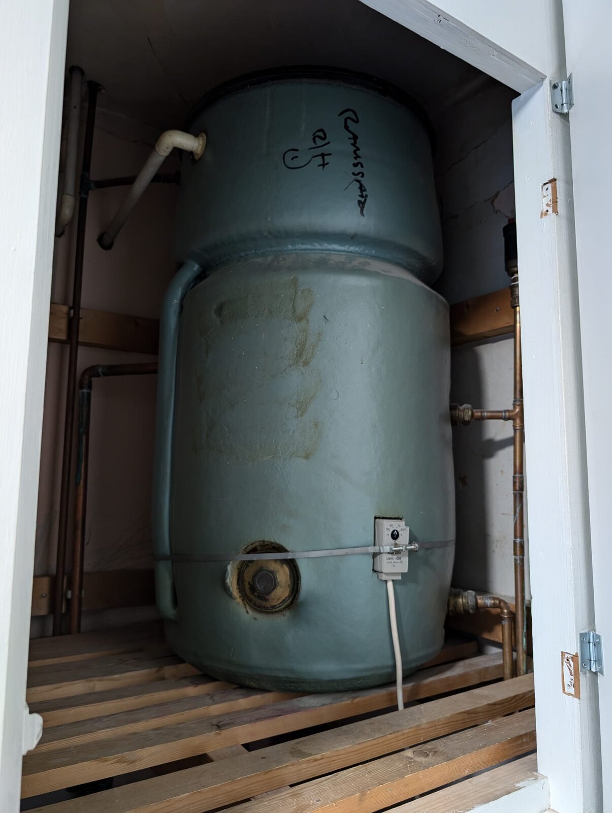

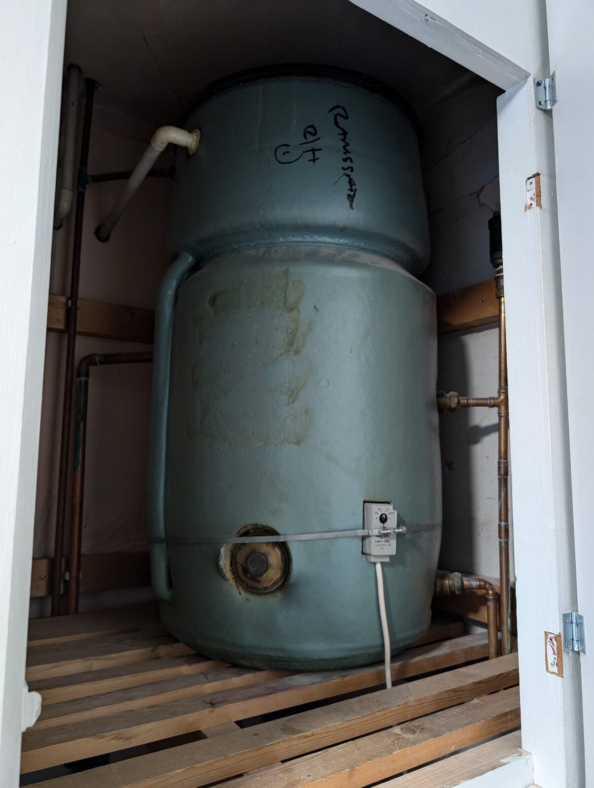

The fortic tank has been cleaned. What is the heating header cistern? The plumber used a wet vac
Pictures of fortic cylinder

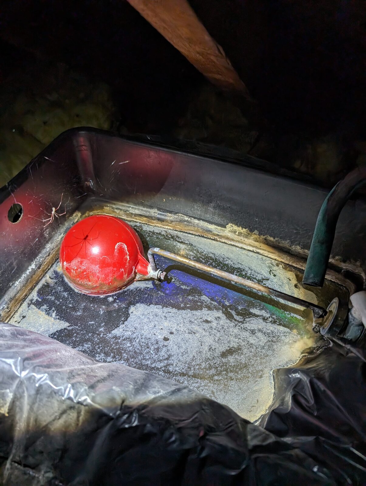

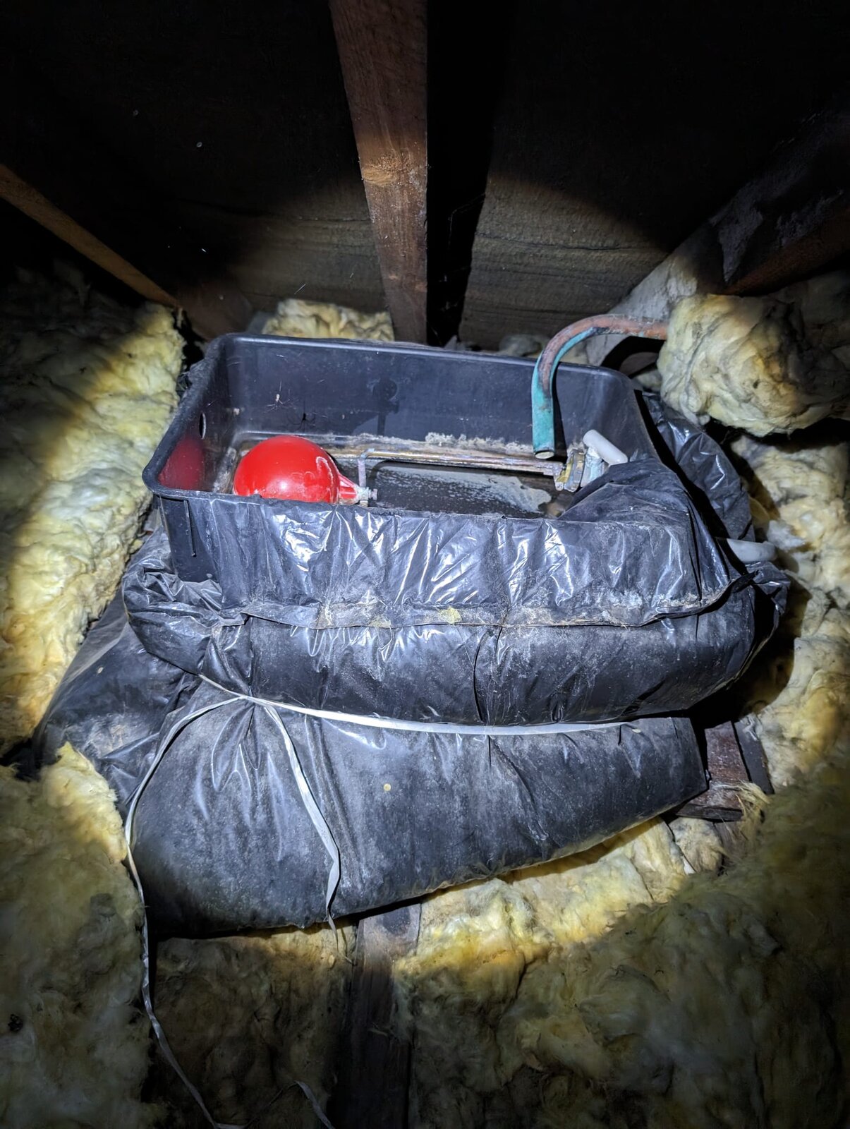

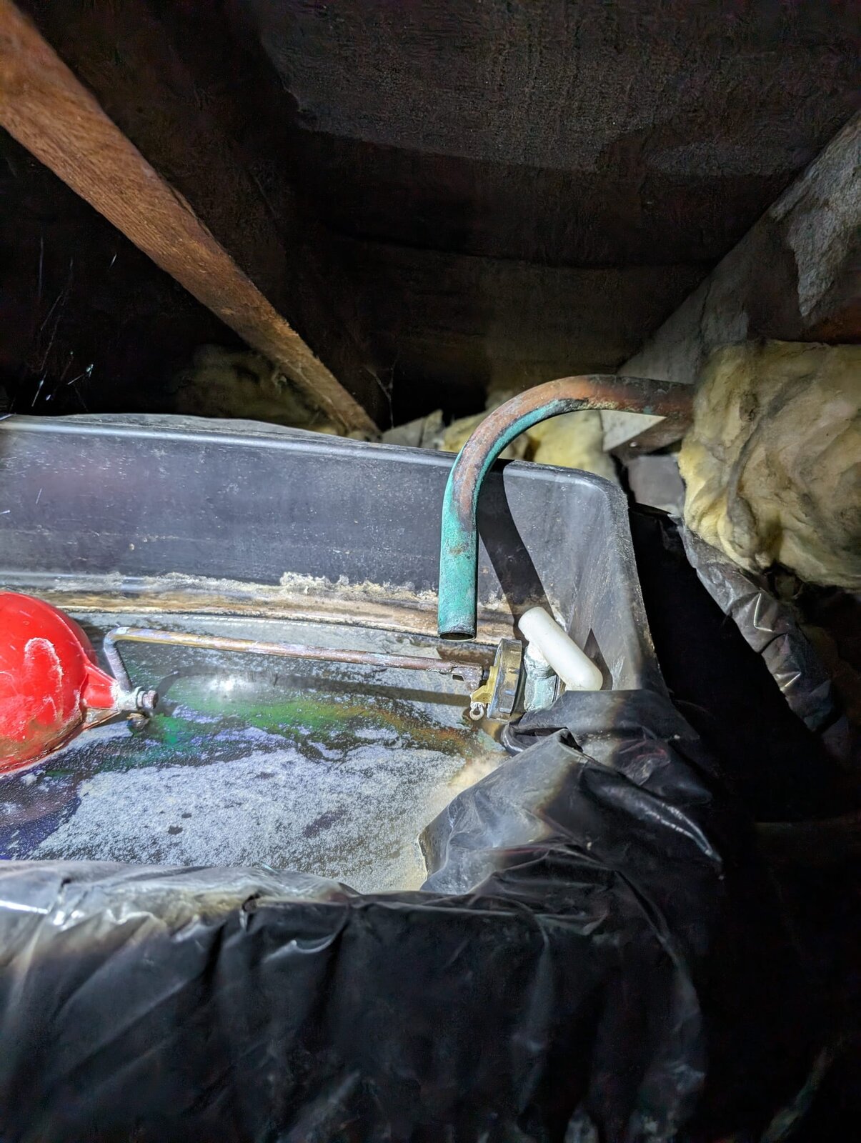

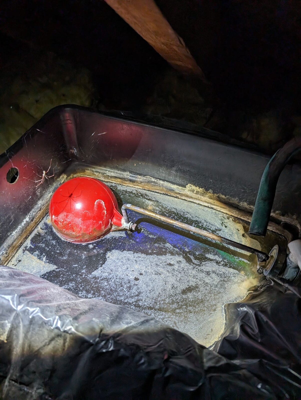

Pictures of cold tank in the loft (disgusting I know)
Can't get pictures inside fortic cylinder ATM But will soon

Both tanks, should have lids on them, in part to keep dirt out, but also to help reduce the moisture evaporating out of them. Before fitting a lid to that loft header tank, it needs a good clean out.
Hmm good point. Do British gas usually do that?
Any heating engineer worth his salt should make sure the system is clean before fitting a new boiler. The header tank is part of that and usually contains plenty of muck. I’d be surprised if the manufacturer would entertain a claim for a fault if it found all that muck in it.
Hmm yeah, thanks. We were pretty naive to it as we had the boiler done pretty much straight away. It's been past the years warranty for the heating system now too so it's only the boiler that is covered.

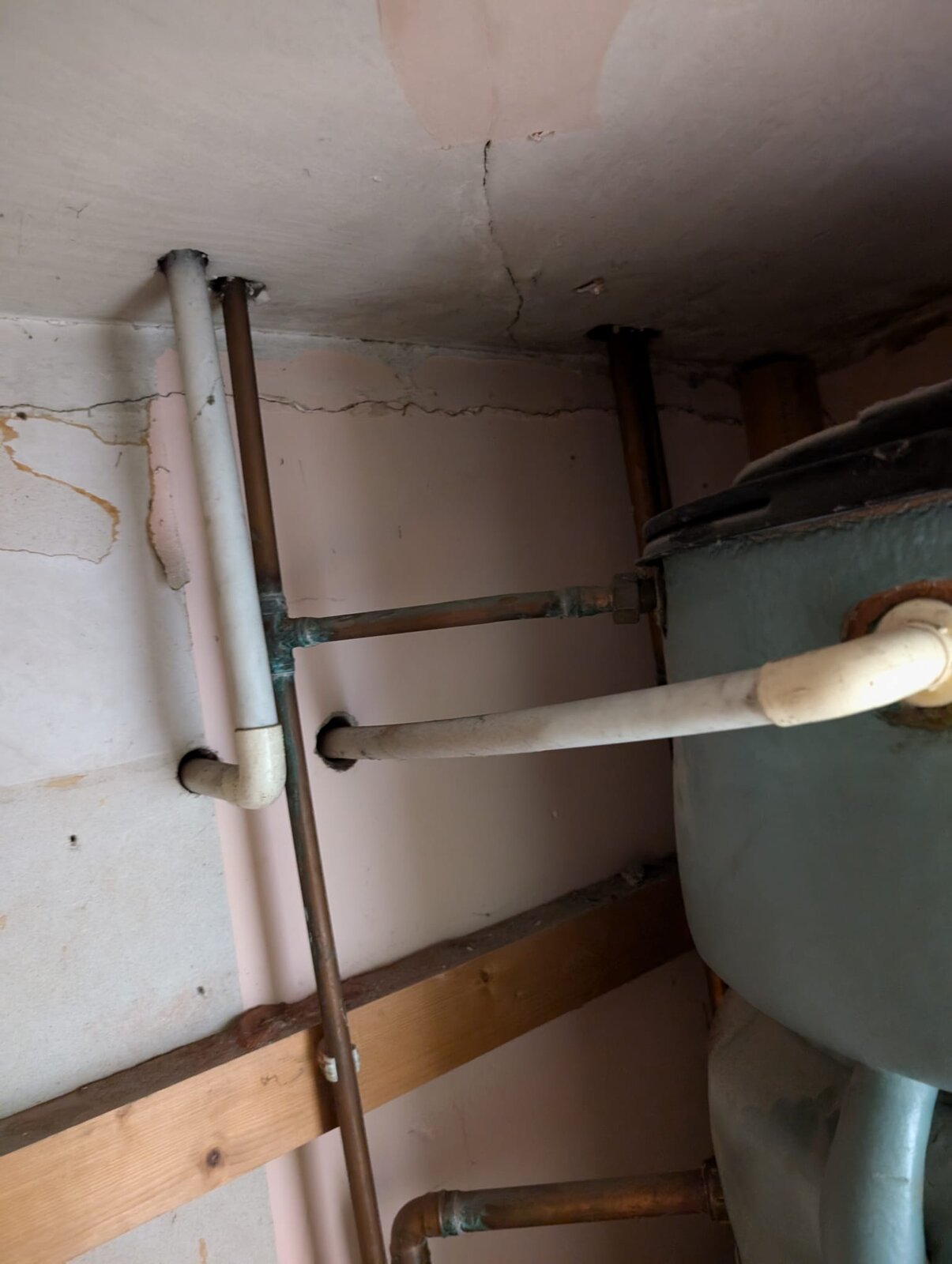

Do the pictures help anyone understand why I'm getting dead bugs out of the hot tap?
Yeah. No lid on the storage tank. There’s no other way they can get into the hot water system.
Yes there is, it’s the cistern in the loft that doesn’t have a lid, which is completely separate from the dhw system
Could be the overflow, which a bylaw 30 kit is there to prevent, as it has a mesh screen for the overflow for the very reason of which you’re suffering
The cold tank in the loft is filthy and lidless, but as I've said in my post we were told this was nothing to do with the hot water as it doesn't feed the hot water.
So that’s an expansion tank, not a cold water storage tank then?
Yep, feed and expansion cistern.
Yes it's a fortic cylinder. I'll get some pics asap, thank you. The cold tank in the loft is filthy and lidless, but as I've said in my post we were told this was nothing to do with the hot water as it doesn't feed the hot water.
As correctly stated above : Black tank is F&E for the water that circulates through the rads, boiler etc.
The water that comes out of the hot taps is stored (cold) in in the top part of the fortic, above the annular indentation 2/3 of the way up.
OP - what's that top bit of the fortic look like inside, underneath the circular lid ?
Can you tie up the ballcock and bale/syphon/wetvac out the contents? How clean, dirty/ full of insects??
