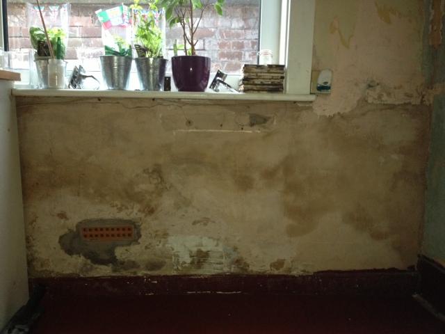

The worst affected wall

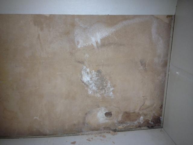

The same wall (from inside the base cupboards)

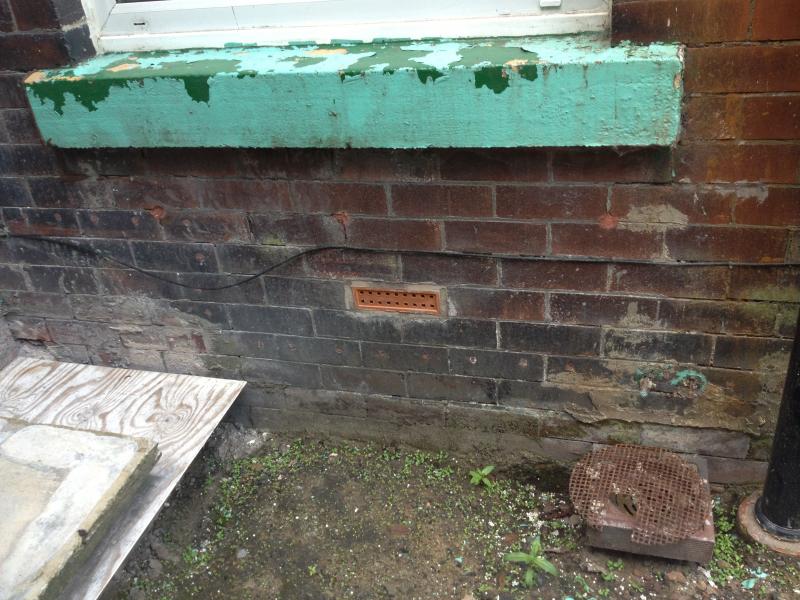

Exterior view of the wall (excuse the paint work- not got round to stripping/cleaning the paint off from the previous owners)

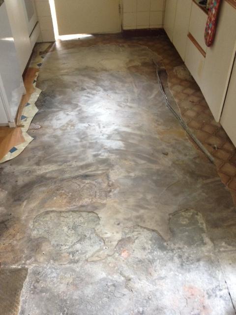

We pulled up the lino and all the other stuff stuck to the floor this morning.

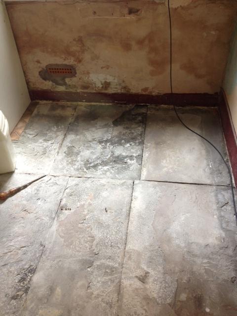

It looks like this so far
The surface of the flag stones look to have been damaged by the moisture so they are very powdery and flaky now.

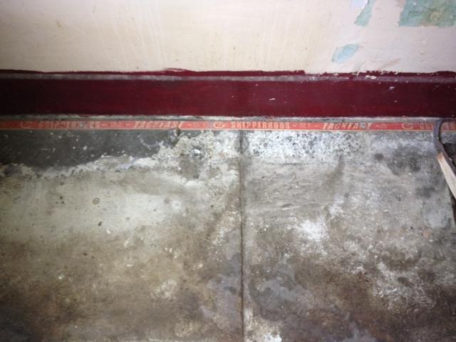

Here's a pick of the rest of the kitchen floor that looks like it has been concreted over
Can the concrete be lifted from the floor without damaging the stone?
Presumably the stone floor has always let in the damp but back in the day it would have been kept at bay by draughts open fires and no lino... is it possible to keep it at bay these days? I am not planning to have any open fires, we've got double glazing but could run a dehumidifier.

1. Knock off plaster to window board height all round, and to the right of the window hack off to window head ht.
( FWIW: the window board appears to be dropping from left to right)
( you also have two kinds of skirting which might indicate previous work.)
2. You have stock brick with thin beds and perps - very difficult to point up.
But stock and thin beds makes it difficult for moisture to enter the wall.
3. The injected DPC is useless at that height, likewise the wild rise on the left - perhaps there was high soil there in the past.
4. Clean off all exterior brickwork - dont allow grime to accumulate.
Is that gulley hopper in use?
5. You will have to lift that floor ( no permanent dehumidifier's or wishful thinking) - once you have eased up the first flag it should be relatively easy to lift the remainder. The SLC(?) and screed will break away.
Its difficult to tell if any part of the floor is a true concrete slab - most probably its a S&C screed. But come back here if you run into difficulties.
6. Turning the flags over might reveal a clean, fresh flag face.
7. Stay away from notions of going over the top of the in place floor - dig down and re-lay on a membrane.
8. The insulated plaster board (above) is a good suggestion - but first, hack off, dig out and see what you've got.

I've been chiseling away some of the concrete on the kitchen floor so I can see where each stone lies but discovered that I only have stone in part of the floor, the rest of it looks to have been replaced unfortunately. I don't know what with (I'm assuming different layers of concrete). The bottom level is coarse and the top level is finer. In one section there appears to be a tar like layer between the coarse layer and the fine layer (and i can chisel the layers apart relatively easily), but in another section there is nothing between the layers and its much harder to chisel them apart.
Is this tar like stuff asphalt? And why hasn't it been used throughout the floor?
Anyway, unless any of you advise otherwise I think I'll get everything dug up and dug down and get a membrane put down. Then i'll need to decide whether to re-lay the stone floor (i'll need to find replacement stone for the missing bits) or concrete everything.
