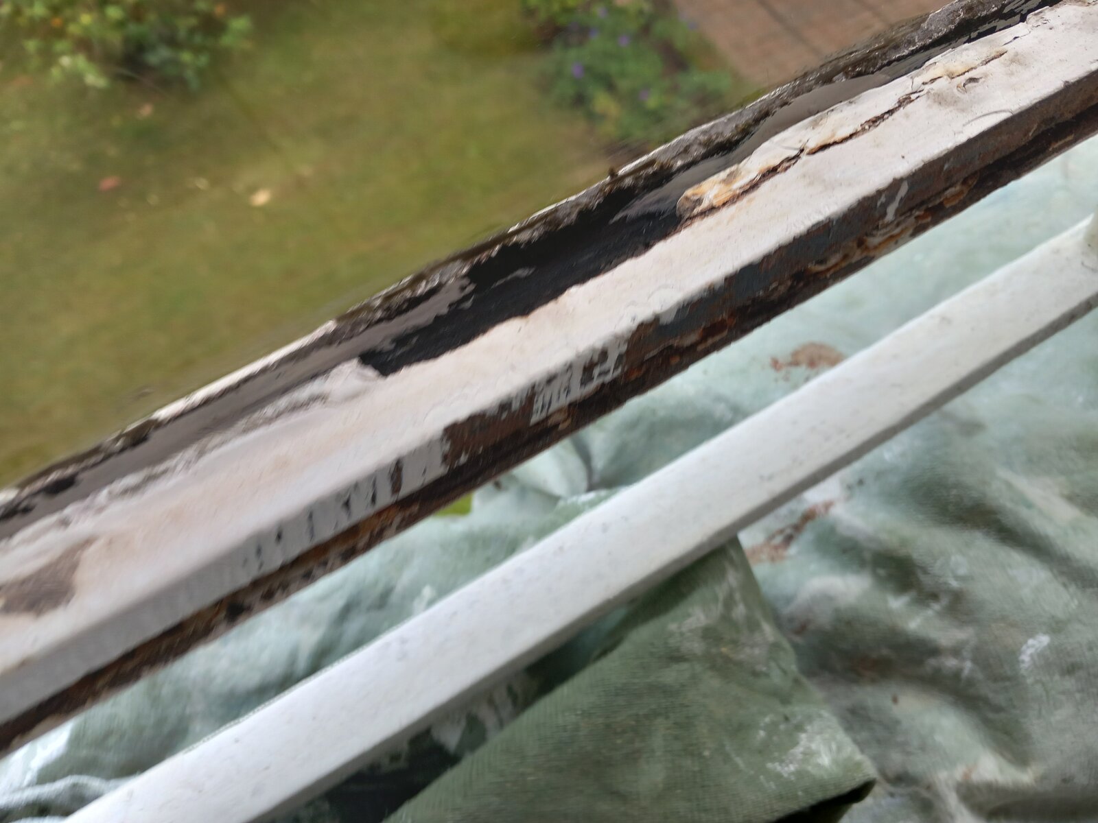

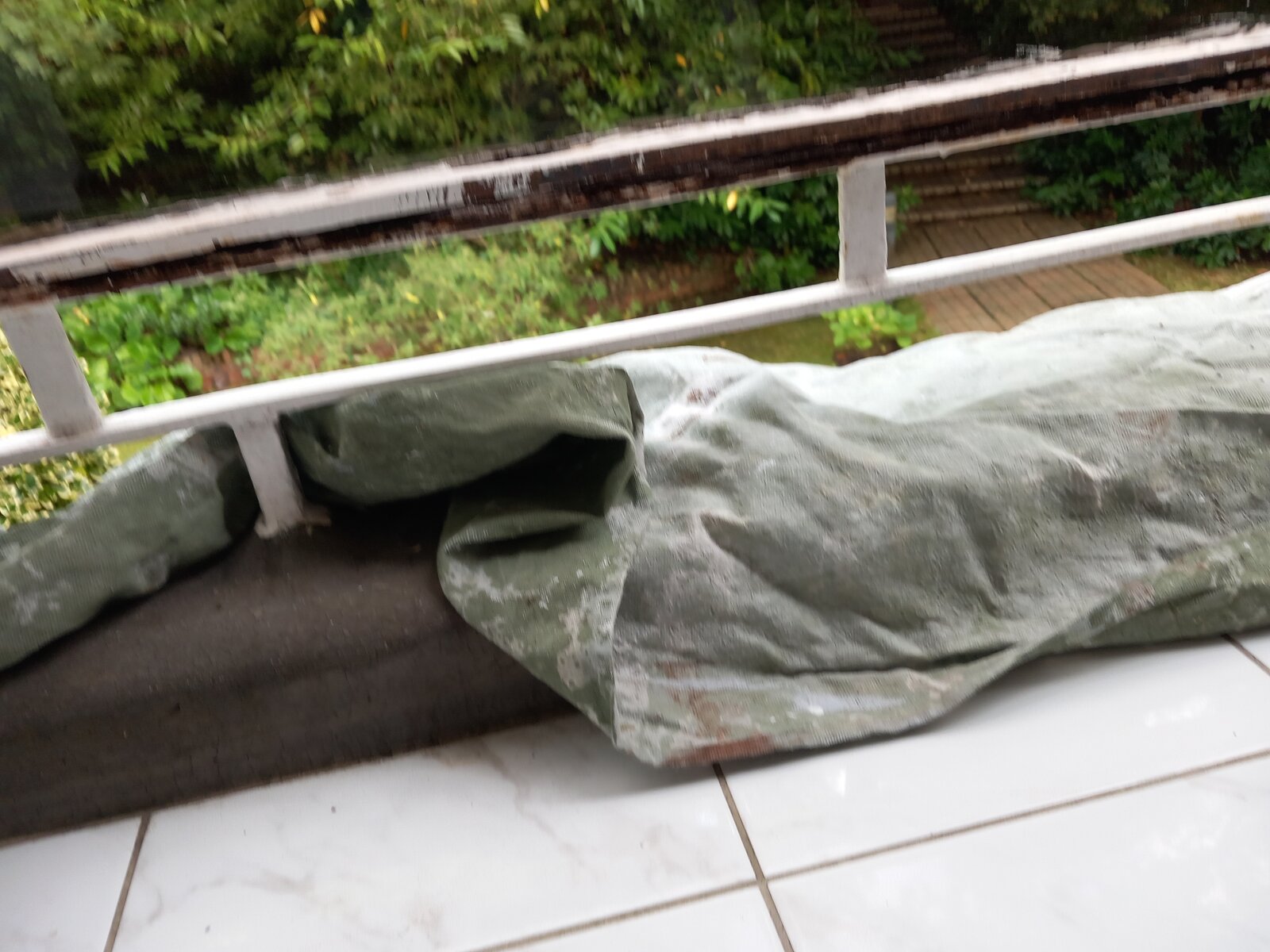

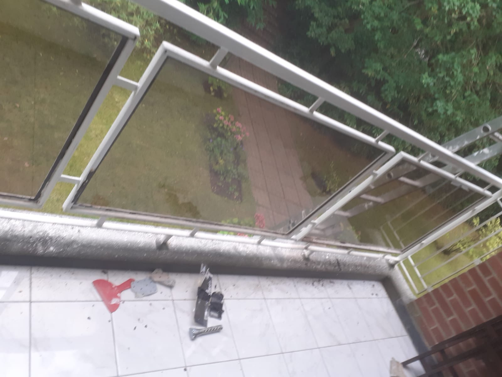

Got a big hole where the rust pushed out, and gaps where rusting metal seems to be separating. How do I prep this? Two part filler?
It looks from here that the steel reinforcing rods have had weather ingress, and have rusted and blown the concrete surround away......is that correct?
John :)
Not sure what u mean by concrete surround?
I'm talking about the concrete plinth at the bottom of the balcony steel work.......water has got in, rusted the rebar which has expanded and blown the cement away. It's a bit difficult to tell from here.
The steel uprights have massive corrosion.....is there some sort of timber infill present, or is it just metal?
None of my business but you should really look at the safety aspects here, I think.......things must be severely weakened in parts.
John :)

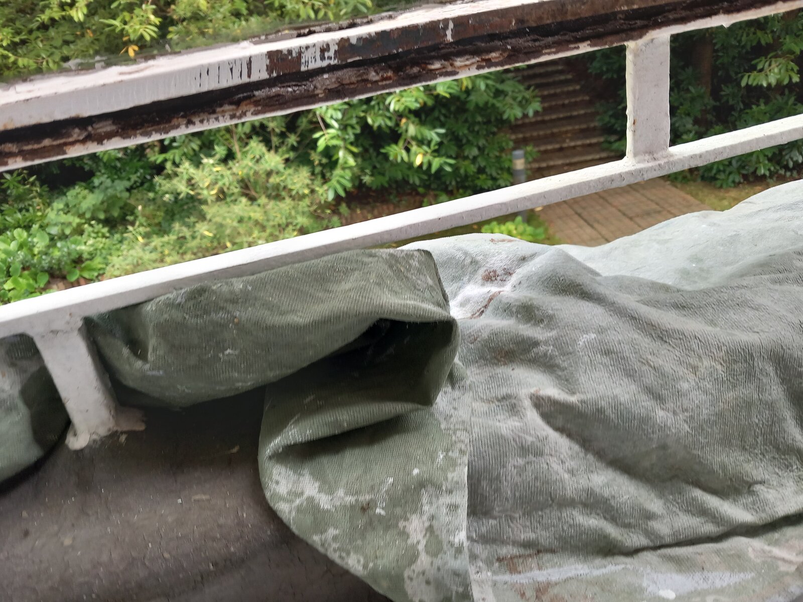

Think just metal. Do you think where the steel goes into the floor it could snap?
I can't say - but wherever steel makes contact with concrete and gets wet, corrosion will be there.
Your first and second picture shows some mighty corrosion and the steel must be weakened. Why it is so evident in that spot is anyone's guess.
John :)
John :)

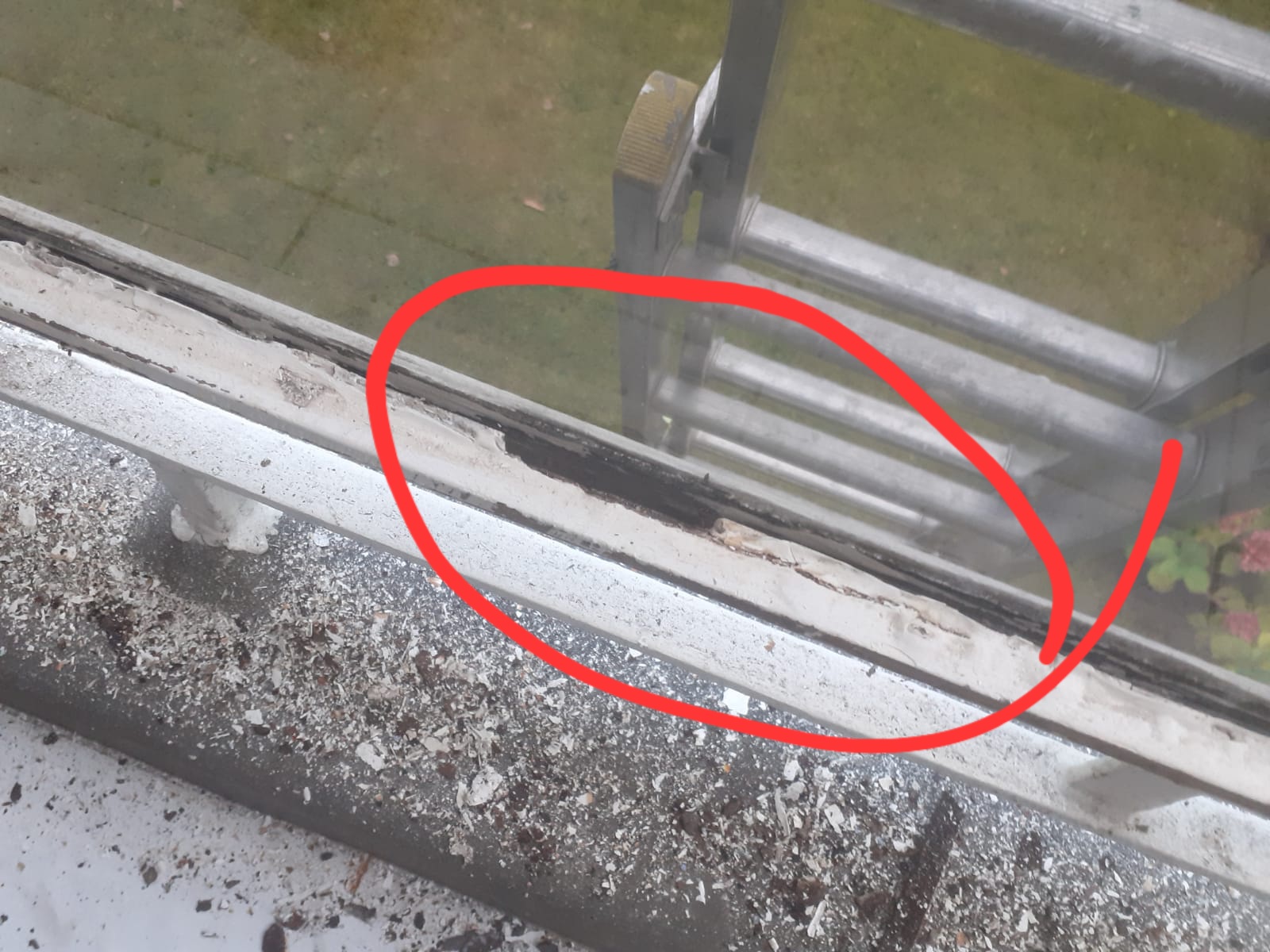

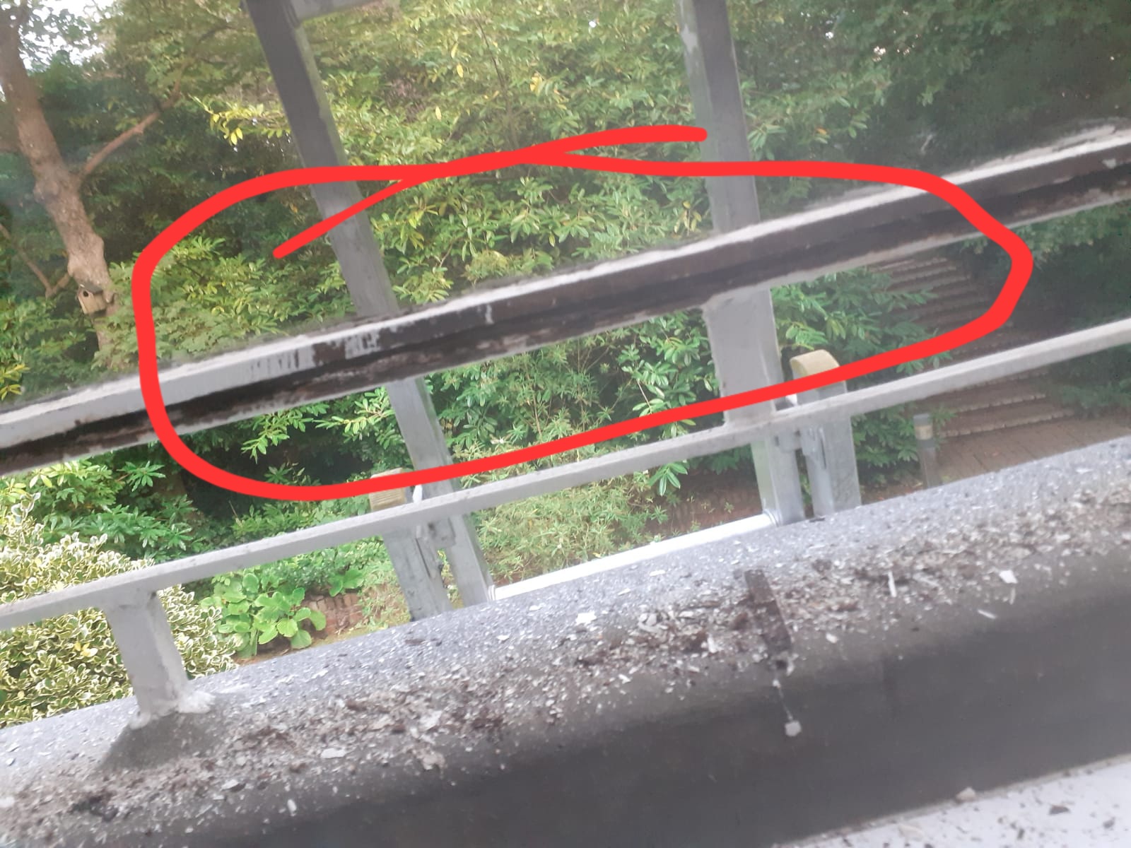

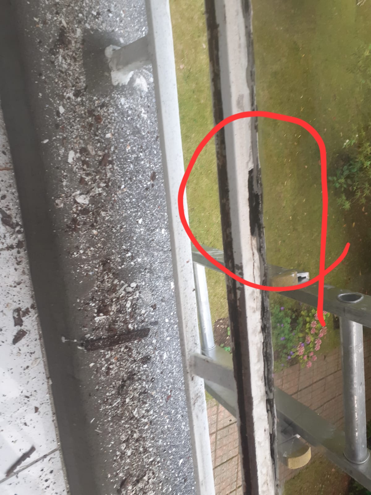

U think two part filler for gaps in first and second picture?

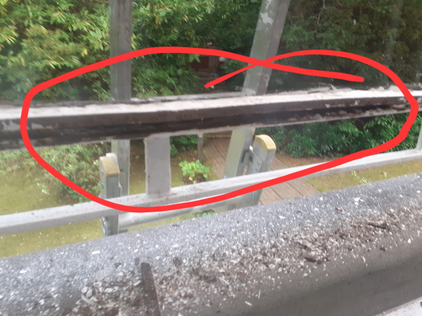

I can't see the corrosion Burnerman mentions but maybe I'm missing something.
What I can see is corrosion between what appears to be a glazing bar that is securing the glass into the angle frame.
I have already said what you should do in post no3 - anything else is just a bodge.
Discuss the options with your customer now and let them decide how they would like to proceed.

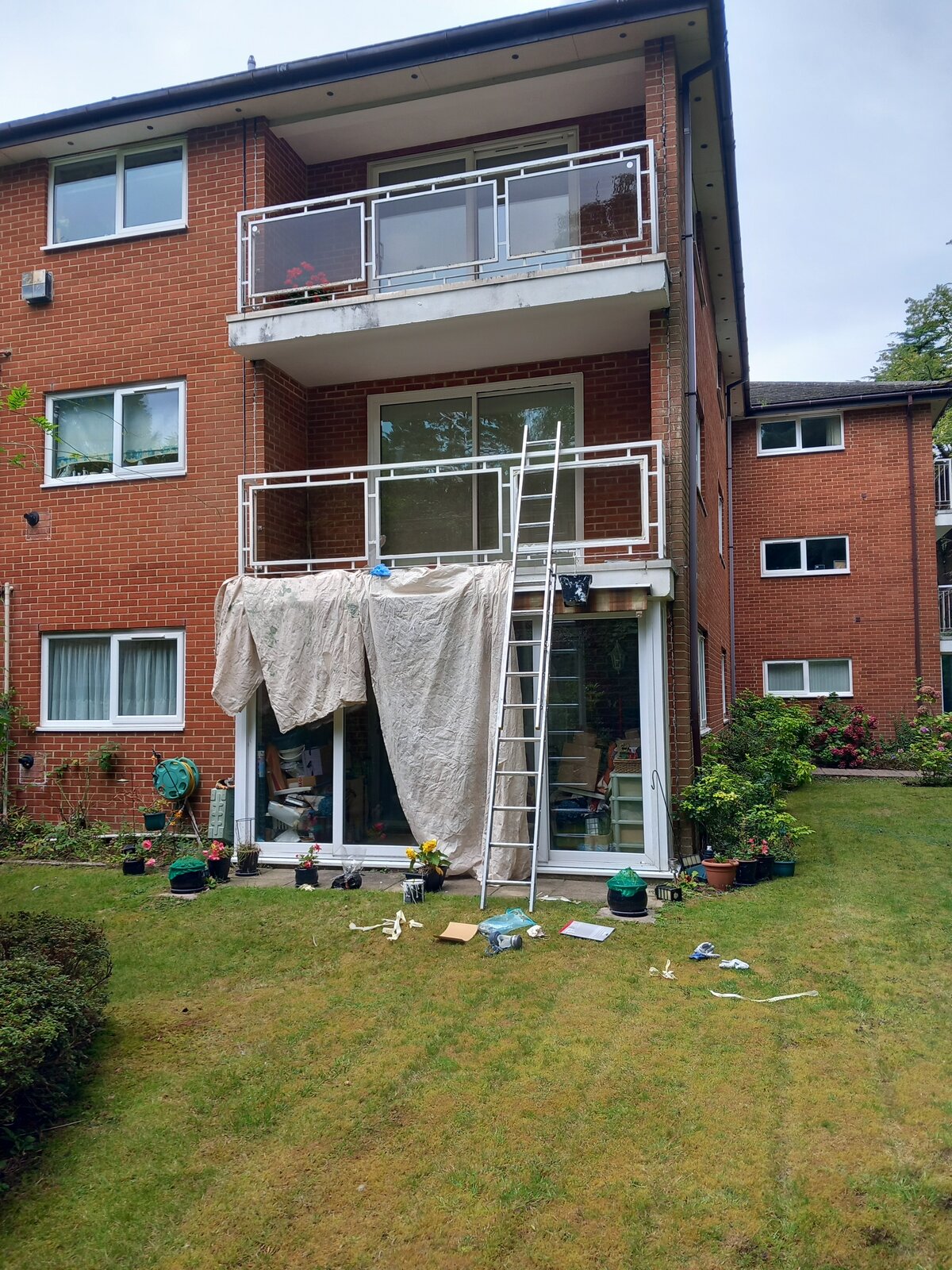

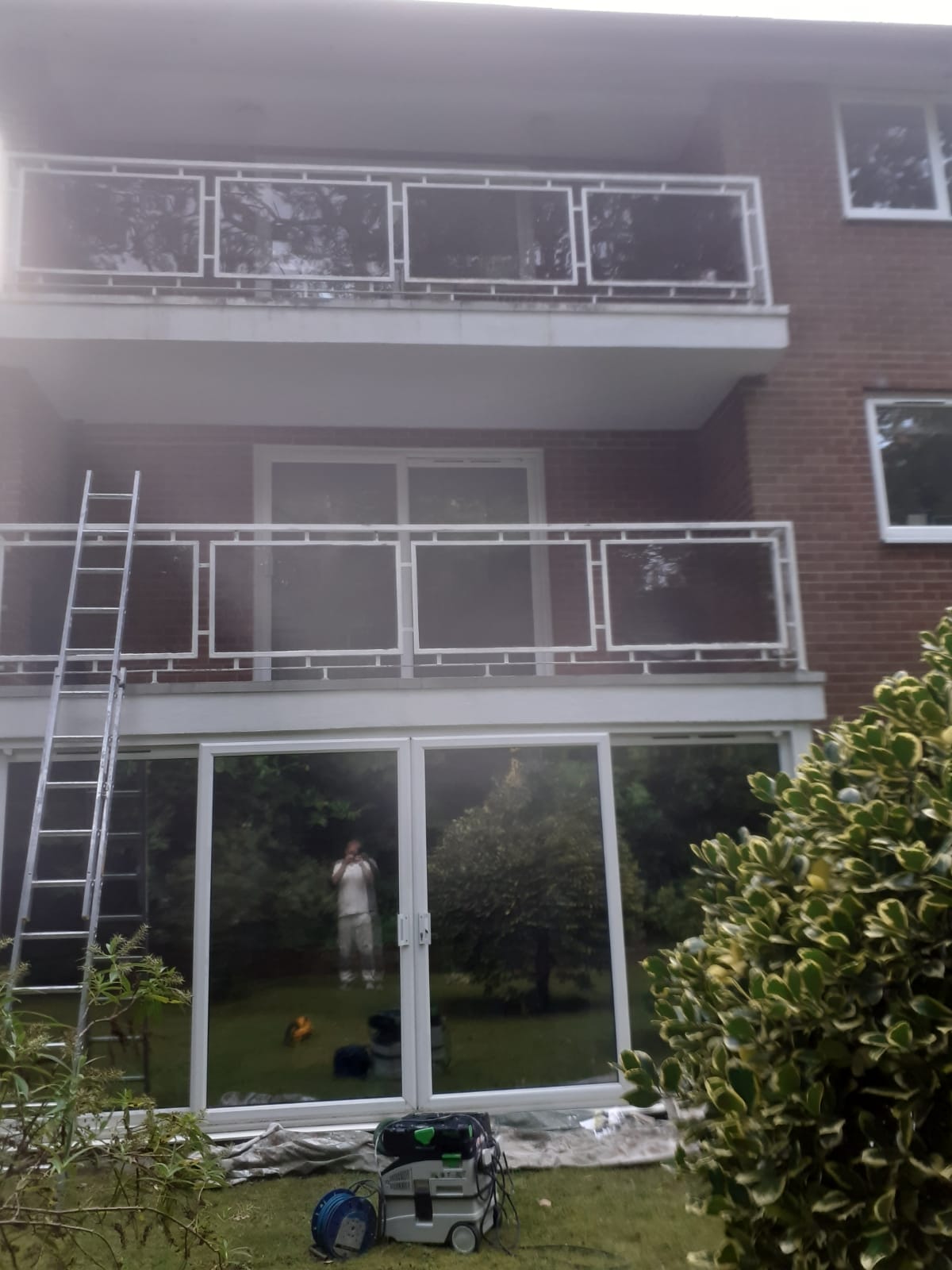

I was painting lower balcony first, better to do top one first or before final coat on lower one to stop all the crap falling down on it?
All glass removed, grit blast the metal back to clean steel, then assess its strength before deciding how to move forward. Any weaknesses will need to be cut out, and good metal welded in. Anything less, and it's a botch job.
