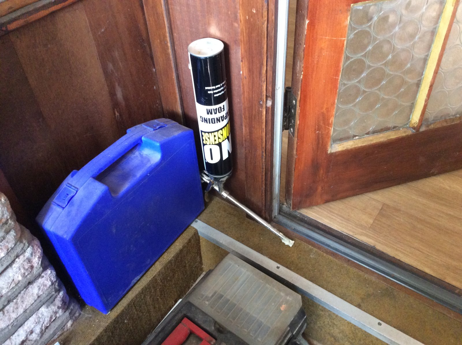

Oh interesting, i always keep the gun uppermost and the can standing up. Maybe that's the issue! How do you keep the can on top as it doesn't really stand up on that side?
I lean it against a wall or vertical surface, I once misplaced it for quite a few months with hardly anything in it and thought that was that but it was still ok as it was stored right.
Good job My OH knows how to put it if she sides things away:)2B95A61C-6024-41B0-A36B-38239F5BFDA1.jpeg

So that the gas is uppermost and rises into the gun.
So standing on the can, with the gun at the top, like the instructions say. (Yes, I just checked)
Not on its side either.
