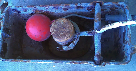

The picture is what I am looking at doing, not my tank but you get the idea.
As you can see, the flush arm is a bugger. A part2 valve with the stopper on the end won't fit into the space, plus the ball valve arm on a part2 would hit the flush arm.
Hard to tell exactly from the picture but have a look at Torbeck side entry and Viva Skylo side entry, one may work? Failing that, try a pegler brass one?

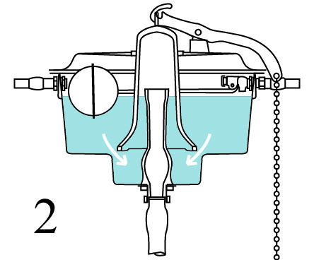

Changing tact a little. If I fit a Vival Skylow and I cant get the water level high enough, has anyone had any experience in cutting the inner pipe to lower the height of the required water?
The cistern is very similar to the one shown but my grips the bell at the side. My thought is, if I cut the pipe at the red line, the water level would not need to be as high - but would I loose the suction of lifting the bell to raise the water?
