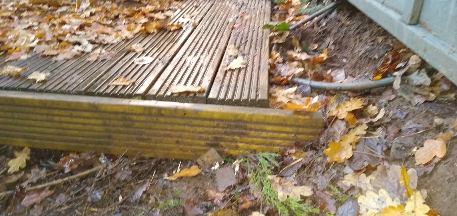

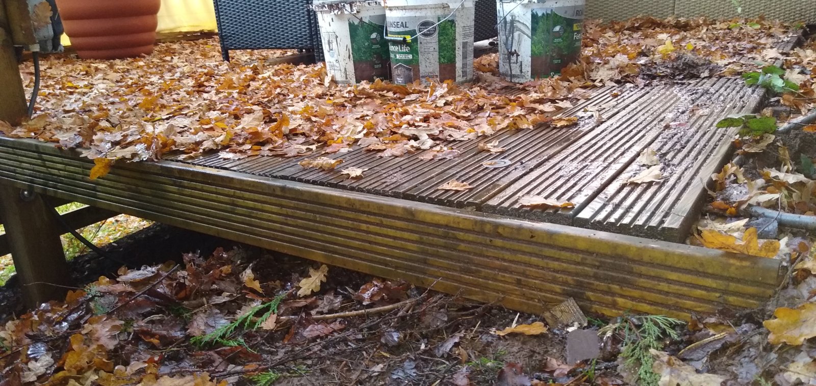

As you can see the decking is almost sitting on the natural ground level
From the planning officers response
I take it he's standing firm so do I send another letter or just go straight to the planning inspectorate?

You don't need to - in fact shouldn't - reply to the LPA; just now sit back because the ball's in their court. They have to decide if it's worth taking enforcement proceedings over the deck, while considering that if they loose their case (on the basis of their incorrect interpretation of the PD rules), there is a possibility of an award of costs against them by the Planning Inspectorate. You have already reminded them of the rules, so an Inspector on appeal could determine that they have acted unreasonably and put you to unnecessary time and expense.
If it gets to the stage of an appeal, you could consider subscribing to the Planning Jungle website; that has hundreds of appeal cases concerning the permitted development rules, and there will almost certainly be similar cases to yours which you could refer to in your submission.
