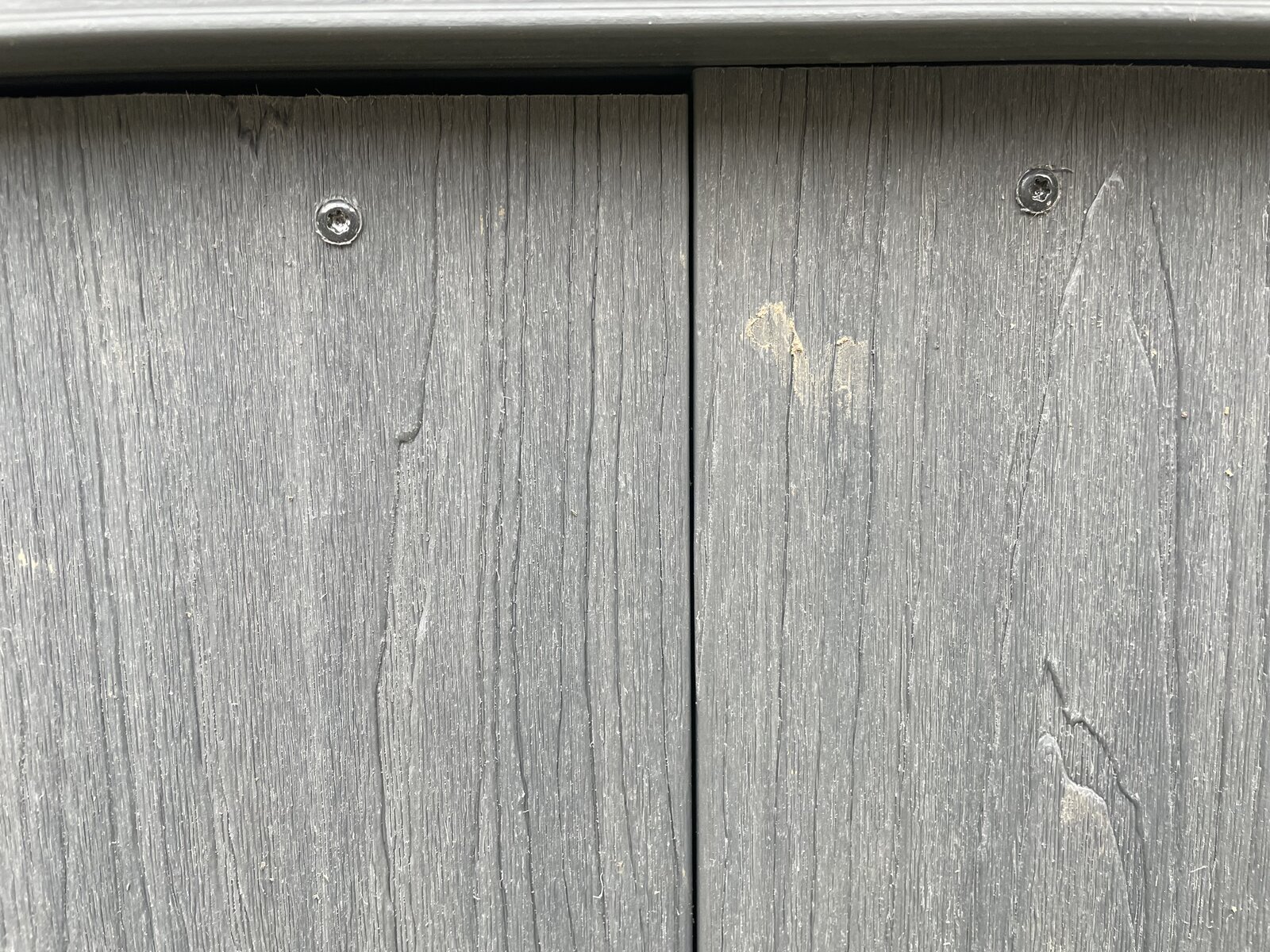

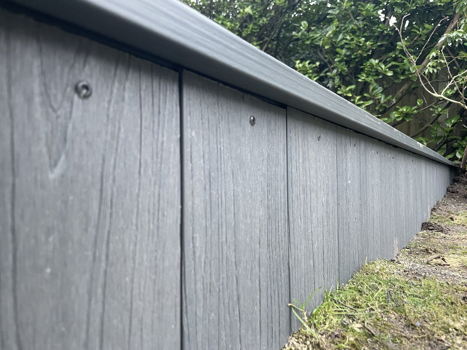

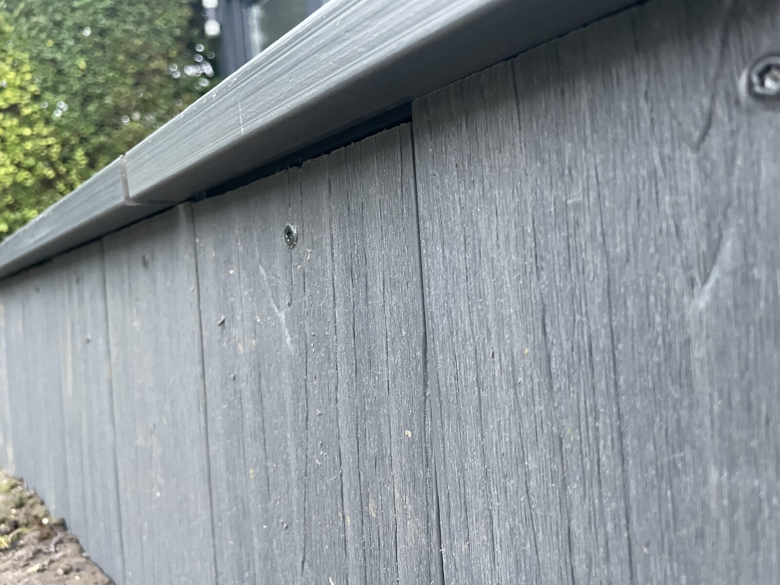

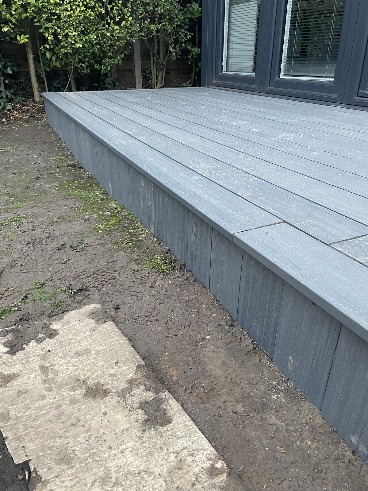

Decking finish opinion. Rough?
17 Jan 2025
Hi all, first post here
Just Had deck done by pro outfit. It’s out of sight as step is lowish, but couldn't help notice finish on these vertical boards under the edge board.
Already paid and only just noticed. Am i being fussy?

my thoughts for what its worth
2 boards each side off the joint [2+2]shoud be tight underneath and have 2 screws to give support to the front edge because assuming 143mm boards the front perhaps 50-65mm will be unsupported
